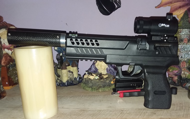

It does have a dovetail so you can mount either a pistol scope or dot sight and the opens aren't that great so something to consider should you decide to take a chance. And yep, the barrel is threaded for 1/2-20 UNF should you want to stick a moderator on it but if you do, you'll have to take it off every time you need to load a fresh CO2 unless you have one slim enough to clear the front CO2 cover. The included wrench also isn't that great and I hauled along an allen wrench the right size to make things easier. The bolt is also supposed to be interchangeable from right to left but I haven't messed with it since it's on the left and being a righty, I can keep the thing in my right hand and cycle the bolt with my left for quicker reloading.
I haven't tested the accuracy side of things with it but here's mine with LDC and a Sun Optics red dot I borrowed from another gun.
Should you buy one? Up to you, just keep an open mind if you do because yes, I fully expect I'll have issues at some point.
