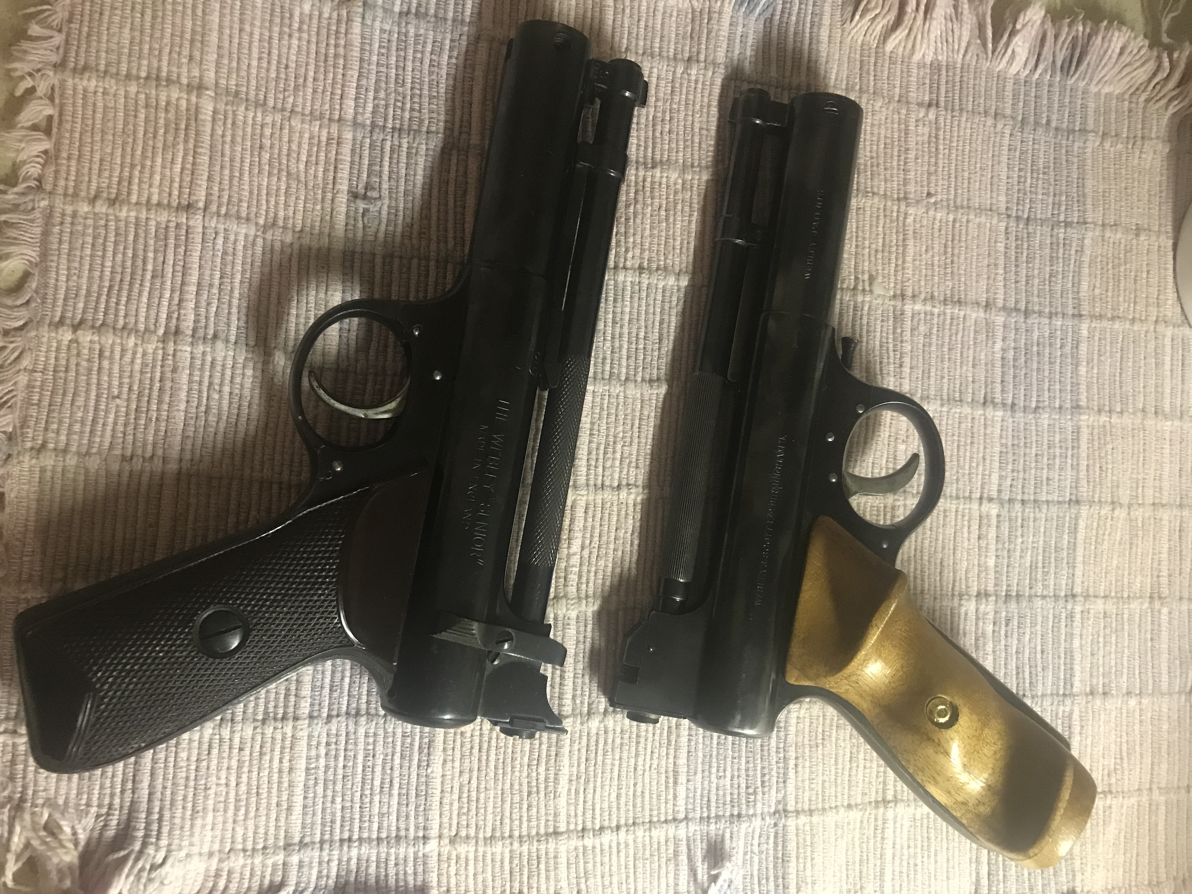

Hello, Recently got a Webley senior and the spring makes a buzzing sound after if fires and think it needs to go in for a service. Does anyone know a good service place for Webley’s. The company I have used before does not service Webley & Scott airguns. I have a mark 1
which I love and is shooting wonderfully and would like to get the senior there also.

Thanks really appreciate the guidance when I have more time will definitely learn to do some repairs myself. Contacted David Slade and sending him the Senior. Already appreciate the build quality of the Senior and I’m sure seeing what makes it go is very impressive and could only imagine what it would cost to make it today.
