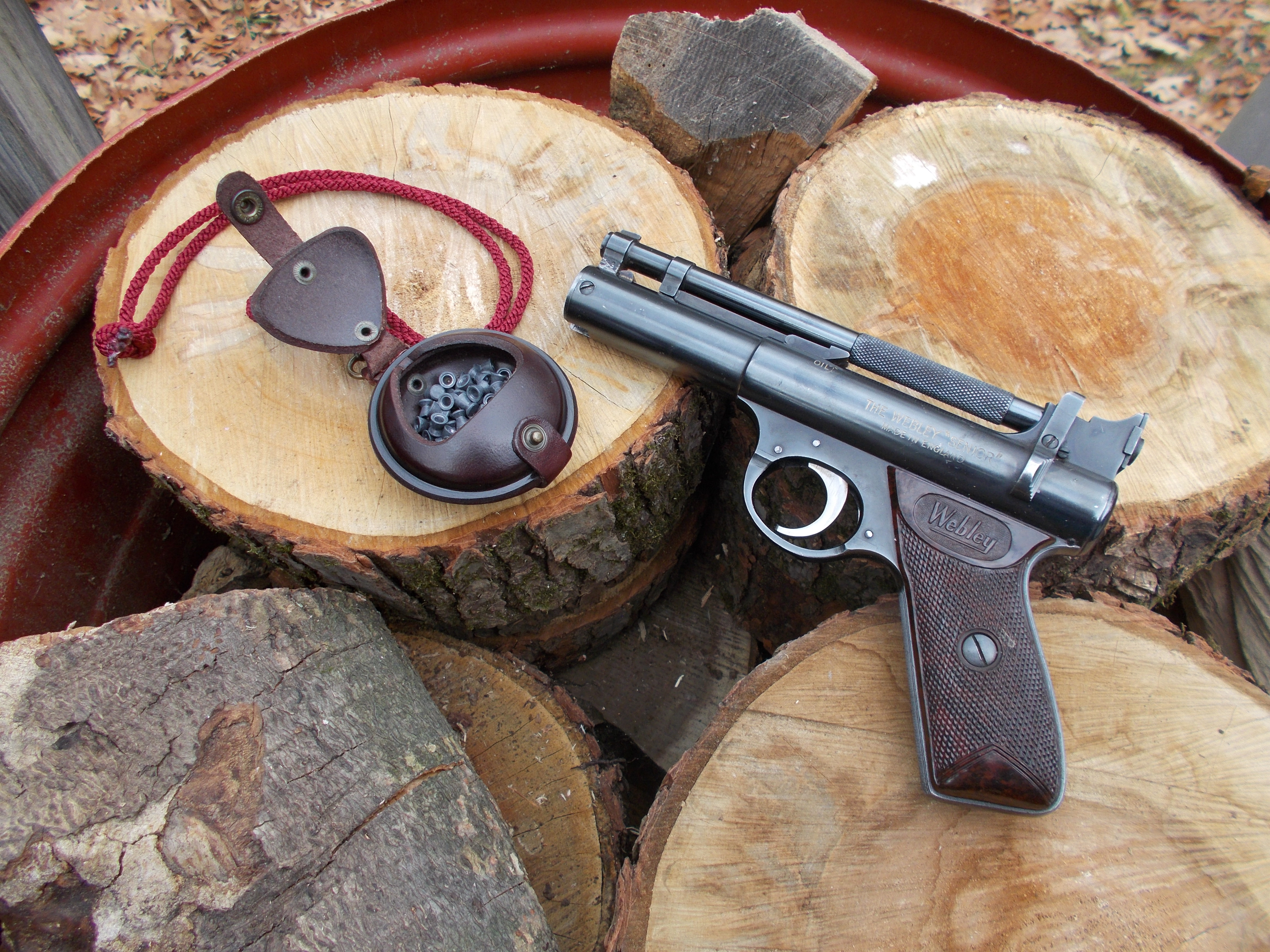

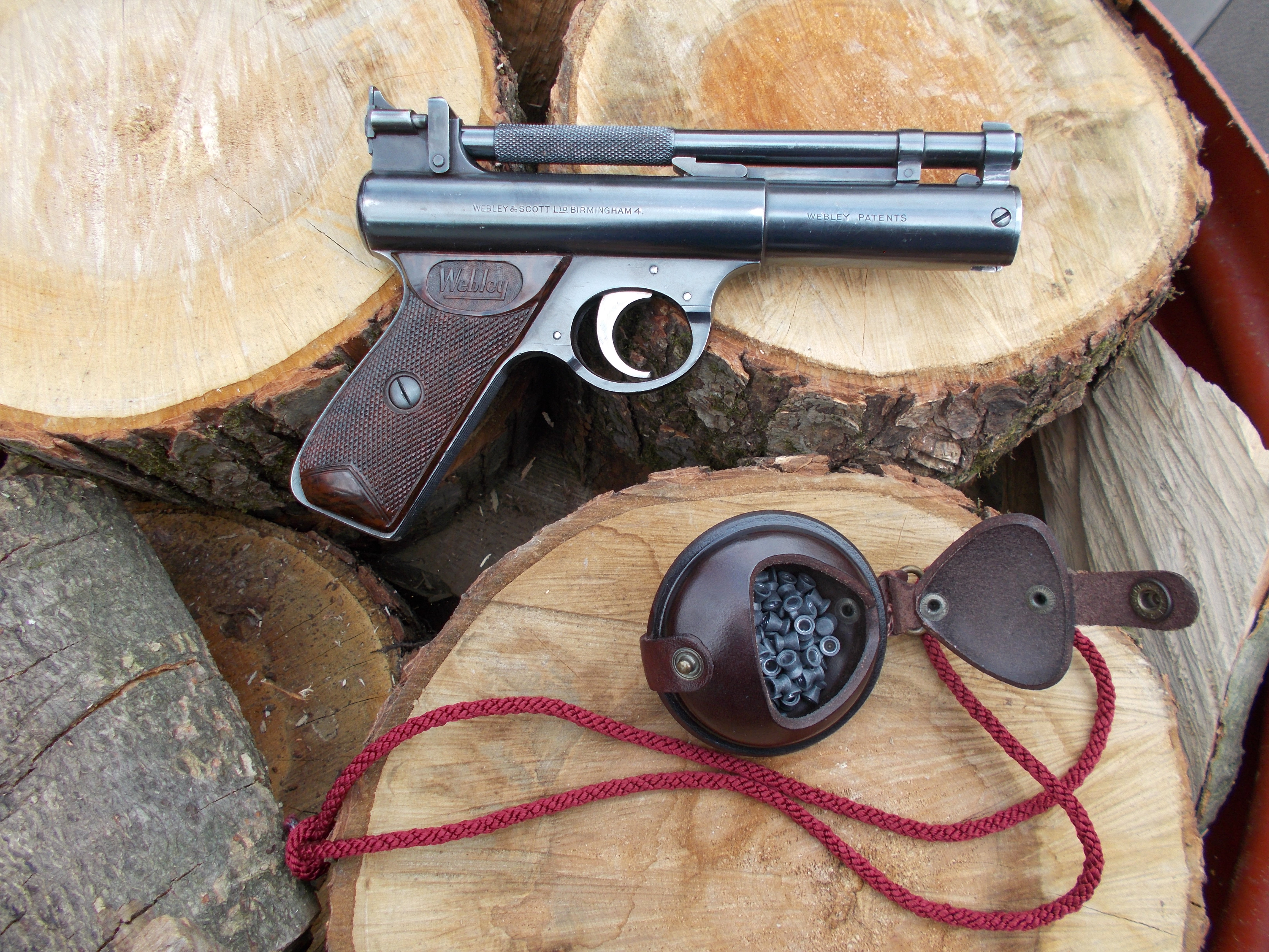

As a follow-up to this thread, I finally got around to addressing replacing the breech seal on the pistol. in all honesty I hate to admit that once I received the part and tore down the gun for a good cleaning did I discover there was no seal in the darn thing... not even a hint of one. When I first received the gun it had very low power which I figured might be because of a broken main spring and perhaps a worn out breech seal. After receiving the replacement parts I opened the action up I discovered the main spring was in excellent condition as well as the piston and its split ring. After donning a jewelers loupe and probing around the breech with a dental pick I was relatively certain all I needed was a new seal. I lubricated the spring and piston and reassembled the gun. Installation of the new seal was the biggest challenge but with a fair amount of determination I got it in. The good news is there isn't a thing wrong with this ole gem... what an excellent little pistol this bad boy is. It's built like a Sherman Tank.
