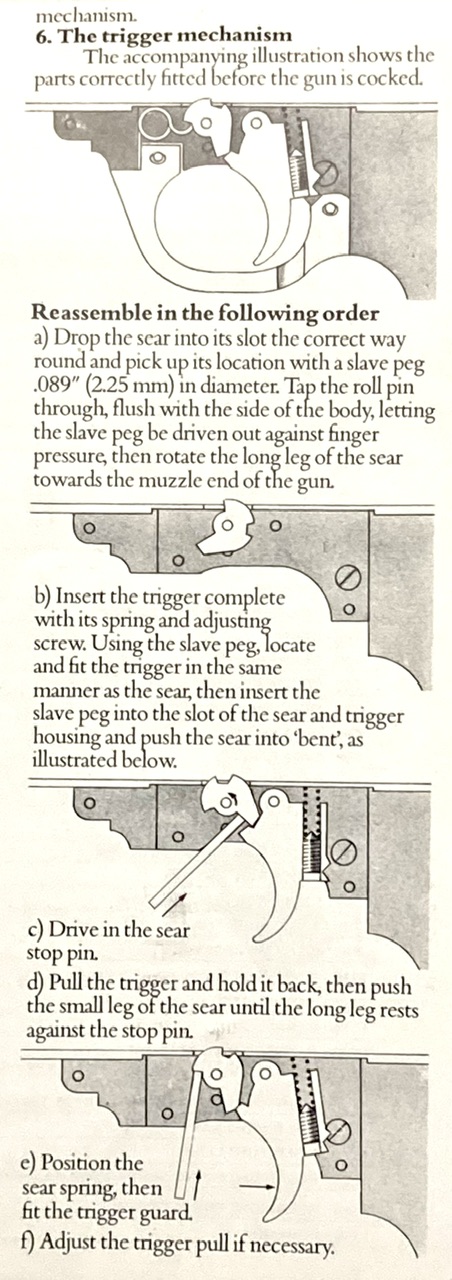

I'm may not be following exactly (how do you "half cock" a Tempest?), but my guess would be the sear and/or its spring has gotten tumbled into some odd position. In the old days, these guns were sold with complete instructions for working on them, including notes on aligning trigger and sear - take a look at the notes and drawings here to see if it helps:

Here's a better copy of the trigger assembly instructions - my link above is pretty fuzzy. As a first step, I'd take the trigger guard off and make sure the sear and its spring are correctly positioned. You likely won't need to take the whole mechanism apart.

Thank you for the diagrams. I will look into this when I get the chance. I will need to find a source to acquire a pin punch, .089 " I believe.
