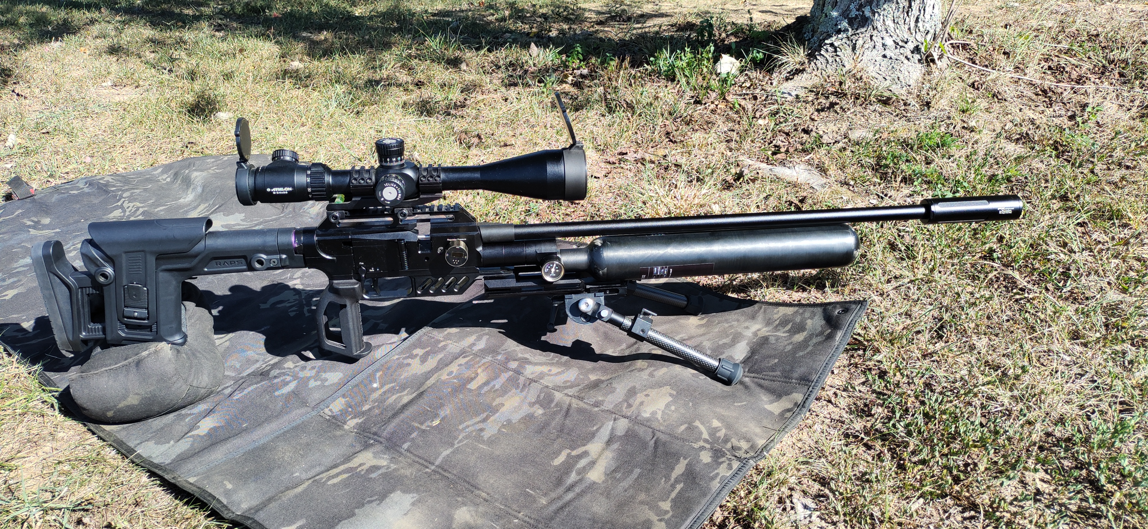

Thanks for your reply.....I just got into the air rifle world, I came from the rimfire benchrest game and the ammo monopoly that goes along with it...lol
I thought the 70% was pretty good also, considering how mass produced these pellets are....I became very anal about accuracy from shooting rimfire and building rimfire rifles for myself and others, I would spend sometimes hours indicating barrels in the lathe before I would thread and chamber them...as I know from experience that if a chamber is not perfectly aligned with the bore of the barrel there's no chance for getting my level of accuracy from it. I just bought a new MK3 a couple weeks ago and I've already did several mods to it...I just started looking at the ammo side of it...I just can't help it as I can't stand shooting a rifle if it's not accurate....I'll continue tinkering with it or I'll get rid of it....:)
