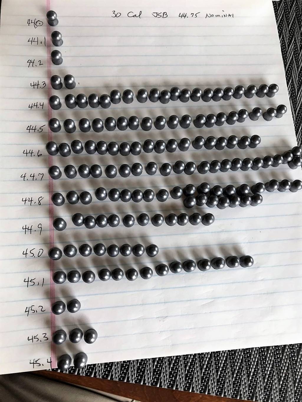

Here's a graphic representation of the weight distribution of a tin of JSB 44.75 gr. pellets.

For matches I weigh and sort/roll. The weighing gets them in groups but the big part is weeding out the peewees and jumbos. Same for the rolling. It is taking the really undersized or oversized pellets out that makes the difference.
