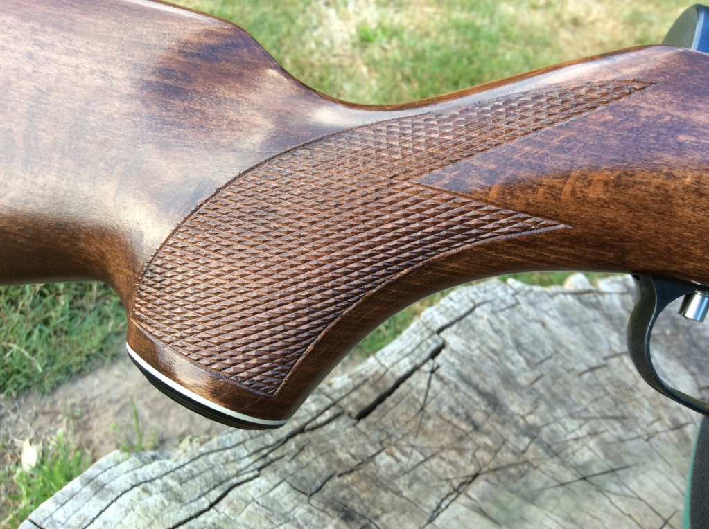

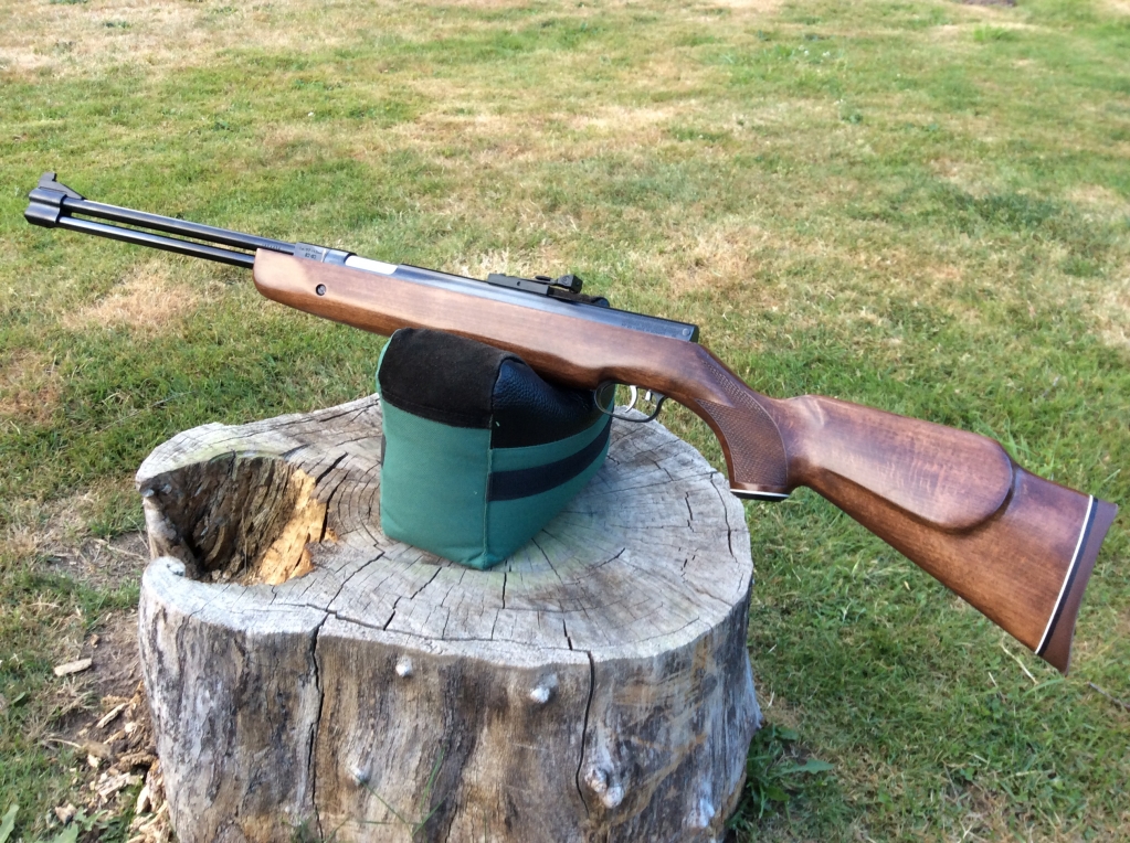

My 77K was a chunky monkey and I thinned and shaped the grip area some to my liking. It also gave me the chance to attempt my first (and only) grip checkering. Even though the shaping was slight, it was enough to make the overall feel of the rifle so much better. Here it is in all its glory.... or not! Ha ha!

greenarrow, that is a nice looking checkering you applied to your re-shaped pistol grip. Did you make your checkering tools or buy them? Very nice work.

"Did you make your checkering tools or buy them? Very nice work."
Thank you!
I purchased a basic set of checkering tools from Dem-Bart. https://www.dembartco.com/index.htm
I think I have the 18 LPI size but I'd have to look at the box to verify that. I will say this about my one experience at checkering...
It's not as hard as many make it out to be but it wasn't as easy as I thought that it would be. It's something that you can't be in a hurry to do. It takes time.
The side pictured is the "prettier" side. Ha ha! The other side isn't terrible but it's not as nice as the one I showed. It is satisfying to do and I wouldn't be afraid to try it again. I now what I would do differently now and I would take my time.

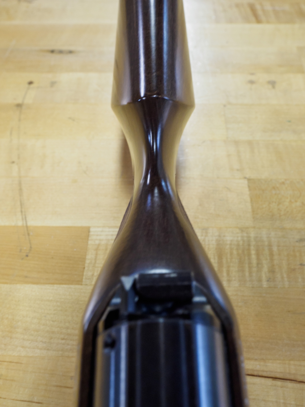

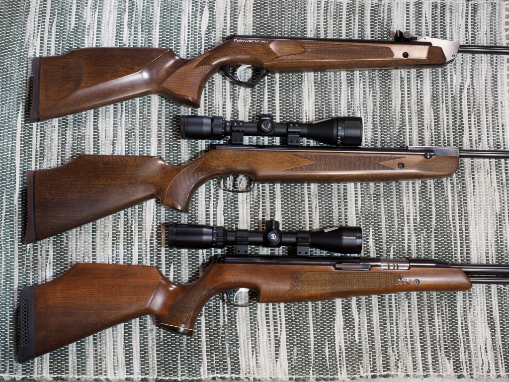

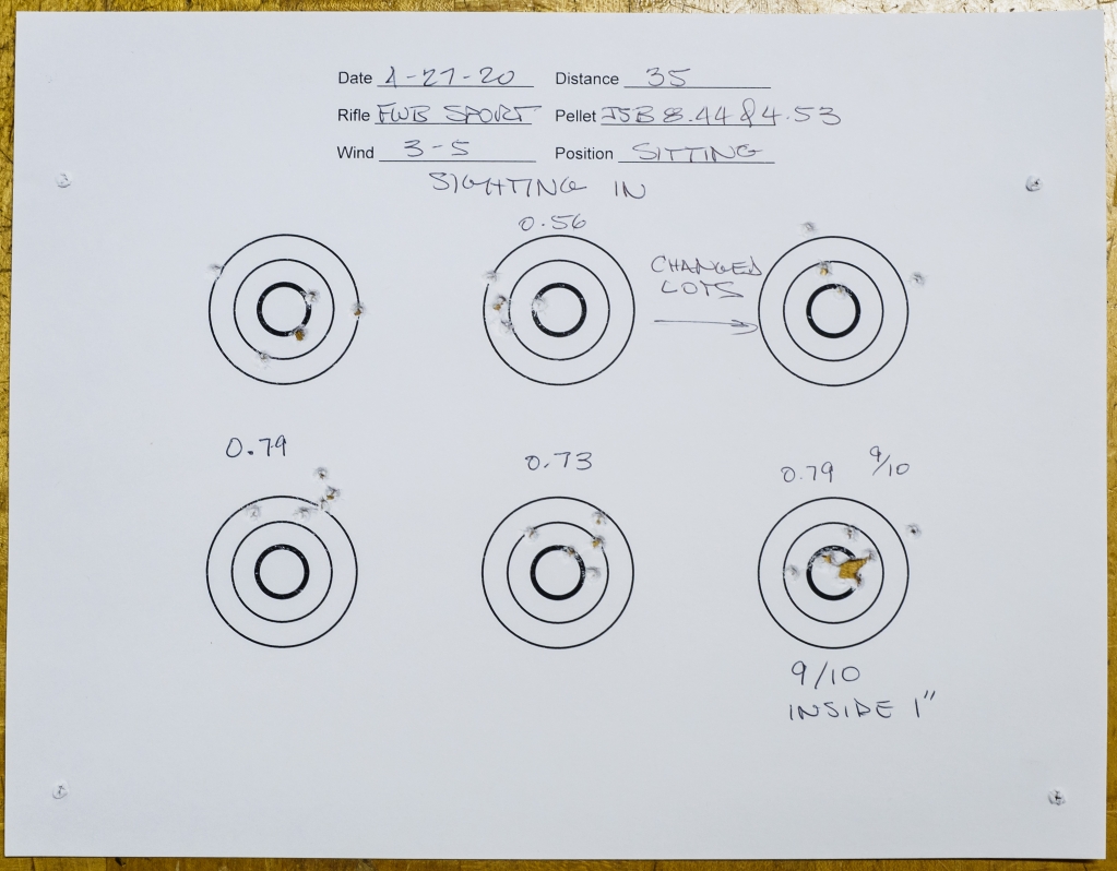

And thrown in for consideration is the FWB Sport. This gun has the trimmest stock I have encountered on an airgun. The wrist is small, the forend very trim, and the comb low enough to work very well with the supplied open sights or a low mounted scope. The trigger is superb, and the gun is quite accurate in spite of its fairly light weight. I might rate it as "most underappreciated". Here are some pictures showing the stock design compared to the R9/HW95 and TX200, the extreme slimness of the wrist, and groups at 35 yards when sighting in for the first time. I actually had to sight in twice due to a lot change beginning with the third bull. Still available at Champion's Choice for $495. Forgot to mention that the safety is able to be set or reset at any time. Which is not the case with most automatic safeties.
