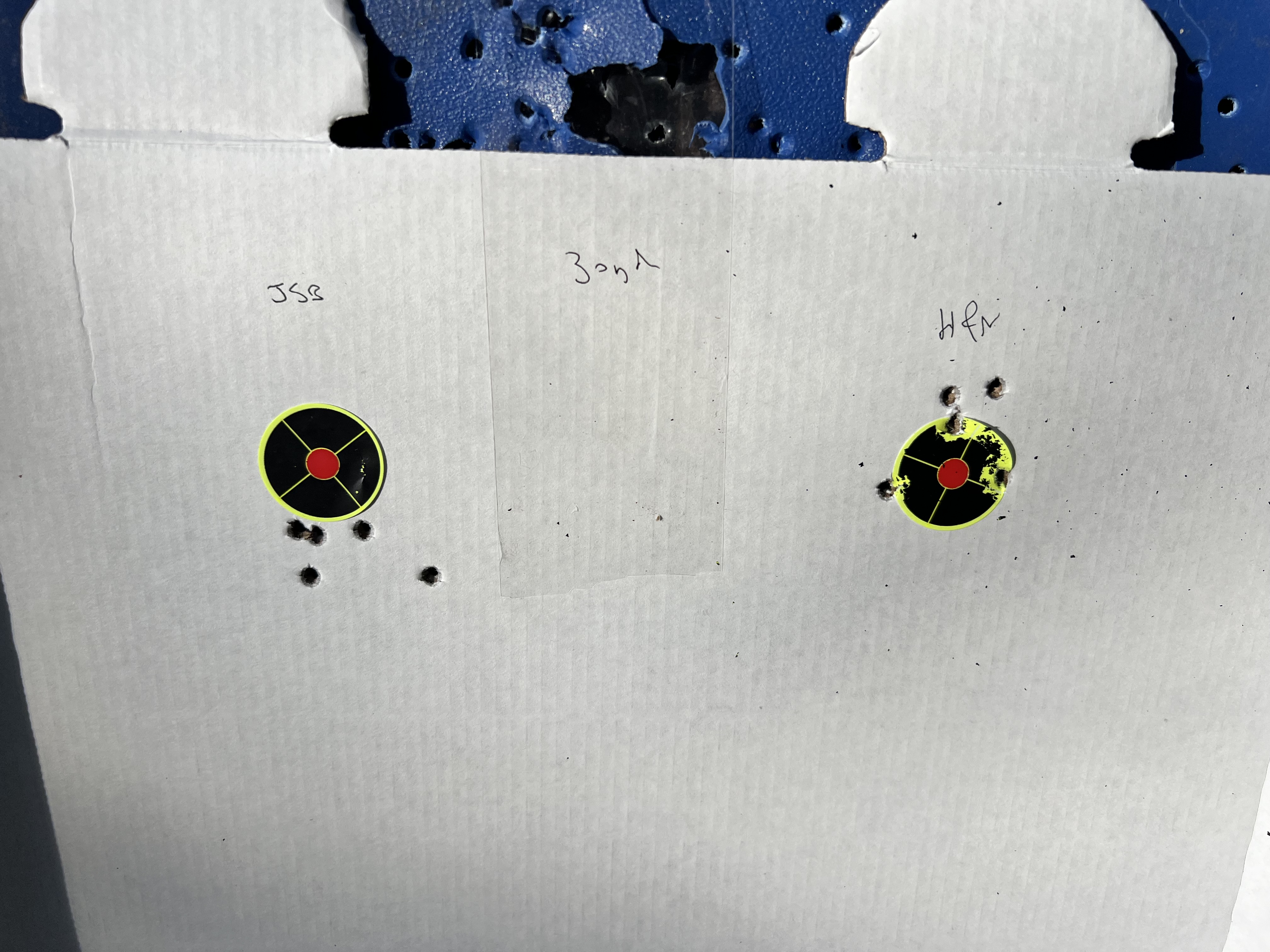

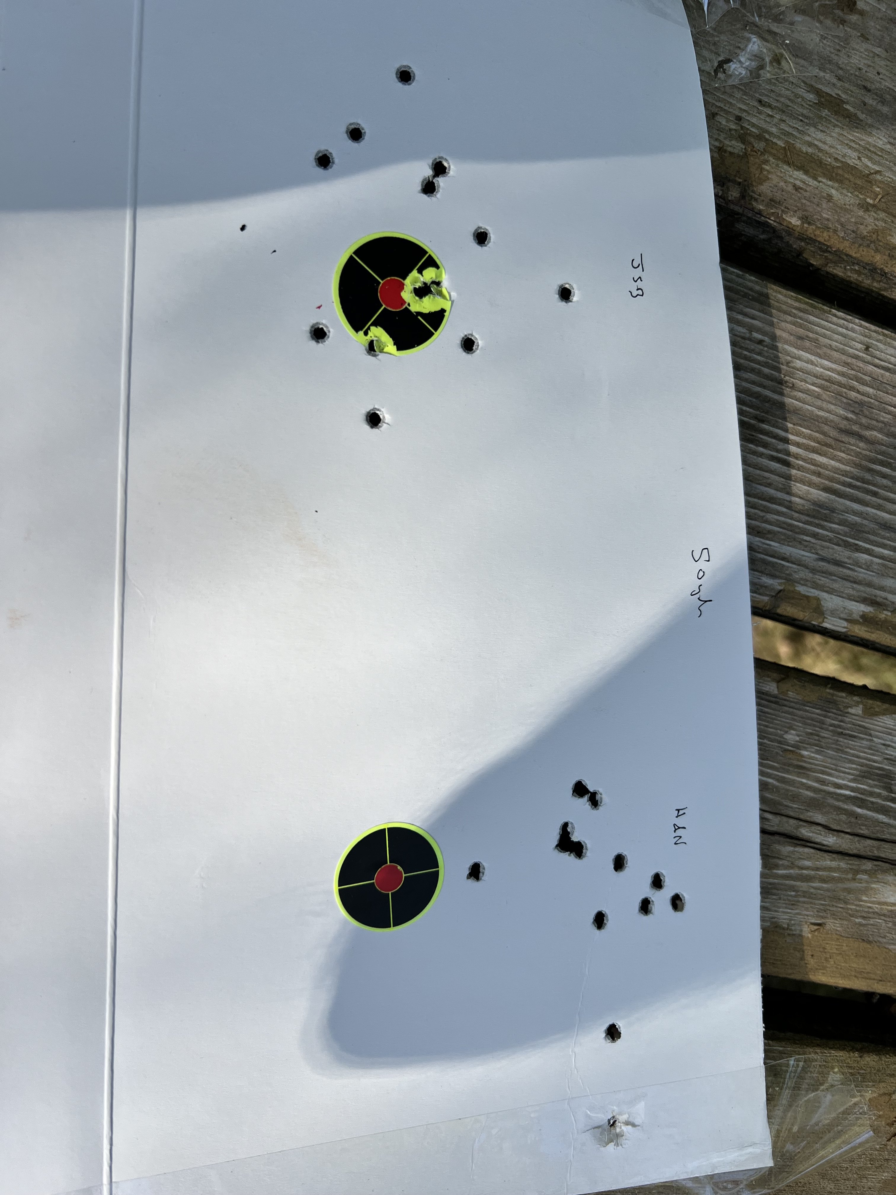

Thanks, novice air gunner here with a HW50s in 177. I’ve been pellet testing before I settle on one. The OP said “I agree that HW leade fit is pretty inconsistent. I notice that more with the 177 rifles. Most people prefer a light press fit into the leade. That fit varies alot with different manufacturers pellets. H&Ns typically fit snugger than JSB in 177 and 22. In my experience looser fitting JSBs make more power than tighter H&Ns in 177. Yet it's been pretty consistently reversed in 22. I have a few thoughts on why but It'd be another lengthy post.”
I have been finding that the JSB exact Match’s 8.4 are loose enough in the breech that I worry they’ll fall out. The H&N FTT 8.4s are tighter and don’t feel like they’ll fall out. Interestingly the heads seem to grab the bore as I push them in whereas the JSB’s heads don’t. There isn’t much difference in my groups, but as the H&N are cheaper I’m leaning towards buying a batch of them. Do you have any thoughts as to the effect of the pellet head seating? These were shot from a seated position field target style. Obviously, I hope to do better. 😉
This second set was seated at a picnic bench.

Ok your situation is exactly what I described with the exact same rifle to boot. The JSBs are more likely to fall out than the H&Ns because the JSBs are typically sized smaller and have softer thinner skirts.
I'm not sure what you mean by pellet head seating. Do you mean deep seating with a tool to a specific depth?
The JSB is the top pellet and the H&N is the lower one. What I mean by the pellet head seating is that when I put a JSB in the breech it seems that the only thing to contact the rifle is the edge of the skirt, and in a very loose way. It’s a different story with the H&N because the head of the pellet touches the breech right away and as I push it in I can feel a slight friction even before I have reached the skirt. I don’t use a pellet seating tool, it’s this pellet-head-friction that I was trying to describe. In the photo of the two pellets, you can see that the edge of the pellet head of the H&N has a slightly thicker rim.
Another observation is that I zeroed the rifle at 25 yards on JSBs and the H&N are hitting higher on the paper. They weigh the same according to the tin, and so I wonder if the slightly tighter initial fit of the H&N is allowing more air to stay behind the pellet.

OK. Thanks for explaining. In every 177 Weihrauch I've owned or worked on (and that's a bunch) the JSBs fit looser than the FTTs as you described. Your different point of impact at a single distance isn't necessarily an indication of velocity or efficiency. My experience is JSBs 8.44s are always significantly faster than 8.64 FTTs in Weihrauchs. The FTTs are slightly heavier at 8.64.
Their higher impact could be from harmonics and or barrel flip. The barrel can flip higher before the slower pellet leaves the barrel. My 177 Hw50 pushes JSB 8.44 pellets ~795fps and FTT 8.64 around 755fps. That's 11.84 fpe to 10.93 fpe respectively. The higher energy indicates higher efficiency. The JSBs and the FTTs fit my rifle exactly like yours. This difference in energy between these two pellets is similar in all my 177 Weihrauchs. Your not losing any sealing with them even though they on the looser side.
Now efficiency has nearly zero bearing on accuracy. Accuracy is more important than energy if you're considering any type of competition. Now I use JSB 8.44 and rebranded ones in my Hw50 because I plink out to fairly long ranges (100yds) and shoot critters so the extra velocity and energy help. The 8.44s accuracy is generally excellent and often matches the FTTs. The accuracy and sizing of FTTs is much more consistent from tin to tin. JSBs will vary more lot to lot. The best way to hedge that bet is to buy the AA and FX rebrands or the 4.53 head sizing. Those are tinned from a single die. This can be expensive but you'll get a little more consistency.
Honestly, if energy isn't an issue and the FTTs print well the FTTs are probably the safest bet. You'll get more consistency and won't have to worry about the pellets falling out while closing the gun. I buy FTTs 20 tins at a time in both 4.51 and 4.52 sizes. Some rifles will prefer one a little over the other. Either still shoot well in all my 177 Weihrauchs. Most of my rifles have printed their best single groups with JSBs but over the years the average FTT group is better because of production consistency.
That's my experience and you'll have to do your own testing to see what prints best in your gun. I think 4.52 FTTs is a pretty safe bet.
