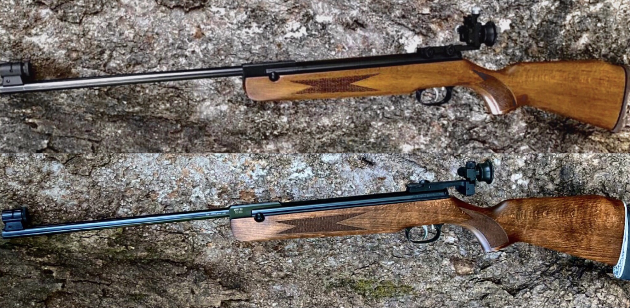

The factory finish is a amber lacquer. It won’t darken over the finish. If you want it darker the clear coat needs to be removed. Beechwood is difficult to work with so be sure you want to go down this rabbit hole. The stock as is needs no care like finish oils. An occasional coat of wax is fine but not really necessary. If you decide to refinish the stock there is help here to be had. This is a before and after I recently did. And the old stock color was better than the newest Weihrauch stocks. I would have to do it but it is a pain. The original finish was quite orange in color and the shiny clear coat was sprayed over the checkering. Looked like a Wally World special. Weihrauch needs to get back to there roots and make beautiful stocks again. IMHO.

The factory finish is a amber lacquer. It won’t darken over the finish. If you want it darker the clear coat needs to be removed. Beechwood is difficult to work with so be sure you want to go down this rabbit hole. The stock as is needs no care like finish oils. An occasional coat of wax is fine but not really necessary. If you decide to refinish the stock there is help here to be had. This is a before and after I recently did. And the old stock color was better than the newest Weihrauch stocks. I would have to do it but it is a pain. The original finish was quite orange in color and the shiny clear coat was sprayed over the checkering. Looked like a Wally World special. Weihrauch needs to get back to there roots and make beautiful stocks again. IMHO.View attachment 341221
