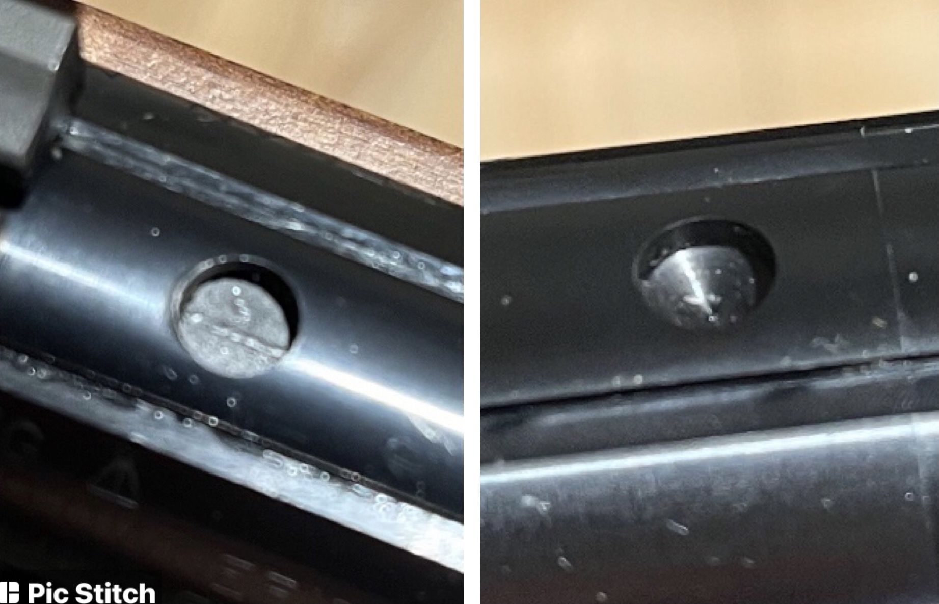

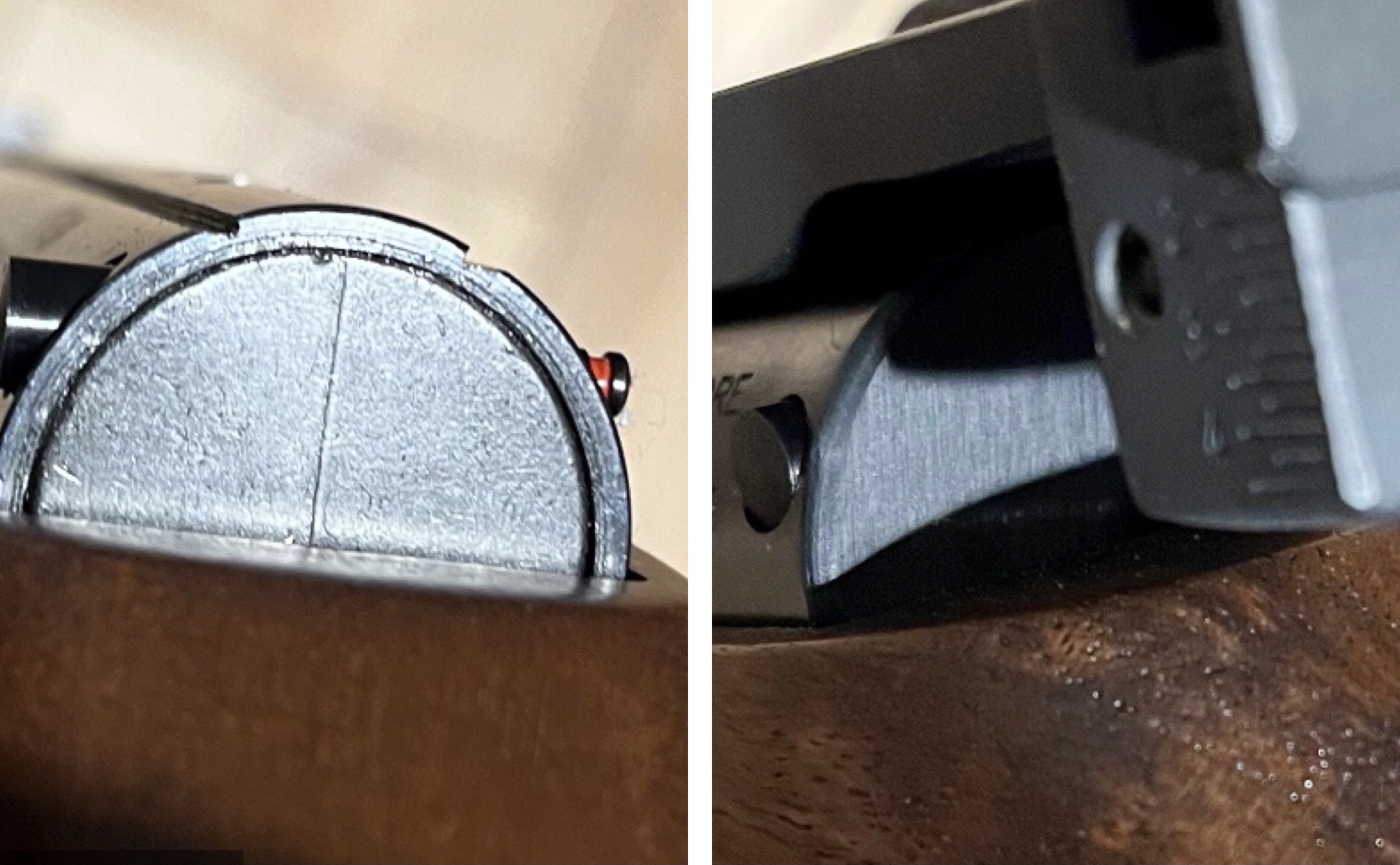

The receiver cap on the “better build” is a massive blued solid steel cap that is threaded directly into the receiver. It is actually threaded first into the receiver at an early stage of production then finished with the dovetail and blued with the entire receiver. This cap is made to this exact receiver and cannot be interchanged with another. It is custom made for that specific receiver only. If you look closely at the picture you can just barely see the seam joining the cap to receiver. The seam is just in front of the scope stop hole. Also the blunt end of the cap is solid steel. This massive cap allows the trigger to be installed directly into the receiver for a steady lockup and gives deeper scope or diopter holes in the cap.
The receiver cap on the “lesser build quality” is an internal die cast metal insert, interchangeable and certainly less expensive to manufacture. If you look closely, you can see the castings lines in the end cap at the blunt end and in the bottom of the scope stop holes. It is by no means an inadequate method of construction. It’s just not the “build quality” of the other. It does have the advantage of reducing weight, which is a concern for many.

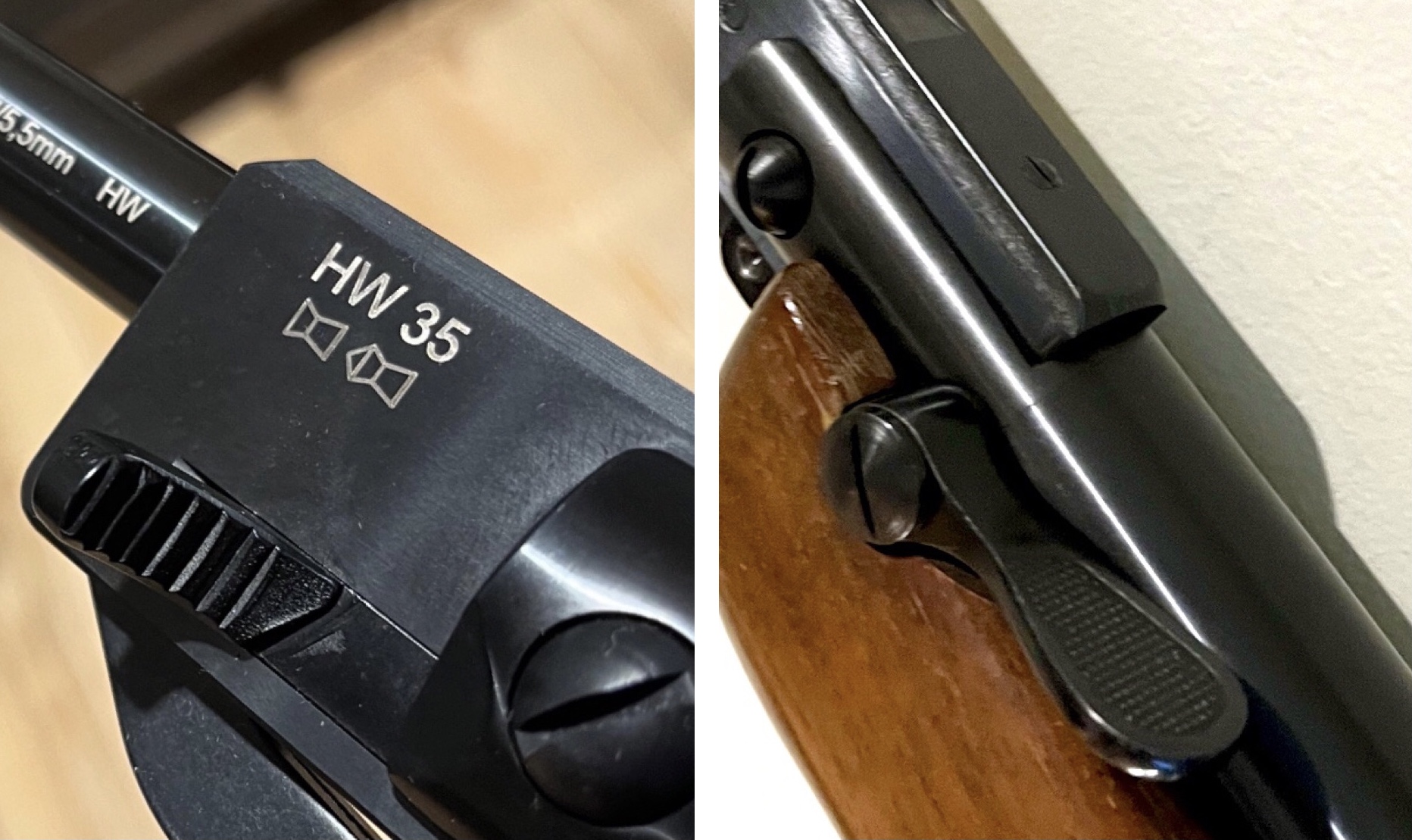

The last picture is of the locking lever found on the HW35 and HW55. The claim is this lever makes the gun as ridged and accurate as a fixed barrel model. The 35 also comes standard with sling hardware. Because it locks like a fixed barrel there is no worry about the action breaking because of a sling.

From what I understand, the lockup on the HW 35 is not quite as positive as that on the HW 55. The 35 employs a spring loaded wedge, whereas the 55 has an adjustable camming action. From the AEAC review of the 35 if the action is not closed smartly the wedge will not seat properly and a low shot will result. On the other hand the 55 system is rather complex and is one reason why we will probably never see that model back in the HW lineup.

Considering accuracy only, I also agree the 55’s cam system is superior to the 35’s. True, the 35 needs a positive close as all wedge or ball systems do as well. Not as much though. I knew a guy that closed the cam on his 55 before closing the barrel and upon closing the barrel damaged the cam system. This cannot happen on the 35. Everything is a trade off. I also find the threaded receiver cap easier to take down than the internal sleeve style with the square pins.
