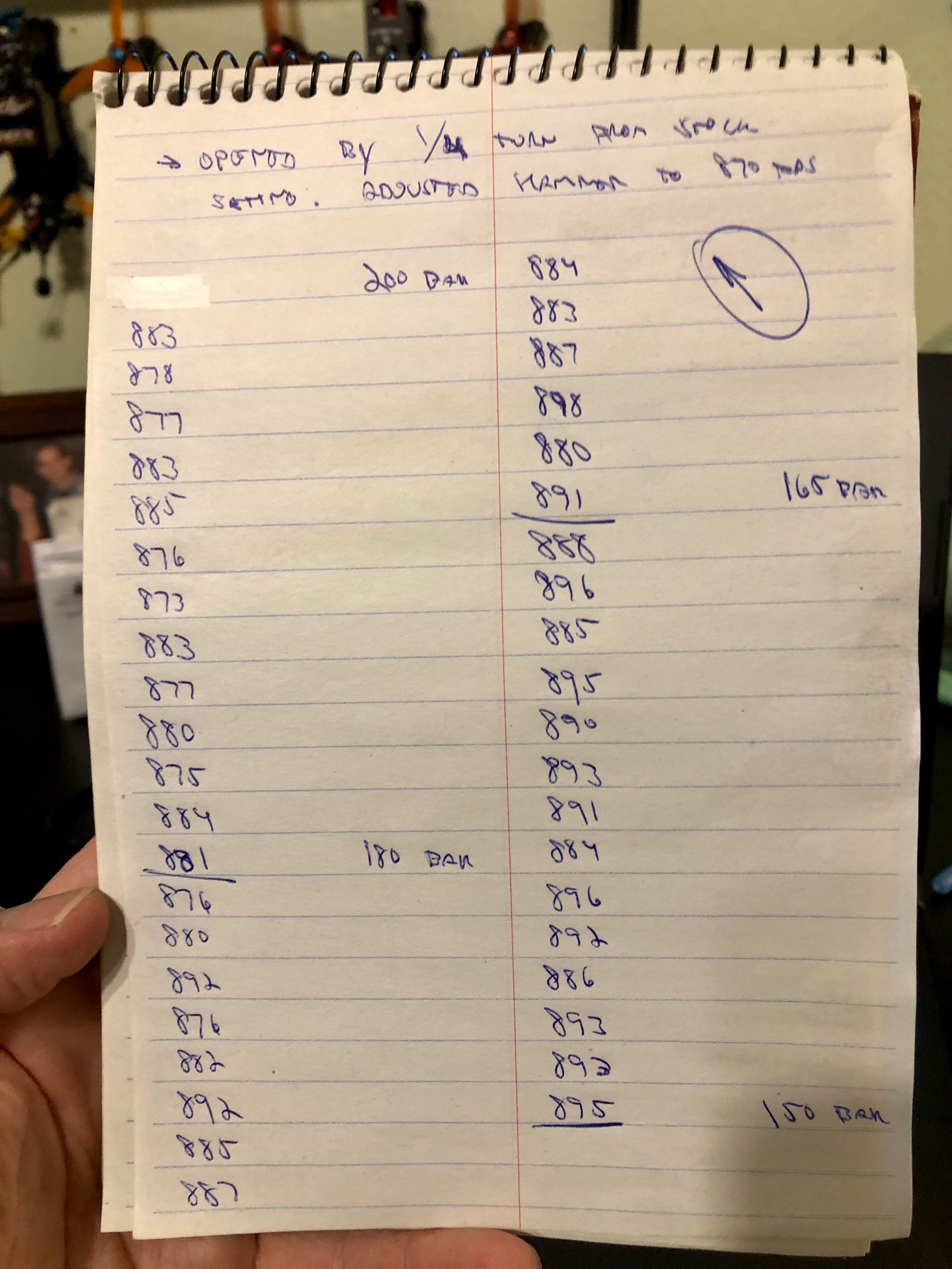

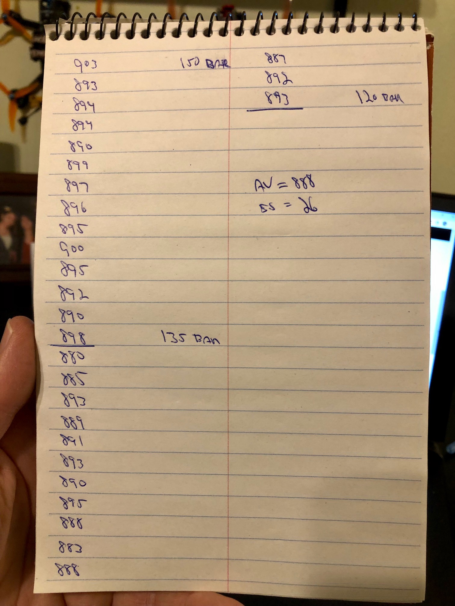

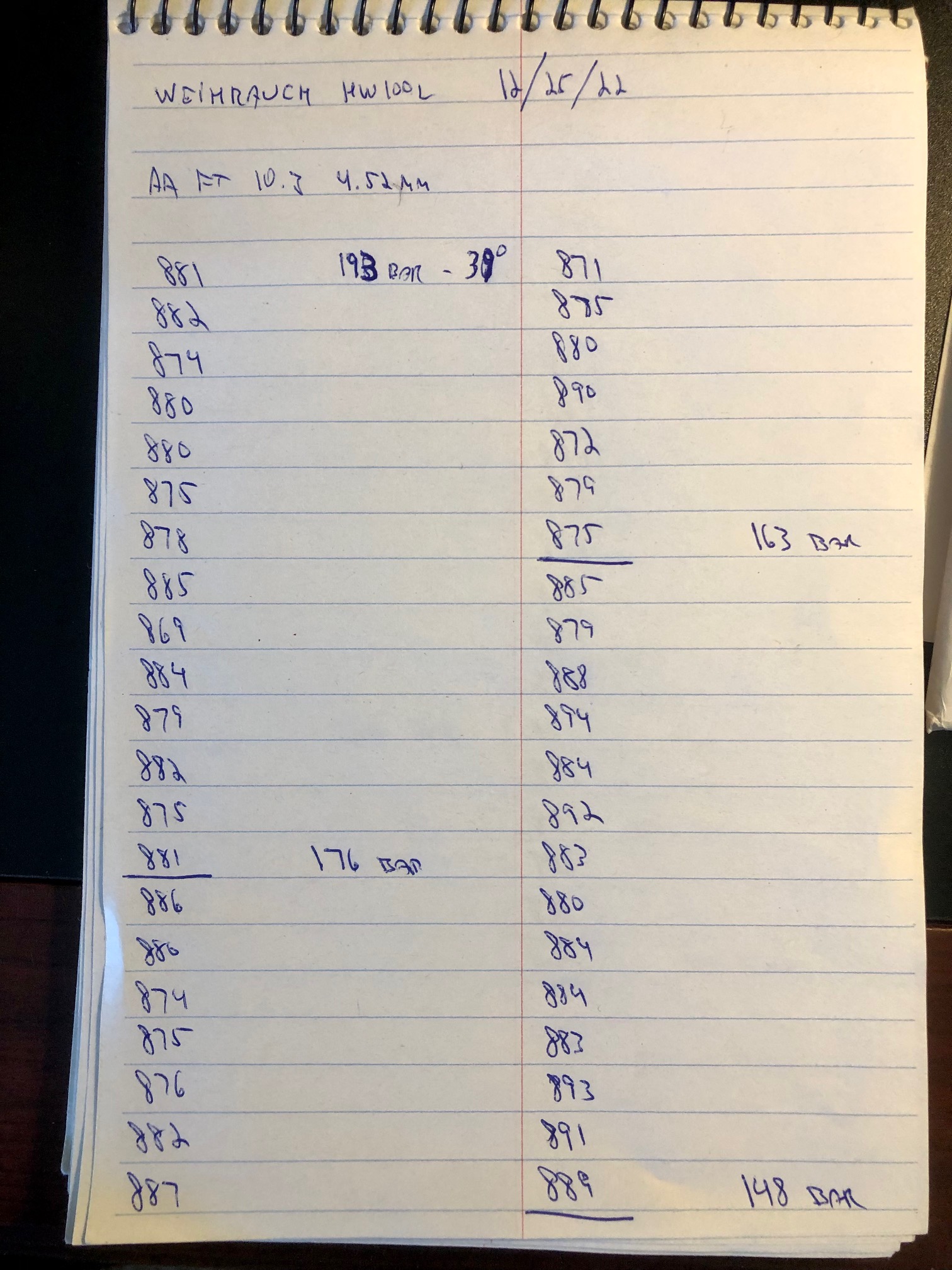

When I received my new .177 HW100 a few days ago, I was getting 1000 fps with the Air Arms 10.3 gr pellets.
I backed the hammer spring tension until I got around 880 fps with the same pellets.
The problem now is that the spread from a full tank to an empty tank is about 50 fps...
Let me explain... At 200 BAR my speeds are right at 860 fps and at 120 BAR the speeds have increased to 910 fps...
I'm thinking to DECREASE the regulator pressure down a bit and, if need be, INCREASE the hammer spring back up to get the 880 fps I'm looking for.
Any thoughts...?!?!
Thank you
