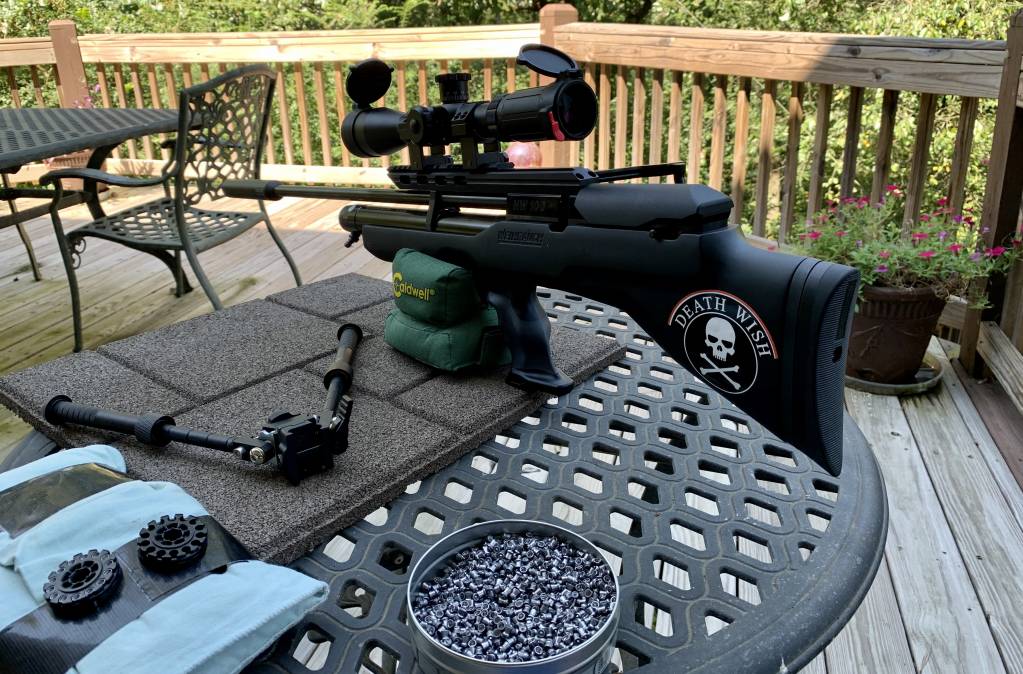

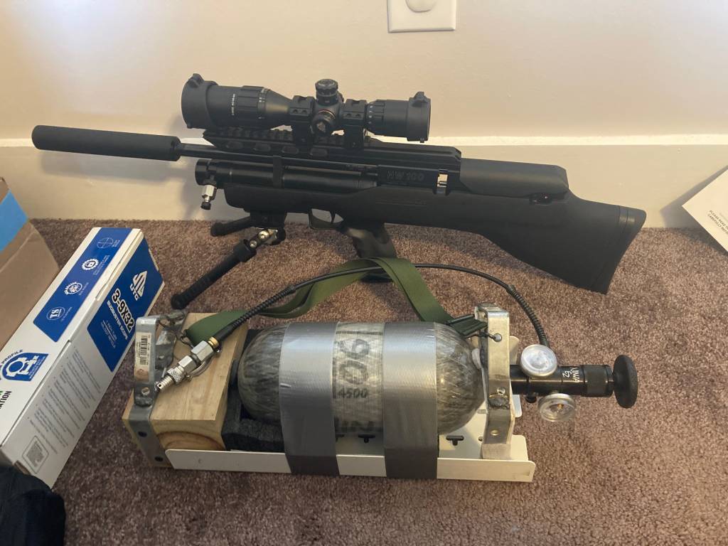

I own both the .177 and .22 full length HW100 Bullpups. The cylinder on both is 175cc and the barrel length is 24 inches not counting the suppressor. I can't speak for the carbine. Shot count on the .22 is 28 and shot count on the .177 is 32. The .22 shoots one hole groups with CPHP at 20 yds and the speed is 976 (according to the FX chrony). The .177 will hurl a Crossman 7.9 premium light at 1080 fps and a JSB Exact Heavy at 981.

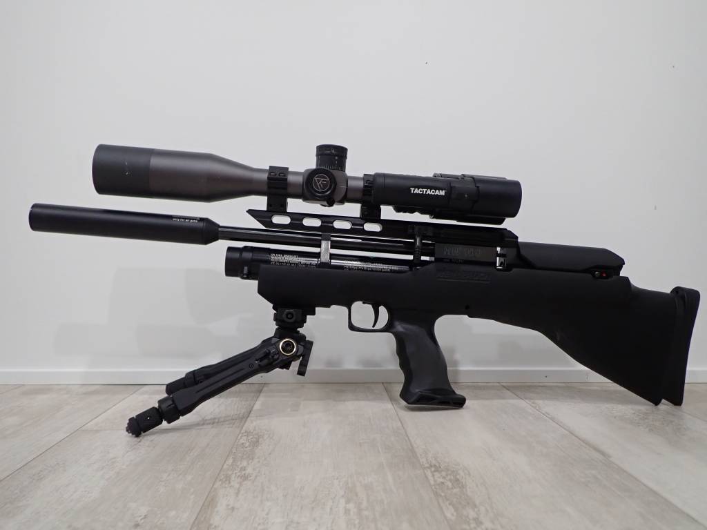

Here is the .177. The .22 looks the same.

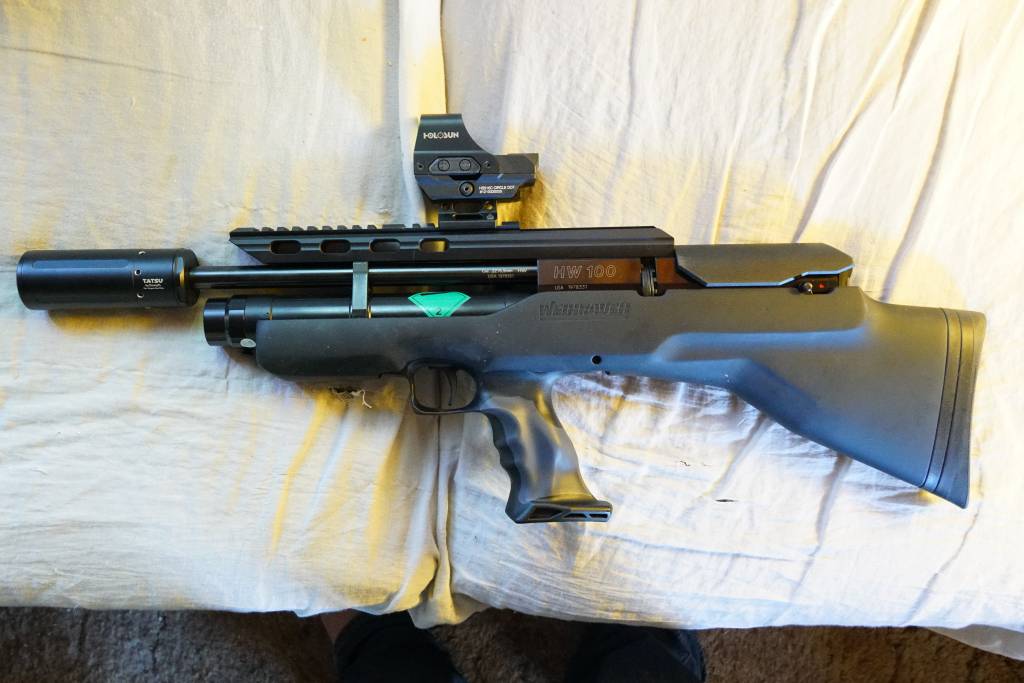

Mine is the actual "bullpup". A put the Donny Tatsu suppressor on it. It's shorter than the Weihrauch and even though it's shorter, it's also a little quieter. The length on mine isn't representative of the "as delivered" gun. While I've not done a shot count, yes, the short cylinder does cut in on, and shorten the shot count. It doesn't bother me.

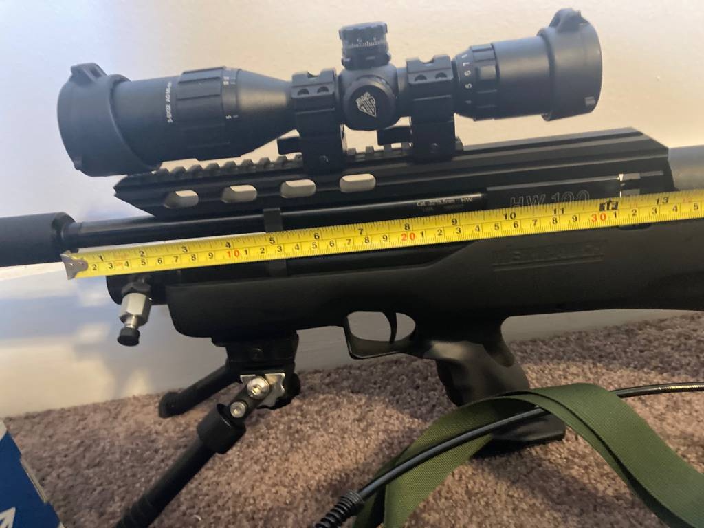

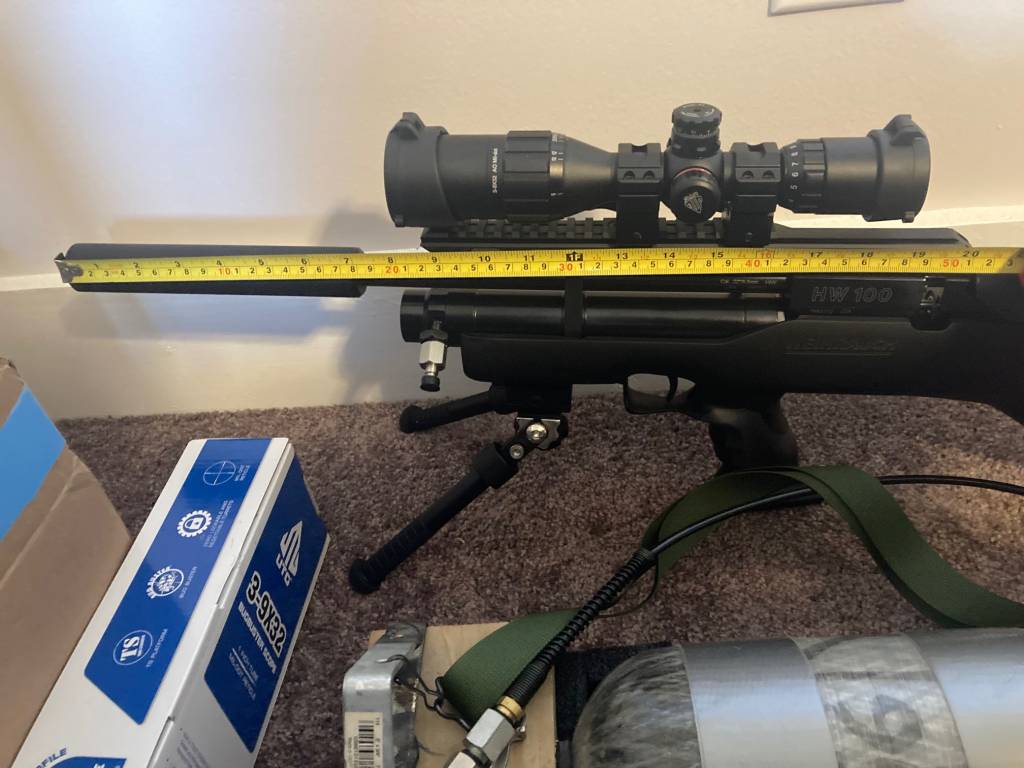

I have the HW100 BP-K in .177. It sends Polymags (it's favorite) down range at 977 fps. I have no problem taking out 1/2" paint balls at 50 yards if the wind is light. It also likes the JSB 8.44 domes, Mako 10.5g. slugs to 50 yards, and most all others do well out to 35 yards. I have 3 magazines and refill after shooting them. (42 shots with no poi change) Total length with the stock moderator is just under 29". The air tube is marked .105L / .028 gal (US). If they offered the BP with a 410mm barrel here in the states, I would buy a .22 today.

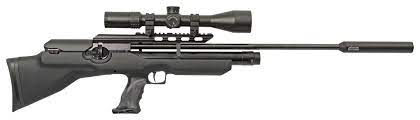

When the HW100BP was introduced, all of the reviews of them had the BP version (not the K model) with a 410mm barrel and a longer higher capacity air cylinder. However, I've never been able to find this version at any retailer, U.S. or overseas. No offense intended to anyone who owns an HW100BP with the 610mm barrel, but it has no appeal to me to want a 40" long bullpup. It looks proportionate with the 410mm barrel, but it just looks out of proportion with a 610mm barrel. Look at the photos below for the unobtainable version vs. the rifle length barrel. If someone has a link to a retailer who sells the 410mm barrel HW100BP, please PM me or post a link.
410mm barrel version 33 inch length
610mm barrel version 40 inch length
