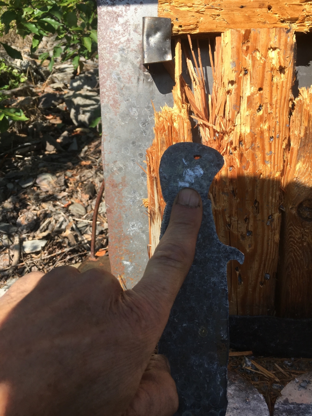

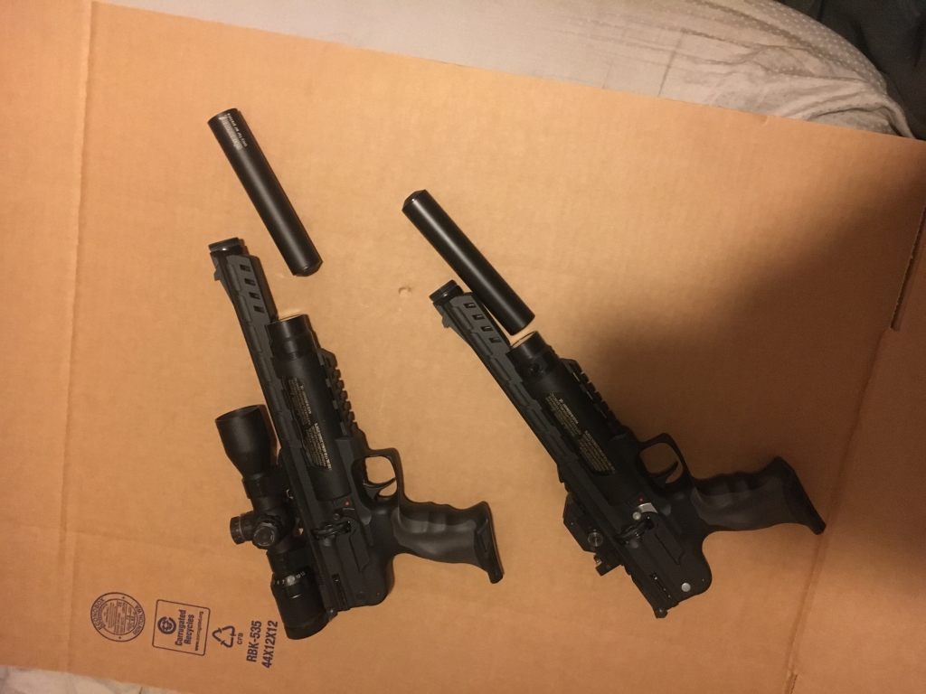

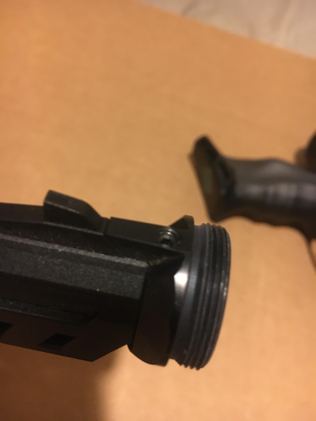

I like the pistol so much l bought a second one in .22 cal. Both are incredibly accurate and get about 20 shots per fill. I bought the .177 from AOA and the .22 from the classifieds here. Both moderators unscrew and come off easily, they unscrewed in front of the set screws. I never tried the set screws after hearing they would shear off. I didn’t apply heat either, just a firm grip and a turn. They are both extremely accurate, the .177 being faster and flatter shooting. Here’s a gopher target at 60 yards, using two bags and a solid bench you can hit the head almost every time...at 60 yards!!! These pistols are more accurate than a lot of rifles!! Excellent trigger and very quiet. I would pick the .22 for hunting but I would definitely pick the .177 for distance and target shooting, flat and fast.
The moderator screws are actually not too hard to remove on the non-Krale purchased ones. The US based moderators are installed with grub screws the have a top which sheers off when they are installed to a certain tightness - thus leaving a grub screw with no way to back it out. Mine had no blue or red locktite of any kind. The good thing is these screws are made of really crappy quality metal so they will sheer at a certain torque. It's very easy to either dremel a small slot and unscrew them with a flathead or get some left twist drill bits and just back it out. Them get some set/grub screws off Amazon and replace with a nice quality steel hex head screw. Can all be done in under 30 minutes.
