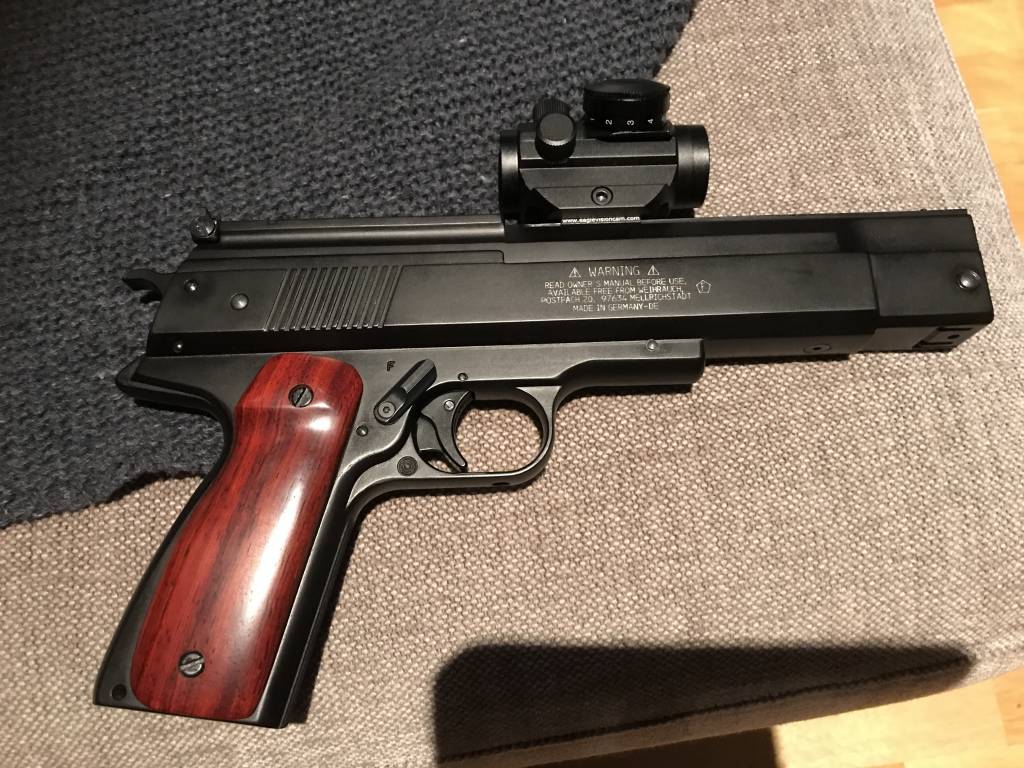

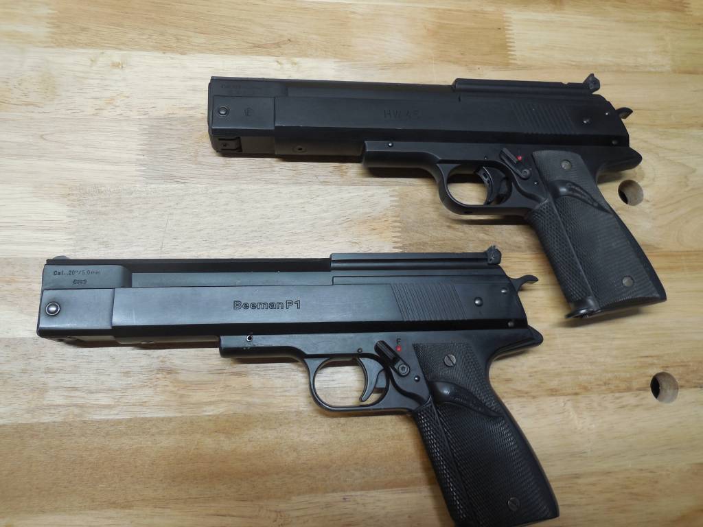

Looking to buy one as a match to my Beeman P1 and Daisy 747. I read that the scope mount groove is 13mm, but the old Beeman catalog says 11mm ? Which is correct ? My not-so-great 73-year-old eyes make open sights, especially at 20 yards or so, not an option.

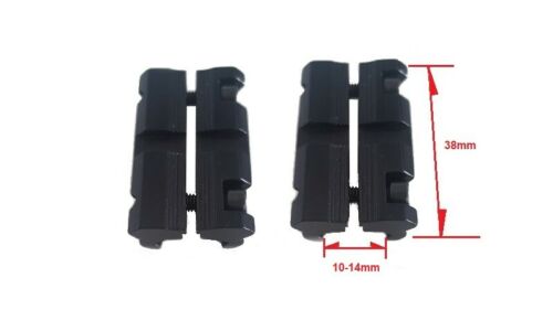

13mm 100%….If you need any advice, i could give no better than buying a 11mm to 20mm Piccy adapter and fitting either a 20mm red dot, or using 20mm mount grooves on the adapter i mentioned….
11mm adapters have a bigger opening than 11mm scope mounts and easily fit the odd ball 13mm rail and remain central.
I had heard that the unusual 13mm minimum dovetail was used because the more usual 11mm would have compromised the thin wall of the top strap if they had cut in any deeper.

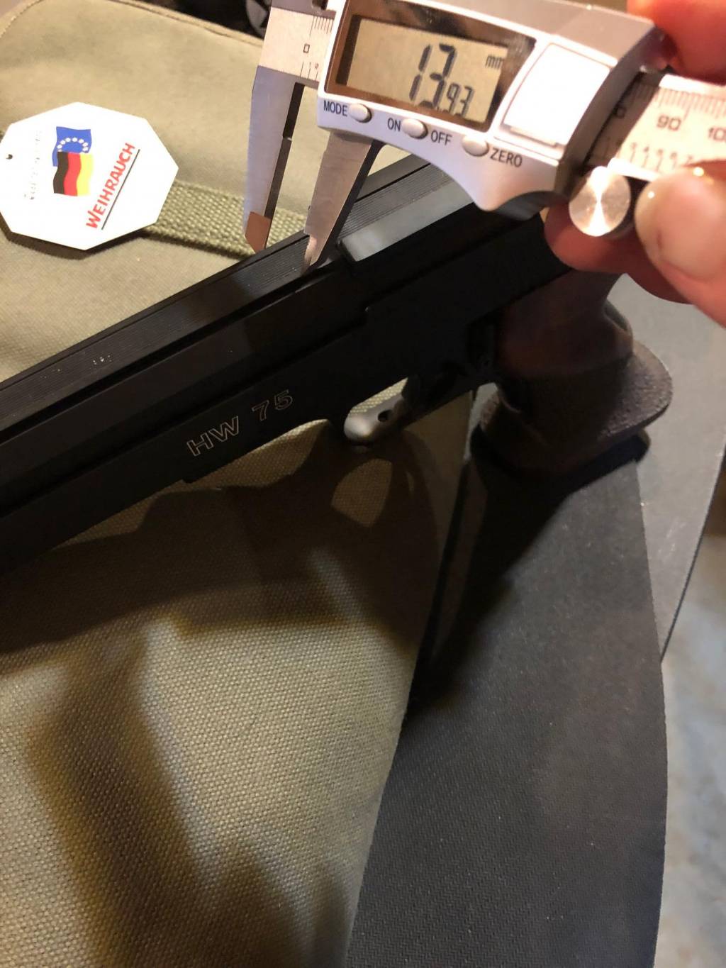

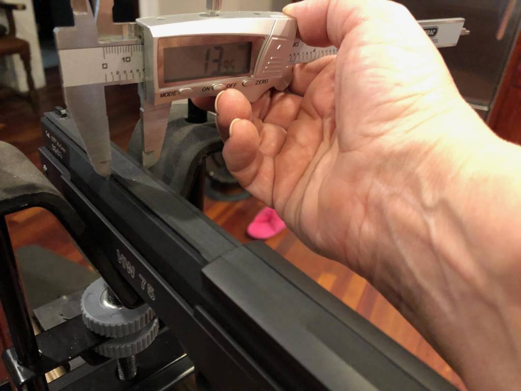

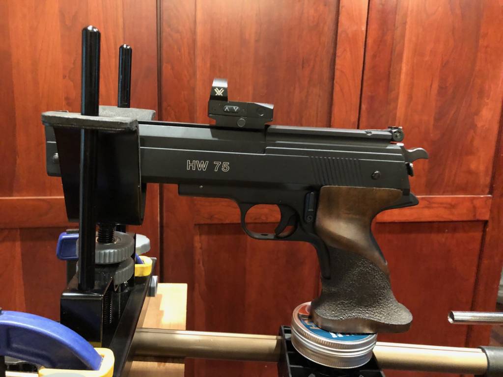

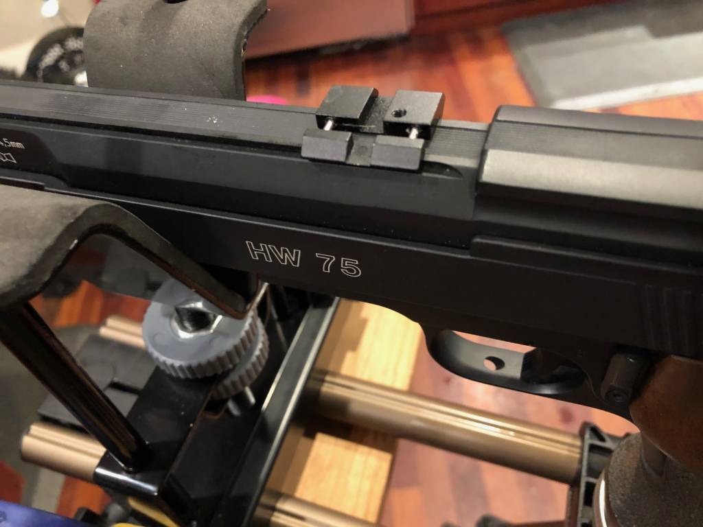

I have an HW 75 - really like the iron sights, but it shoots so well that I wanted to see what would happen if I added a red dot or a scope. Here is my measurement of the rail, and the technique Steveoo describes:
Adding the adaptor (UTG):
Attaching the red dot:
I just love those adaptors - very handy where dovetail meets Picatinny!
Could not agree more about those adapters. I have some with red dots on airguns, and a some set up for a couple of Marlin 39a Mountie, .22 LR rifles with vintage Weaver K2.5 and 3 x scopes, to fit the Marlin tip off 3/8" mount.

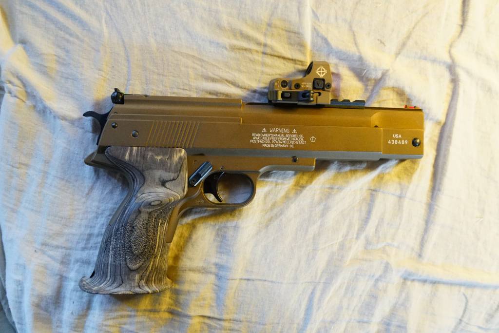

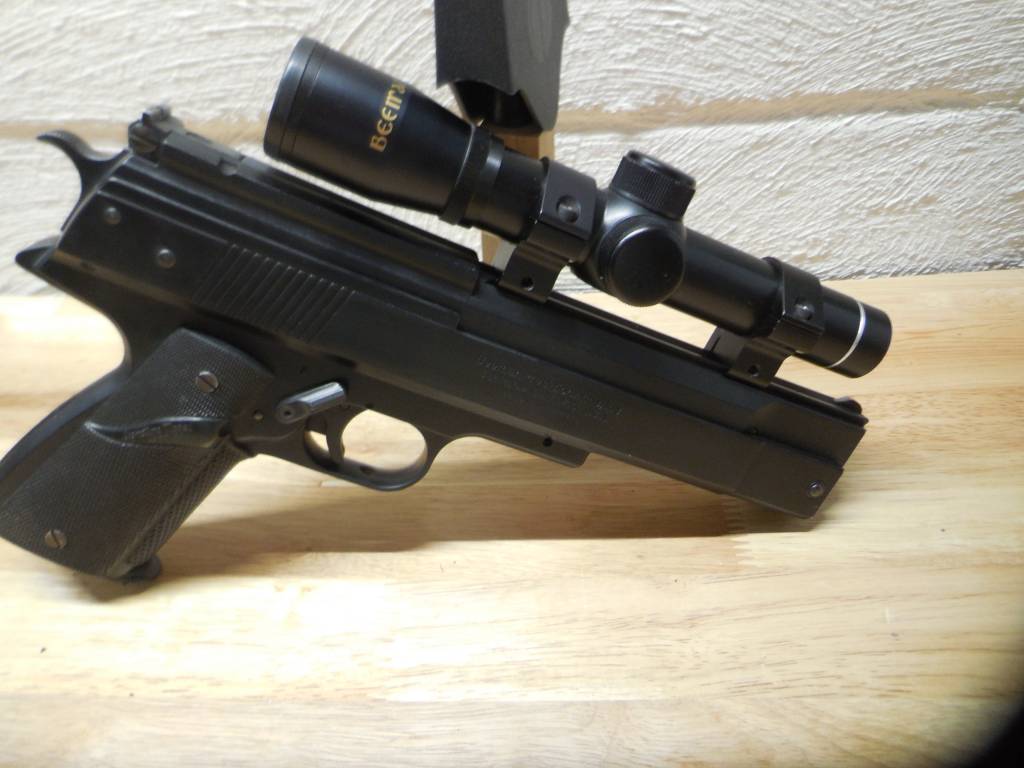

I recently had cataract surgery, ie intraocular lens replacement and went from near sighted to more far sighted but still have some astigmatism so get some flare with red dots, green not so much. I have been wanting to try a scope on a pistol so ordered a Burris 2x20 which came in yesterday and the post office has a set of Warne qd rings for the 3/8" -11mm base out for delivery today, so will not need an adapter. With the QD rings I can go from open sights to optical quickly

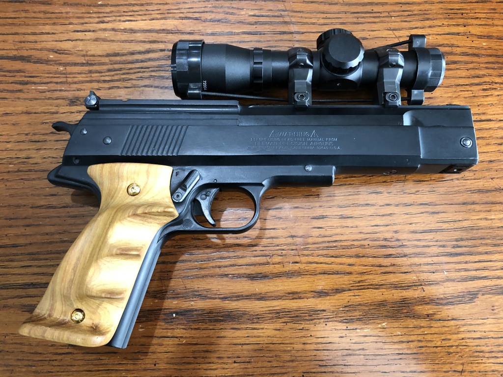

I got the little Burris in the Warne QD rings mounted today, the rings are a tight fit, takes some care to get them to seat in the grooves but once in place tighten down nicely. I was surprised at how much more accurately I could shoot with the crosshair as compared to a small red dot. I went out for a few minutes before it got too hot, quickly zeroed it and then shot a ten shot group just under dime size at 15 yards, if you will discount the one flyer that I called when I pulled the trigger. This was using some of the cheap Crosman pointed pellets which fit the chamber rather loosely, and some looser than others. I suspect it will be a real tack driver with some good pellets, I just wish the eye relief was a little longer so I could hold the gun with arms extended.

I have been using those little UTG adapters on a variety of firearms and airguns. I have a couple of old Marlin 39a Mountie rifles, .22 cal lever actions with the Marlin tip off mount, a 3/8 grooved mount much like and about the same as the more common 11mm mount. Now I have a couple of vintage Weaver scopes, the lower power K models, one a 2.5 the other 3x, post and crosshair, ad one with German #3 Post reticules, in Talley quick detachable mounts with the UTG adapters so I can pop the scope off in a matter of seconds and use my iron sights. On the airgun side, some are in mounts for red dots, and a couple in scopes, both on some Crosman 22xx clones, and one for a little Burris scope on an HW 75

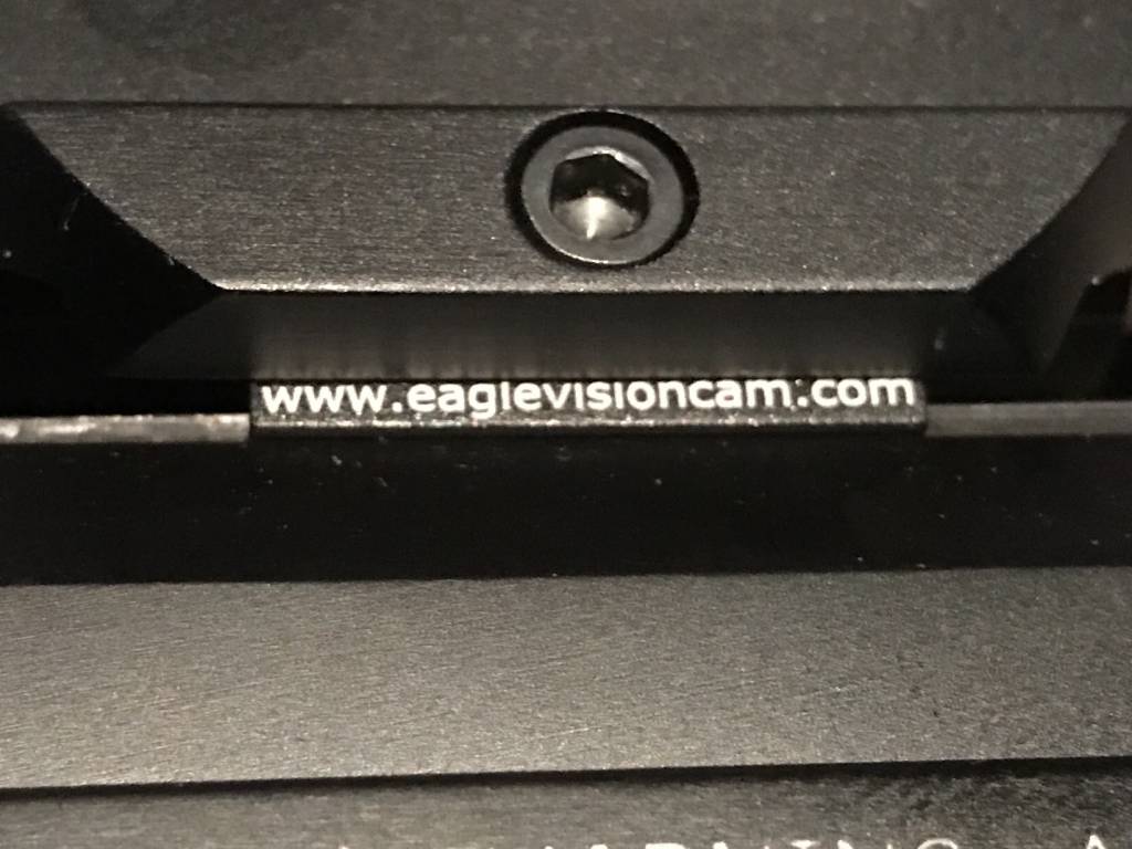

Now that this has sorta turned into an adapter thread, yeah, Eagle Vision adapters are nice.
There is another one or two on the market. One that I bought, didn't have the angles cut correctly. And the intersection of the angles was a radius, not a sharp angle. These two things lead this brand to be a throw away adapter. Sorry, I don't recall the brand, but check the photos in the sites carefully, must have sharp angles.

Those little UTG adapters not only work for the 11mm dovetail, but the 3/8" Weaver tip off dovetail which calculates to about 9.5mm
