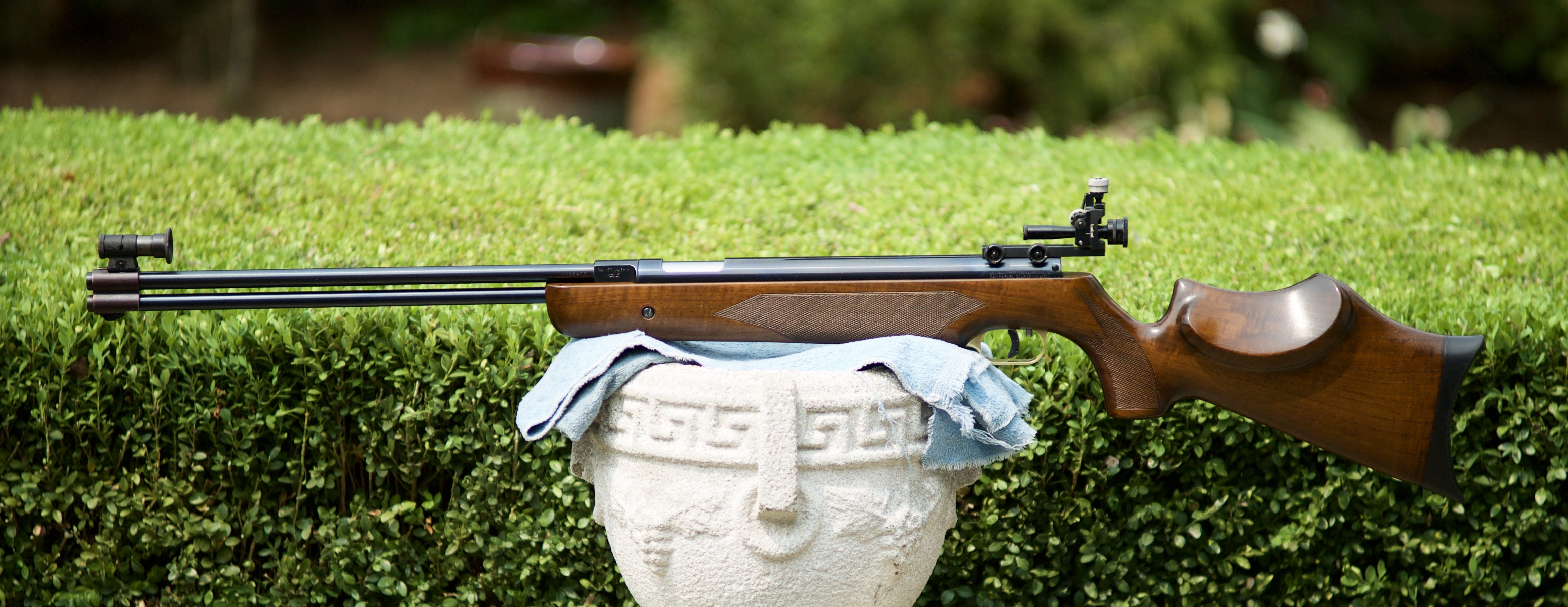

I have neither, but as a leftie I like the Ambi stocks that HW offers. Talking of stocks, HW offers a lot of variety within the HW77 range. The thing that would confuse me within the HW77 is what advantage the 77 standard offers over the 77K?
I like it's looks and it's got irons as a primary or back up sighting ..
Bust a scope. No problem go irons till you grab another and keep shooting
My hw95 is so good on irons I rarely ever scope it .
So if choice 77 or 97 it's 77 all the way

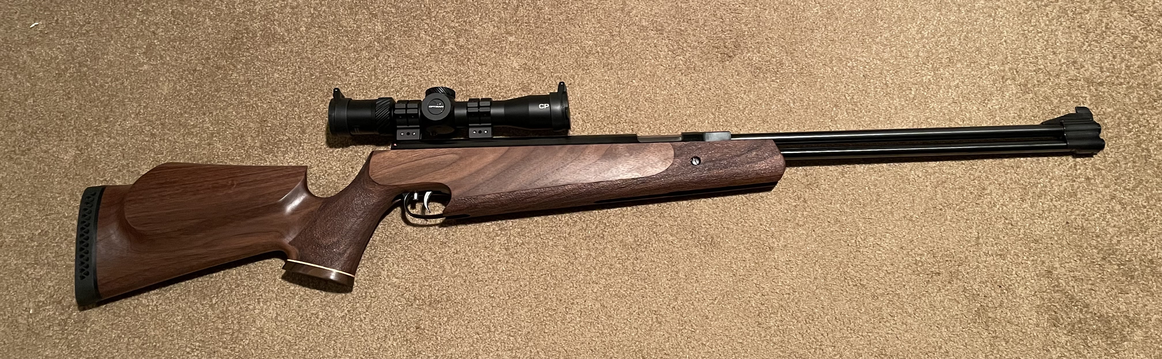

Love the stock. Now tell me how you like that scope, compared to others you have tried?
