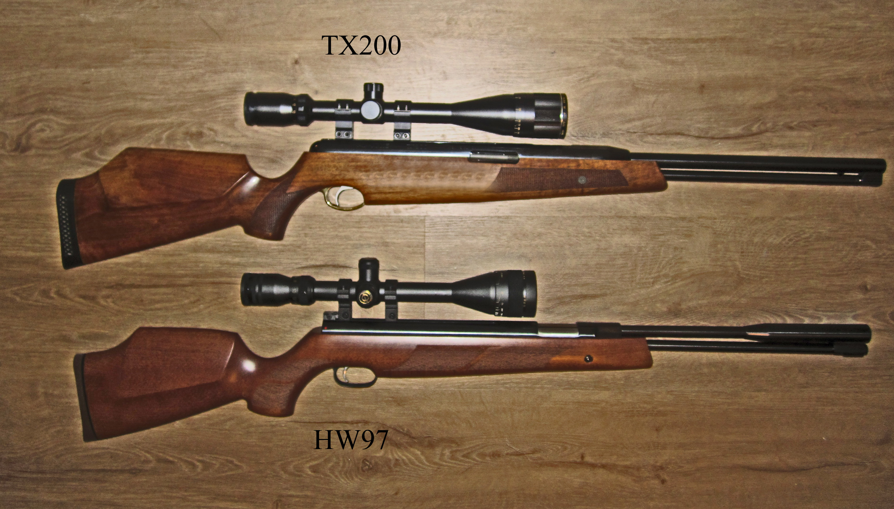

I own a TX200 in .22 and an HW97 in .177. You can't go wrong with either one but if I had to choose it would be the TX200. The TX200 has a factory walnut stock. The standard HW97 factory stock is beech. The TX200 can be disassembled easily without a spring compressor. My TX200 has that pleasant thunk sound out of the box. The HW97 needed a Maccari kit to remove the buzzy firing cycle it had before tuning. An HW97 has lots of spring preload requiring a spring compressor to tune it. It is difficult to reconnect the finely threaded receiver with it's strong spring tension. The TX200 trigger is setback from the factory and is easy to reach. The HW97 Rekord trigger is excellent, but I had to buy an aftermarket setback trigger from Rowan Engineering in the U.K. to achieve the same grip feel. My TX200 has a left handed walnut stock and left side fill port. The HW97 has an ambidextrous stock and fill port.
The HW97 retails for less than the TX200 but if you factor in the cost of accessories to make the guns equal I'd opt for the TX200. Fit and finish is a tie as both rifles are extremely well made. My HW97 is about 15 years old and my TX200 is over 20 years old. I assume the Air Arms TX200s are as well made as in the past. Weihrauch is known for the quality of their products so I assume the quality is the same as in the past. IMO, the newest style Weihrauch stocks are not as attractive as their older spring rifle designs. I especially don't like the bag rider recess on the new Weihrauch springer stocks.
This is like a Ford vs. Chevy comparison. Each have their merits. Both are excellent and I like both rifles. But if I could only have one it would be the TX200.
