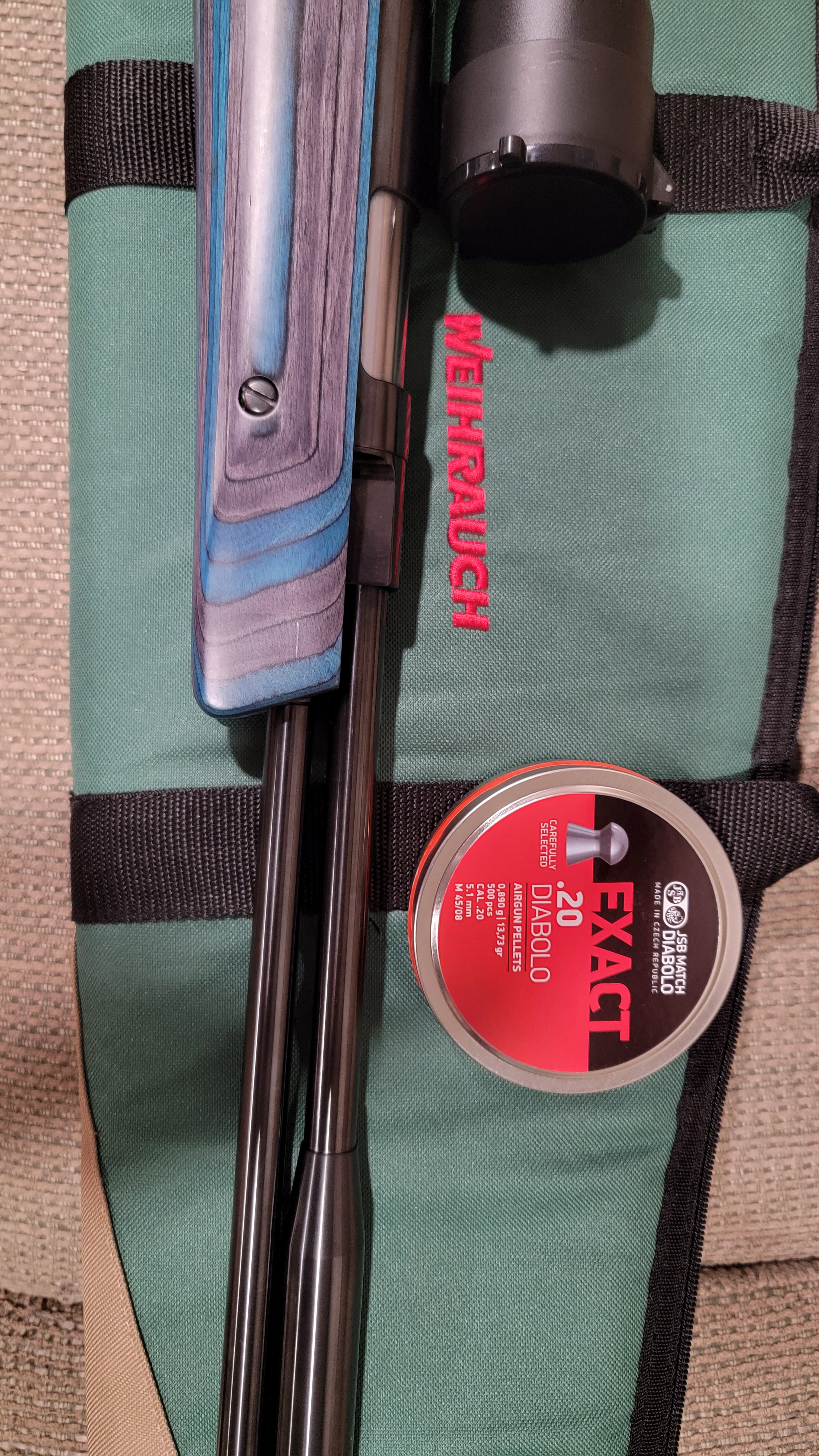

My problem, if you want to call it that, is a long relationship and favor for Weihrauch's and .20 cals.
