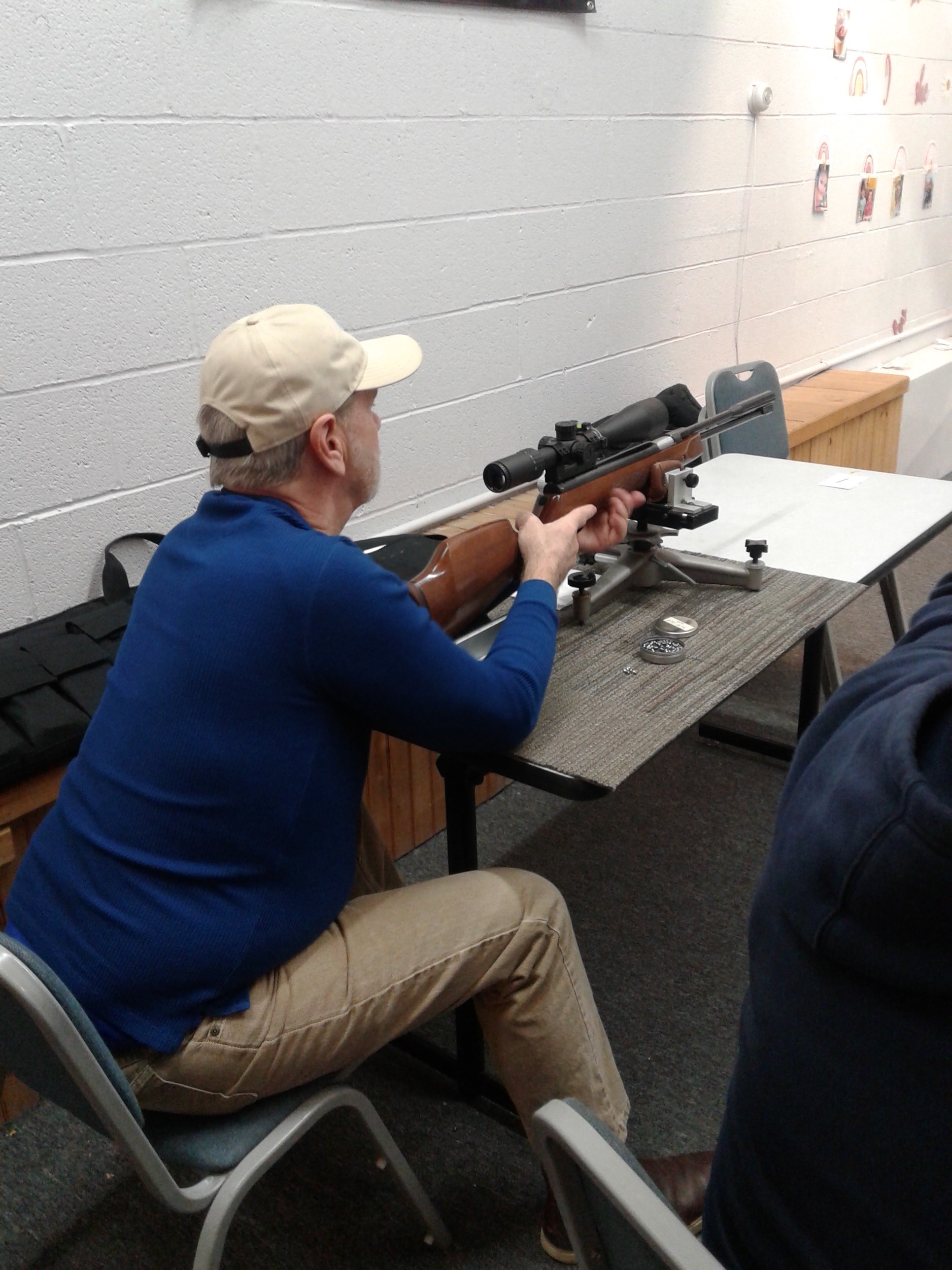

Good post. The 2 most consistent shooters in our group are myself and my buddy Sam. We are both long time centerfire benchrest shooters.We both shoot pretty much like we do in that game. Front rest and rear bag, free recoil. We try not to touch the gun when firing the shot . I very lightly touch the pistol grip but Sam does not. Everyone else seems caught up in the artillery hold which we laugh at. My wife also shoots free recoil and she will take your lunch money real quick. I will see if I have a pick of our set up to include. Sam shoots a pair of 97s. I really don't see one as being more accurate than the other. As far as why I changed the spring, I was getting shone bad shots that I did not think was me. I know when I shoot a shot that strays because I made a mistake for the most part. So I checked the velocity and was down 100 fps. Spring I took out was not broken but had a double twist, you could see where the break would occur. There is a pic of Sam with his set up. Sam shoots group after 3 shot group at 20 meters that look like 1 pellet was shot. Not 2 or 3 in a row I am talking 10 to 15. I think both his 77s he bought used..
Good post. The 2 most consistent shooters in our group are myself and my buddy Sam. We are both long time centerfire benchrest shooters.We both shoot pretty much like we do in that game. Front rest and rear bag, free recoil. We try not to touch the gun when firing the shot . I very lightly touch the pistol grip but Sam does not. Everyone else seems caught up in the artillery hold which we laugh at. My wife also shoots free recoil and she will take your lunch money real quick. I will see if I have a pick of our set up to include. Sam shoots a pair of 97s. I really don't see one as being more accurate than the other. As far as why I changed the spring, I was getting shone bad shots that I did not think was me. I know when I shoot a shot that strays because I made a mistake for the most part. So I checked the velocity and was down 100 fps. Spring I took out was not broken but had a double twist, you could see where the break would occur. There is a pic of Sam with his set up. Sam shoots group after 3 shot group at 20 meters that look like 1 pellet was shot. Not 2 or 3 in a row I am talking 10 to 15. I think both his 77s he bought used..View attachment 513768
What scope does he use?
Verydon. You didn't ask but I use Sightron and Hawke. Only thing I don't like about Hawke are the reticles. Too busy for my liking. I like just cross hairs and a dot. You can only shoot what you can see. It seems like the Airgun world hasn't discovered scopes over 12x. I shoot 20 or 24x. Sam's scopes go up to 40x.

Ok what Sightron are you using, I've had 4 of them and still have a 4-16X42 big sky but it's a milldot. While I'm at it what pellets do you guys shoot?
I have 4 Stacs. 3 are 4-20 and one is 3-16 and 2 SVED 10-50×60s . Sam is shooting the light AA pellets in the blue tin. I shoot AA 10.3 or 8.4 in the TX or JBS 8.44. 10.3 AA or 8.44 JBS in the one 75 and JBS 8.44 in the other. In the D54 .22 its JBS 15.89 or JTS Dead Center in 16.08. I don't lube and mostly don't sort except I do weigh for a match occasionally just to get rid of the crazy ones.
