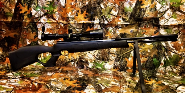

Hello again everyone, I recently purchased the Weihrauch HW97KT Blackline in .22. So far this rifle is fantastic! I have about 650 rounds through it so far and from what I have watched on You Tube and what I have read suggest that break-in period is around 200-300 shots. Mine is still dieseling after 650. Everything is coming together and it is smoothing out. My question is, those of you who own this or similar guns, Did you disassemble the gun and tune it? I would like to do this just to get rid of the yellowish Vasoline type grease Weihrauch uses. Also I have the full power version (15-17FPE) is there an upgrade kit available or even a spring that will give maybe 17-19FPE?
This is my rifle
