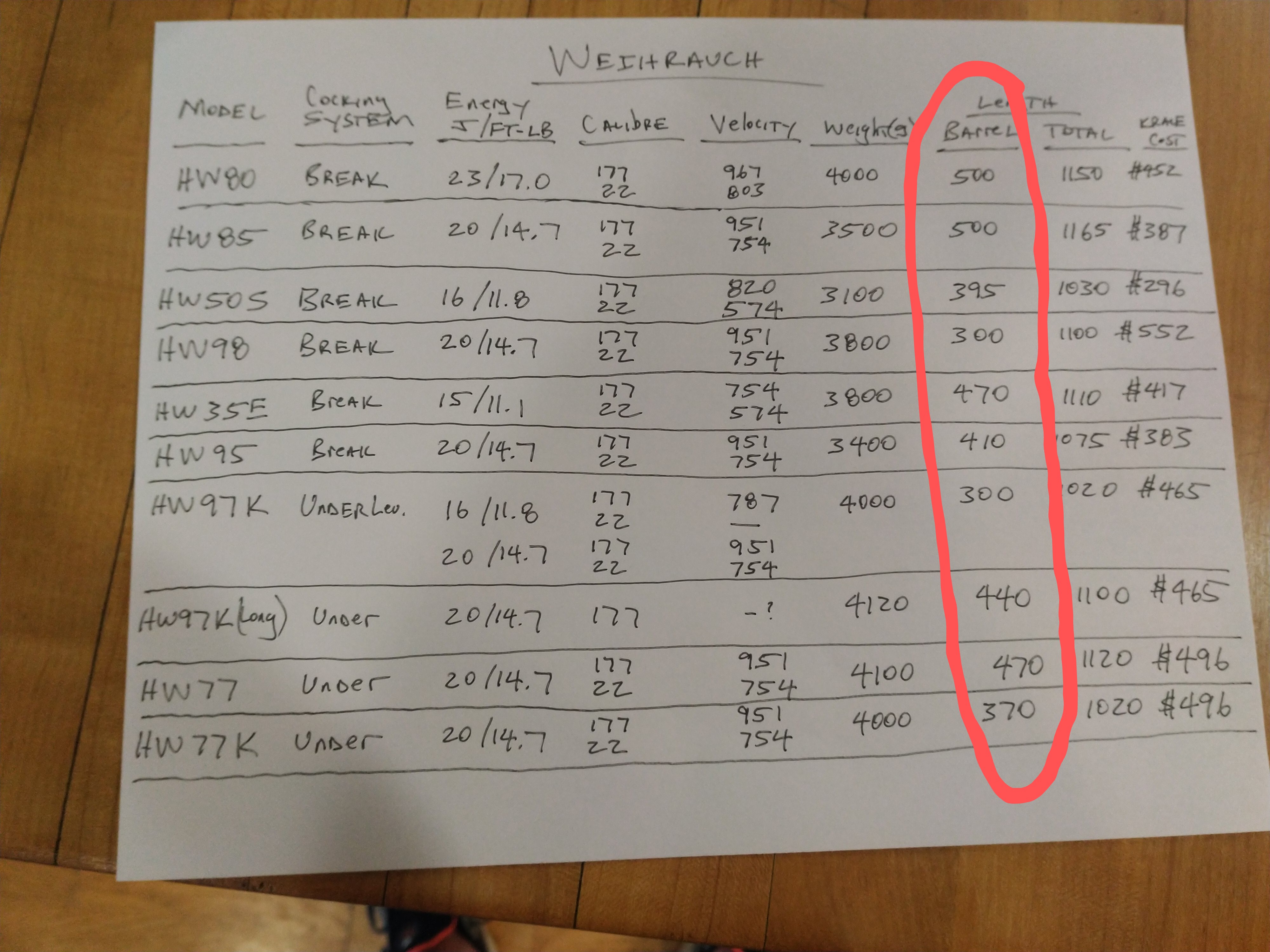

I see tons of reviews on HW97K, and HW98 that brag about great accuracy, but the barrel is only 300mm long. (They do make a long version of the 97 with 440mm barrel)... If these reviews are true, why would one want something longer than 300? They have various models with 300, 370, 395, 410, 440, 470 and 500mm barrel length. Sorry for the old-school compare, but all are listed from Krale below..
I see tons of reviews on HW97K, and HW98 that brag about great accuracy, but the barrel is only 300mm long. (They do make a long version of the 97 with 440mm barrel)... If these reviews are true, why would one want something longer than 300? They have various models with 300, 370, 395, 410, 440, 470 and 500mm barrel length. Sorry for the old-school compare, but all are listed from Krale below..View attachment 272226
As Bear-of-Grayling mentioned, it has more to do about using iron sights and having a long sight radius.
It's also about ease of cocking as longer barrels give more leverage - nice to have on a HW80 or 90. The HW35E has a long barrel for better sighting.
Unlike a PCP, a longer Springer barrel only slows down the pellet (more drag), but doen't lessen accuracy - just increases lock time requiring a more patient hold. My most accurate springer is my .20 caliber HW80 - 1.25" groups @ 80 yards (no wind).
I personally would never own a HW97 or HW77 long - just added weight (some folks like increased stability with weight).
I prefer the shorter barrel for increased manageability, but also love my (3) HW35E's.
Keep in mind TX200 and Pro-sport only have a 9" barrel and look at their accuracy ........
