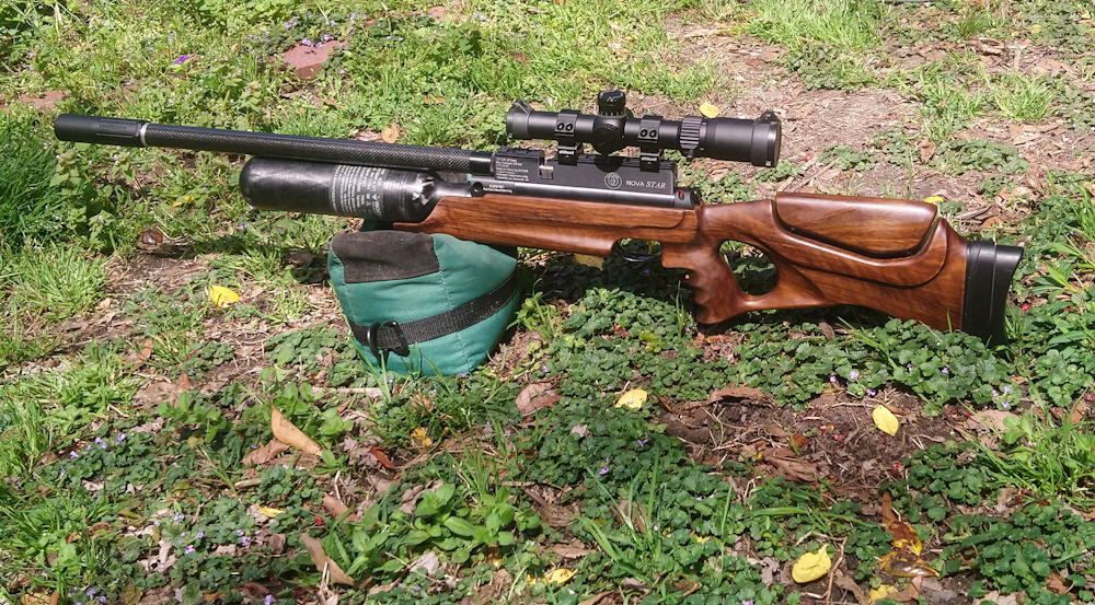

I know this is a bit off the wall, but what I might do is take some good measurements of your stock, and see if someone with a 77 can do the same. They appear to be a very close fit? So, it might be feasible to modify a 77 stock to fit. Depending what the differences are, it might be relatively easy to make it fit correctly. Or it might be a real pain. Just from visually looking at them I can say for sure the front mounting spots are definitaly not the same. But they might be in a very close location. To where they could be filled or modified with inserts. Generally, I know a properly glued wood joint is stronger than the actual wood. But this might take some grain matching, and stain matching. I've done stain matching before, and it takes some serious time and patience. But it can be done. Wish I had better photos, but this is the one I did. The cheek piece on this didn't match AT ALL. Wood was vastly lighter, and grains didn't match, but I did a lot of stain manipulation with it. As an amatuer, never having done it before.Thanks very much for the quick replies. This may result in me fabricating my own stock, something I have never done but long thought about.
