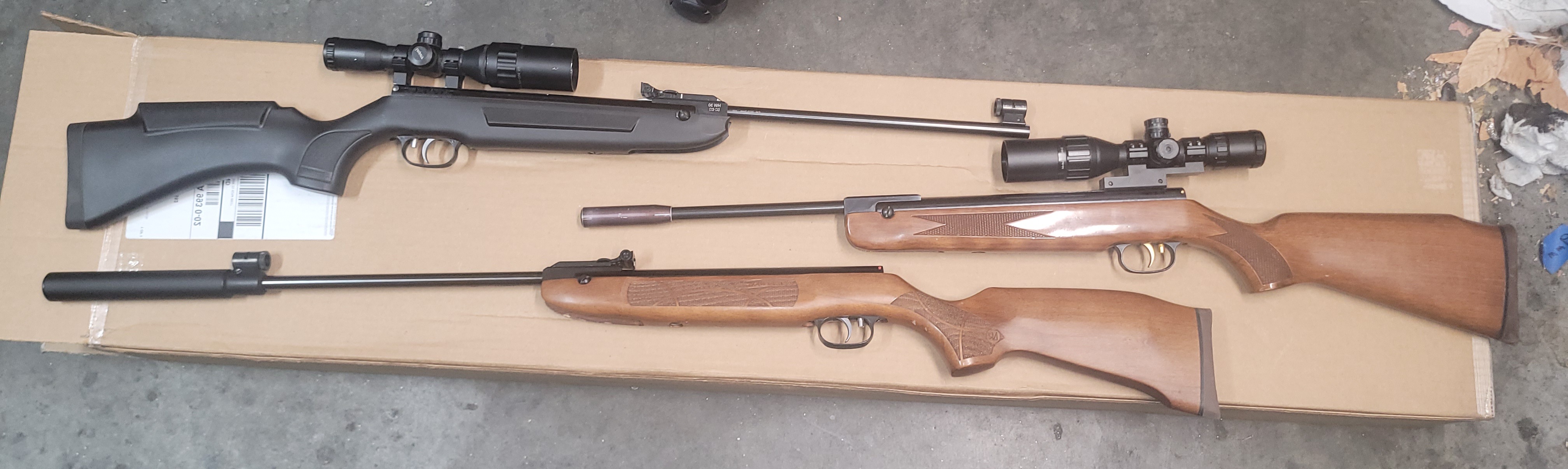

I recieved one and put in on my new to me .20 HW30 and also tried it on my HW50 .22.I decided to slip it on the HW30 .22 to try.the first shot was quiet that i thought seemed slow.The second shot "popped " and sent air out of the breech and the pellet didnt make it out the barrel. I took it out and installed it again. Couple of shots were slow and then one didn't even make it out of the barrel again and sent air backwards .
no sign or smell of diesling BTW.
It's almost like the moderator is causing some sort of back pressure. I don't know it's weird.
Somebody smarter than me please explain this.....

gun was shooting accurate before mod added and after I took it off.i did check lock up and it appears fine but that's a good idea to look into.It probably doesn't take much to change things
Sounds like you have a problem with the moderator. Perhaps check it for blockage or alignment. I had zero problems with mine. And against better judgment I cocked the guns with it. Still no problems.
It's clear and free from what I can see.
I pulled a patch through it just to check
It's gotta be something simple I'm missing
Both the .22 and .20 have new seals and springs. Both shooting tiny groups with no issues without the moderator on.
The moderator alignment fine and no portion blocking muzzle.
