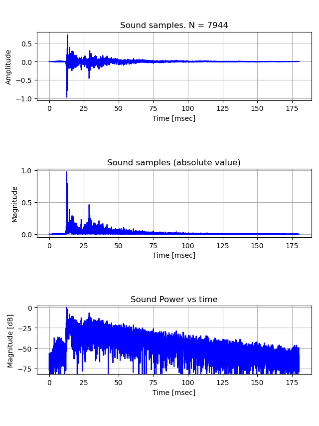

For giggles and grins, I did a test fire with a gyroid infill moderator indoors. This was with a iMM-6 calibrated Measurement microphone connected to Audacity on my PC. I adjusted the microphone gain until there was no clipping. (1/8 volume, what ever that is!) Microphone was only 0.5m away from the LDC muzzle.
I just did this to look at the acoustics of the room. Nothing is calibrated relative to an unmuffled shot. What I did see was an exponential ring down of the envelope, as well as an echo corresponding to one of the walls. (@ 28ms) I wrote a python script to plot the graph below. First trace is simply the amplitude vs time, second is the magnitude vs time, third is the power expressed in dB's vs time. The straight line in dB's (for a long time) is the exponential decay of the signal. It's hard to recognize in the linear domain, but it's real obvious in the dB domain.
Here's the wav file if you are interested.
