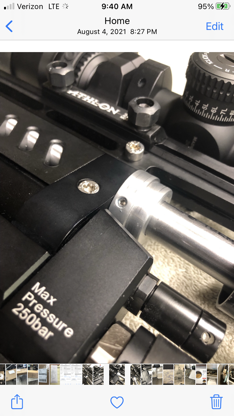

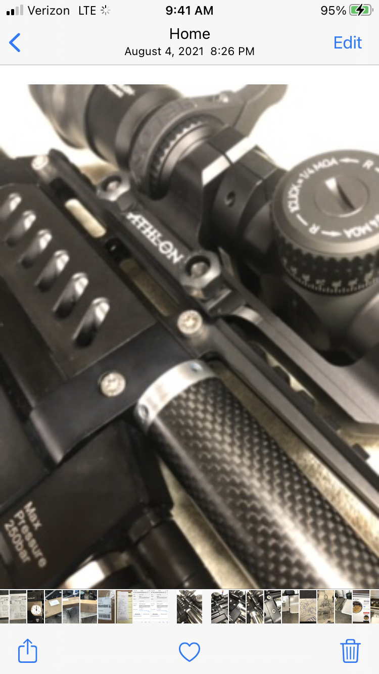

I get no blow by on my LCS. None. I came up with a modification on mine where each and everytime I pull and re install the barrel it will fall into place exactly as set from the factory
I am unsure of the westerns design as how the barrel enters and locks into the block. It looks different than the LCS. But the functionality should be the same. Early on when the LCS made its debut in 2019 there were multiple posts from people having problems of jamming and air blow by after pulling their barrels for the initial clean after unboxing the gun. Pull thru cleaning systems after all don’t work on these fixed mag guns, so the best method is to pull the barrel.
But, if not reset perfectly, there will be problems. I thought of this idea way back then and didn’t even own one till this gun from last June of 2021. It was the first thing on the list, was to get this fabricated, as I didn’t want to have to worry if I set the barrel in too deep or not deep enough.
I would do as your planning and call AOA to see if air blow back is typ with these guns. Who knows? With what power this gun has, it may be the norm and then your ok! Good luck!

If this rattler is anything like the LCS in barrel installation, the barrel when reinstalled (say you want to pull it out for a cleaning on a padded vise) has to go back in exactly as set from the factory, or you will get jamming(if too tight) o air blow back(if too loose). Too tight will risk jammed pellets and big damage, too loose loss of velocity and it will affect the cycling.
Maybe the barrel wasn’t set up correctly from the factory? I get no blow back from my LCS
