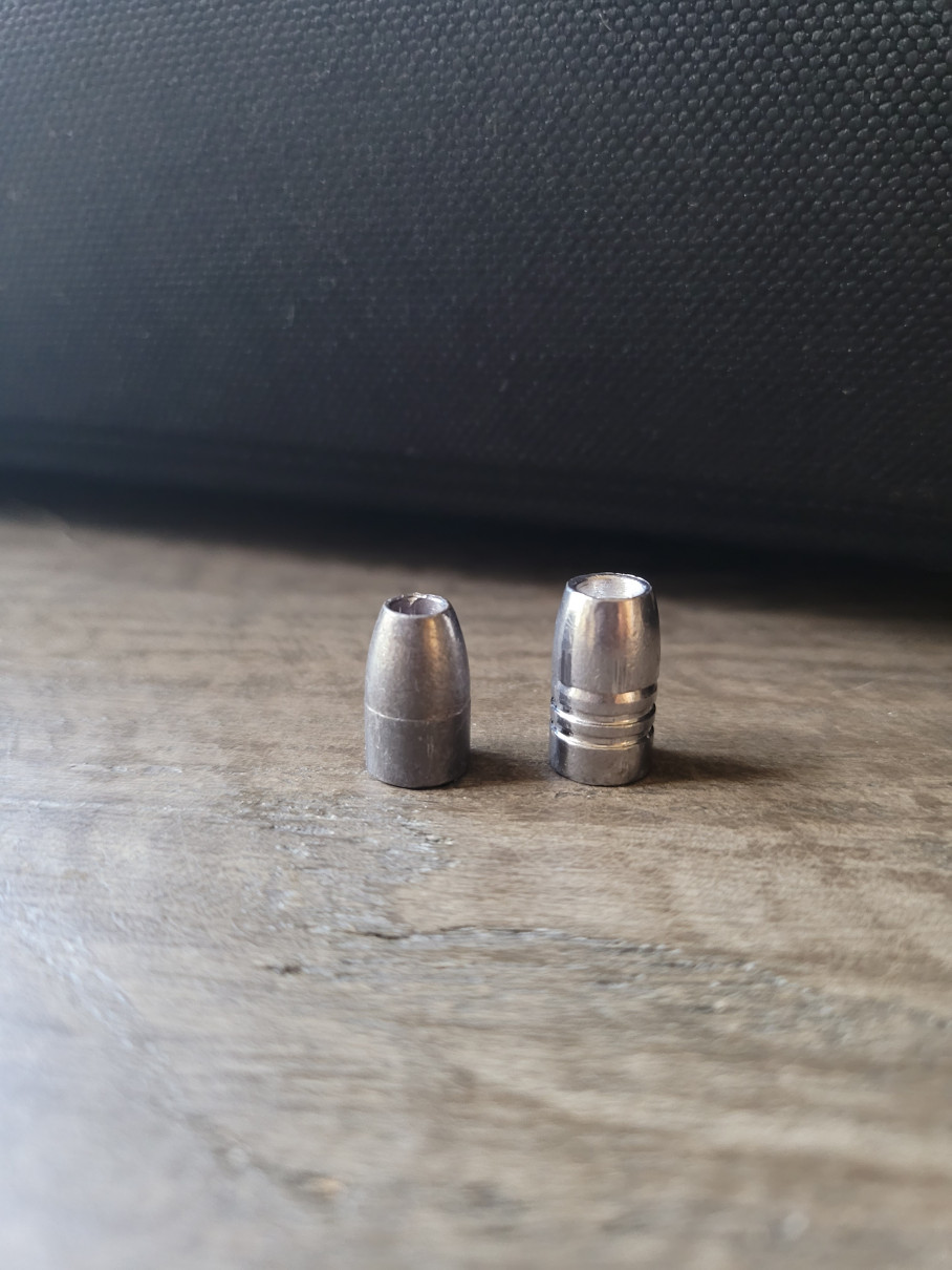

something i saw on Huben K1 is that the magazine tapers ever slightly towards barrel to prevent ammo from accidentally falling into barrel if gun was pointed down. these guns are all based off that so i'm assuming our magazines also taper a little at the end so if you get a slug that fills the entire chamber it is going to be hard to push in because of that taper. that's why i feel 0.65 is the best length.
got the Proslugs comparing to the Apex there is definitely a taper in the magazine towards the barrel to prevent ammo from sliding into barrel pointing down.
proslugs 156g hollow are 0.62 length compared to Apex 0.595 length and i can feel the taper catching on the longer one. the proslugs front is fairly wide so i believe the taper starts around 0.60. i tested putting the proslugs in backwards and they fit fine so it isn't a wide base issue.
if you use longer slugs make sure the front of the slug tapers a good bit to avoid having it catch resistance on the taper in the magazine.
all that said, every ammo i have tested so far shoots great at 20 yards which should be expected.
attaching an image of the longer proslug next to apex ammo.
i believe the ideal bullet shape for hollowpoints would be the Apex with a more rounded tapered nose but in a heavier longer format like the 0.62 and 160g.
