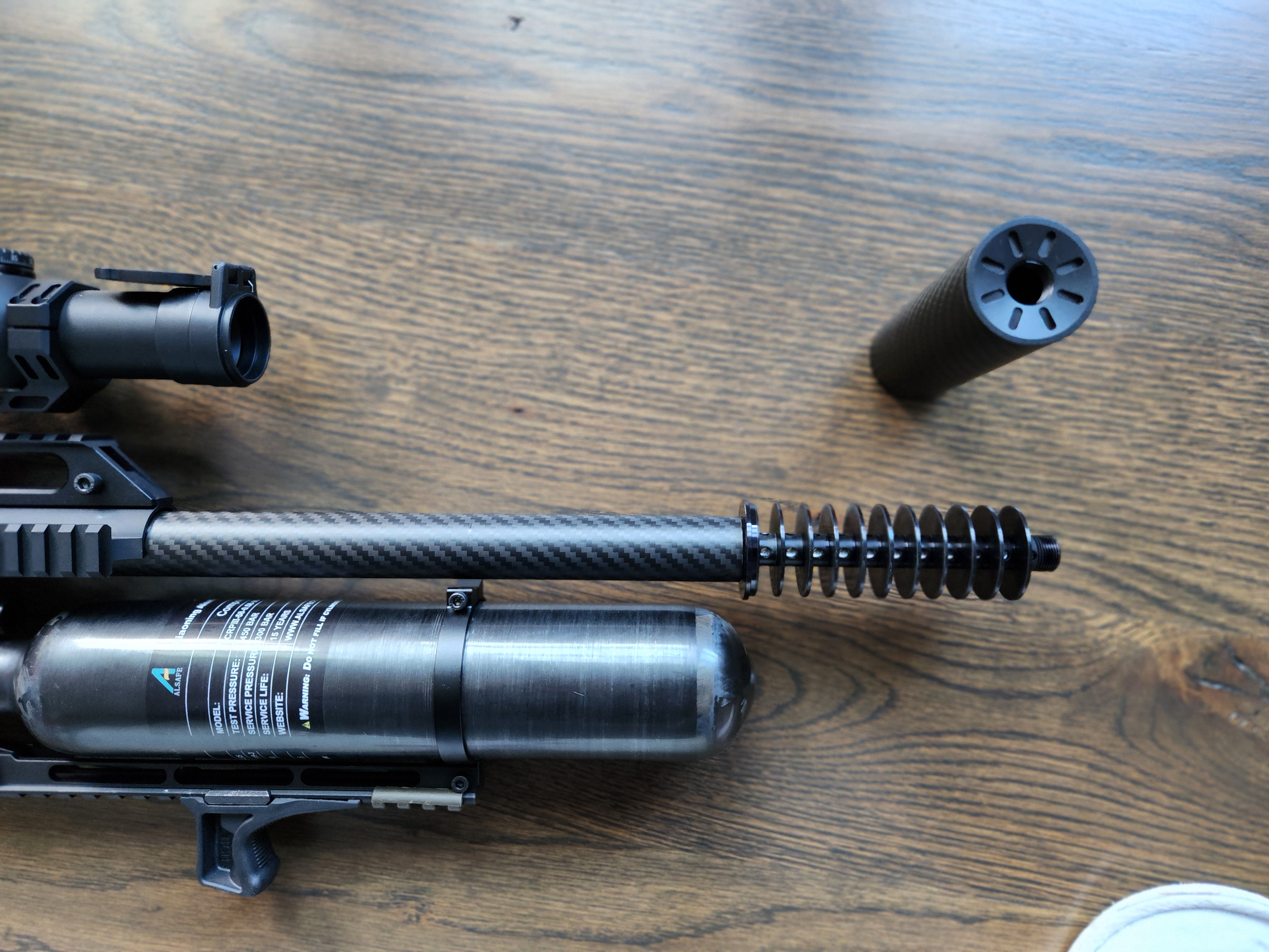

Are you using an after-market suppressor on your Sidewinder? I just ordered a 0db magnum for mine. I like 0db suppressors, they are small and light, and they do reduce the bark significantly.That's definitely reassuring. I hope they can get it back to you promptly. You're gonna like it!
So far I'm running mine stock. I didn't want to mess with anything too much till the warranty runs out. Didn't you say the shroud, and suppressor were somehow stuck together? I heard it somewhere, and didn't want to void my warranty by making any permanent changes. Though in the future a suppressor that actually gets the job done would be nice.Are you using an after-market suppressor on your Sidewinder? I just ordered a 0db magnum for mine. I like 0db suppressors, they are small and light, and they do reduce the bark significantly.

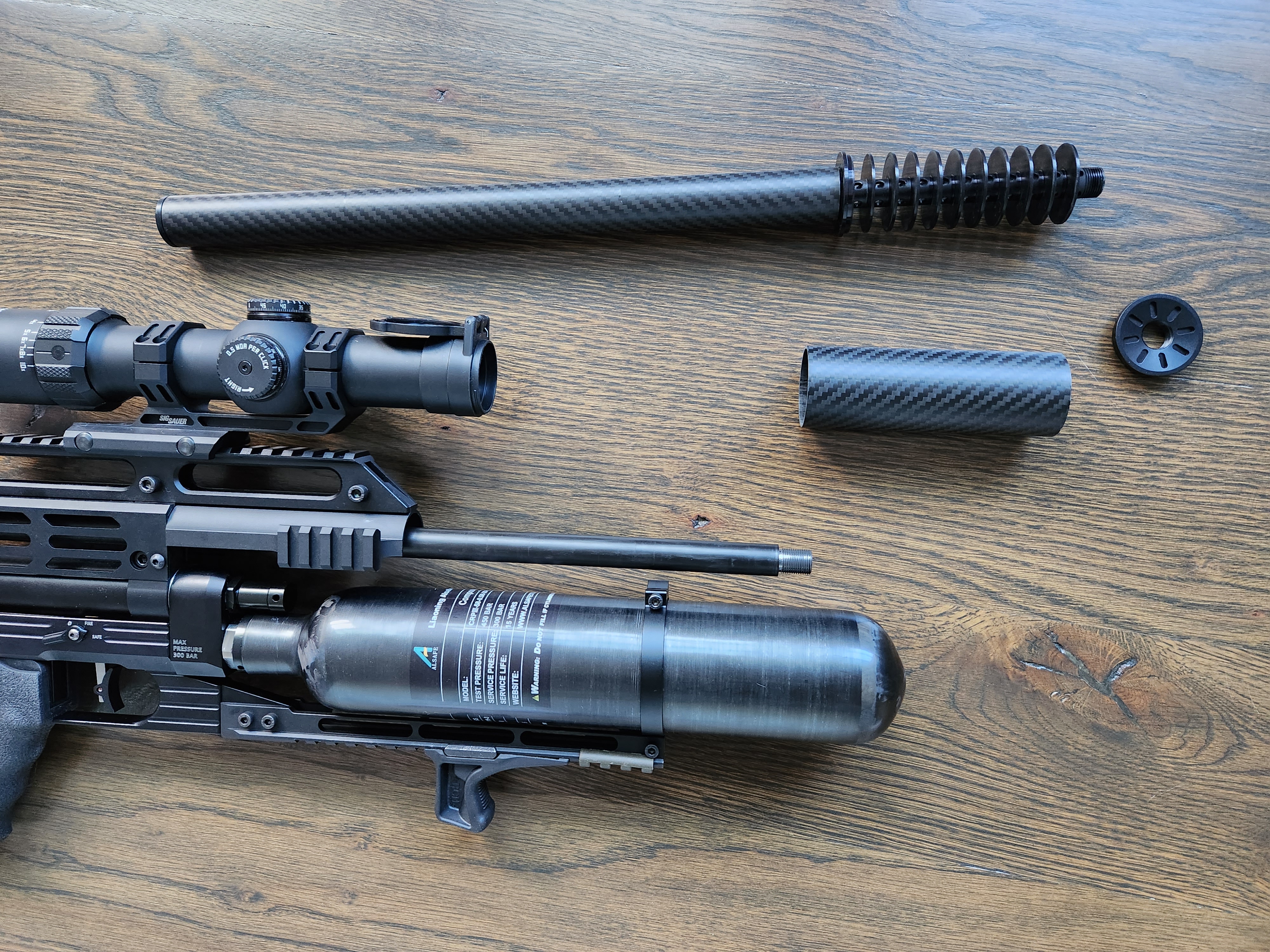

They are 2 pieces but put together. The shroud and the stock suppressor are linked so that the former is an expansion chamber. So if you wanna put an after market suppressor you need to cut the shroud to let the 1/2" barrel thread appear above the shroud so that you can screw in a quieter suppressor.So far I'm running mine stock. I didn't want to mess with anything too much till the warranty runs out. Didn't you say the shroud, and suppressor were somehow stuck together? I heard it somewhere, and didn't want to void my warranty by making any permanent changes. Though in the future a suppressor that actually gets the job done would be nice.
I'm probably not game for cutting my shroud. Perhaps I'll try another suppressor once an adapter hits the market. I'd have to be able to put the gun back into ite original configuration. When you sat "put together", how so? Simply screws together? Or is it glued, or something?They are 2 pieces but put together. The shroud and the stock suppressor are linked so that the former is an expansion chamber. So if you wanna put an after market suppressor you need to cut the shroud to let the 1/2" barrel thread appear above the shroud so that you can screw in a quieter suppressor.

Screwed togetherI'm probably not game for cutting my shroud. Perhaps I'll try another suppressor once an adapter hits the market. I'd have to be able to put the gun back into ite original configuration. When you sat "put together", how so? Simply screws together? Or is it glued, or something?
Thanks a lot for sharing your experience, I did not disassemble the barrel nor do I intend to. I just took off the shroud and the suppressor that comes screwed in it because I need a gun that is quiet enough for my backyard, and the Sidewinder definitely is not, that's why I took off the stock suppressor. I now know how to quell the bark. Will share when it's done.For what is worth... I can't recommend this little tidbit of info to be held more close to your heart...
Before you remove the barrel, Mark it!!! I used a diamond scribe to mark Center line and scribed a line at the point where the barrel is seated in the block.
This WILL save you future frustrations.
