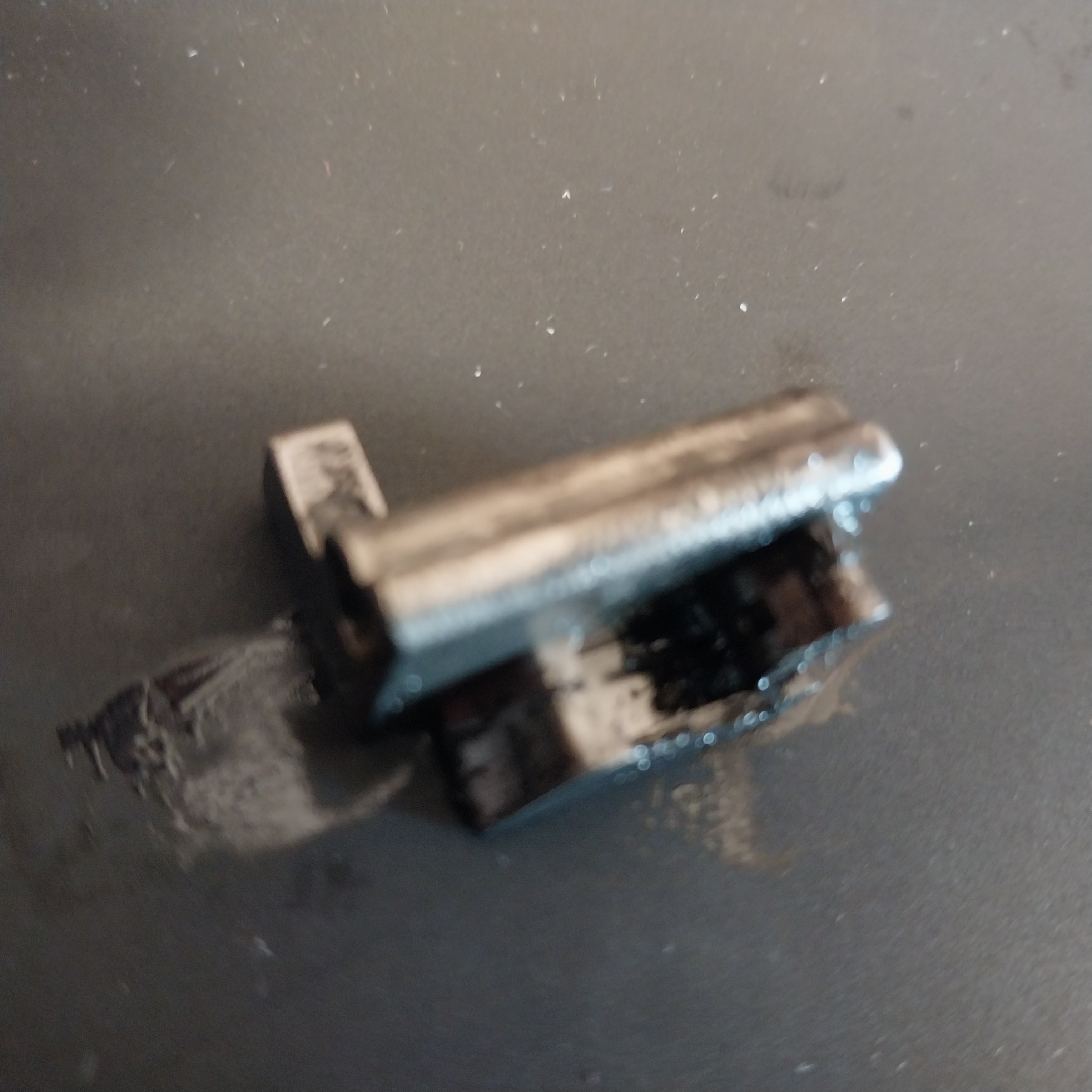

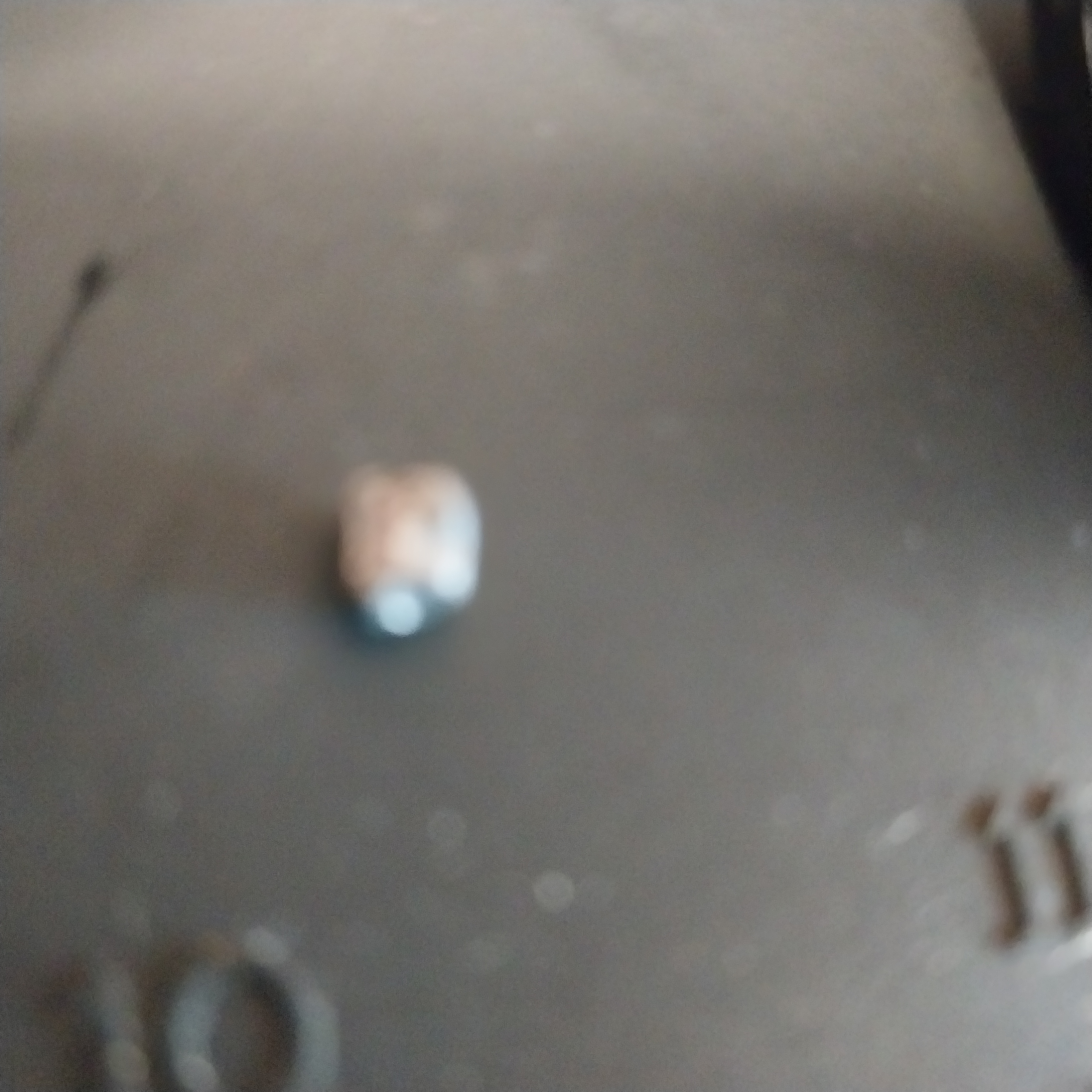

I had my gun jamming and also creeping after adjusting reg and it shot horribly now it is sub moa
so my multible issues were ,
1, ,mag accuater had lead in it causing jame
2, barrel was horrible I polished out flaws and re crowned
3, my regulator was rusted so bad when i adjusted it rust flaked off and got into delron seat , I al sure you have some of my issues ,
I now helped dozens with same issues as mine , they all have simular issues but can be fixed easily , why a company which sells these 2 models 2300 and almost 3k and wont even answer emails nor post diagrams is poor , many keep dumping guns cause of thisand they keep being resold until someone now does like I did and to be honest once you get into gun it is a simple gun , but it is intimadating with no diagrams and nothing out there to see , but like I said sk10 has videos out there messege me with issues
