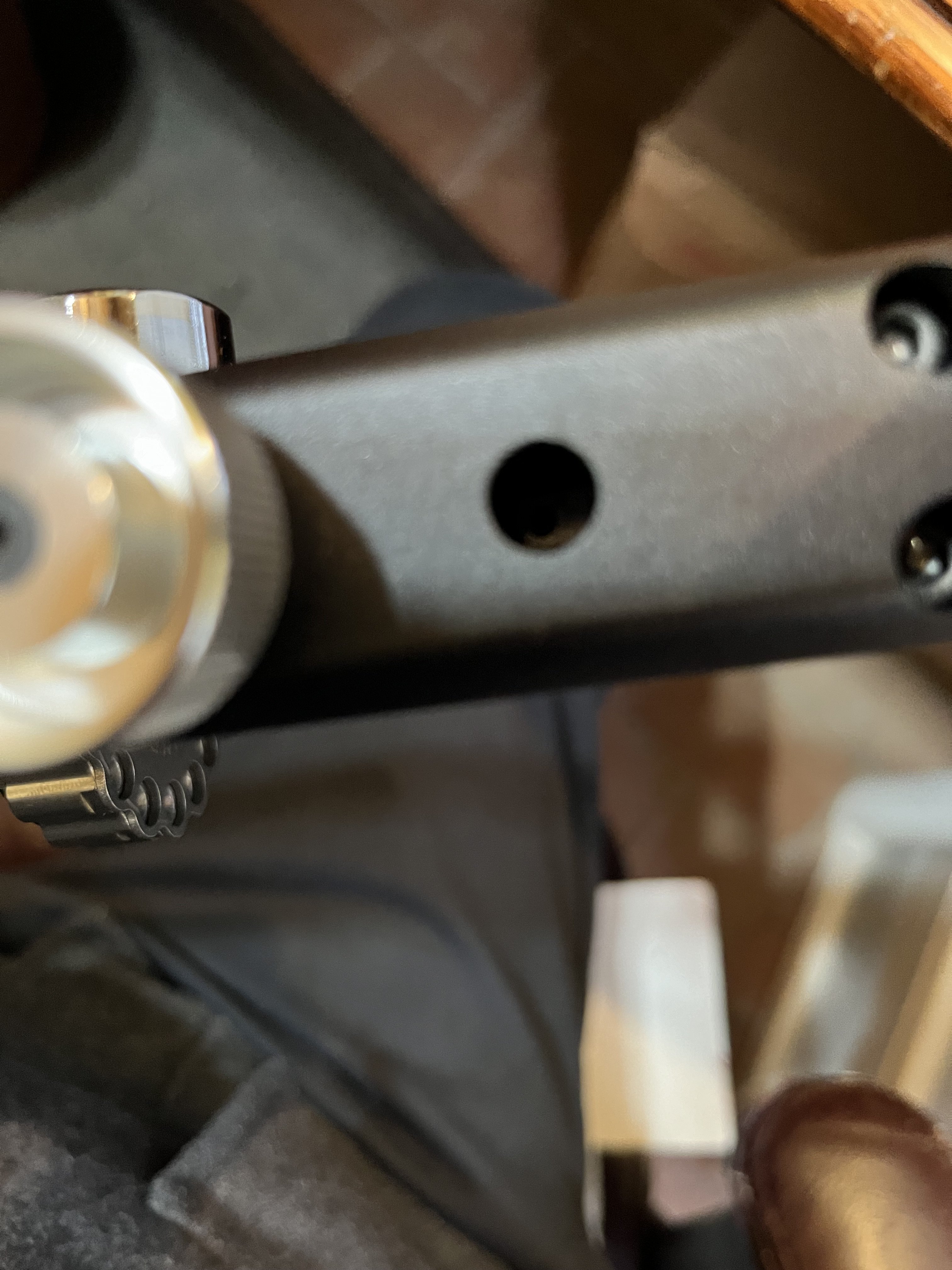

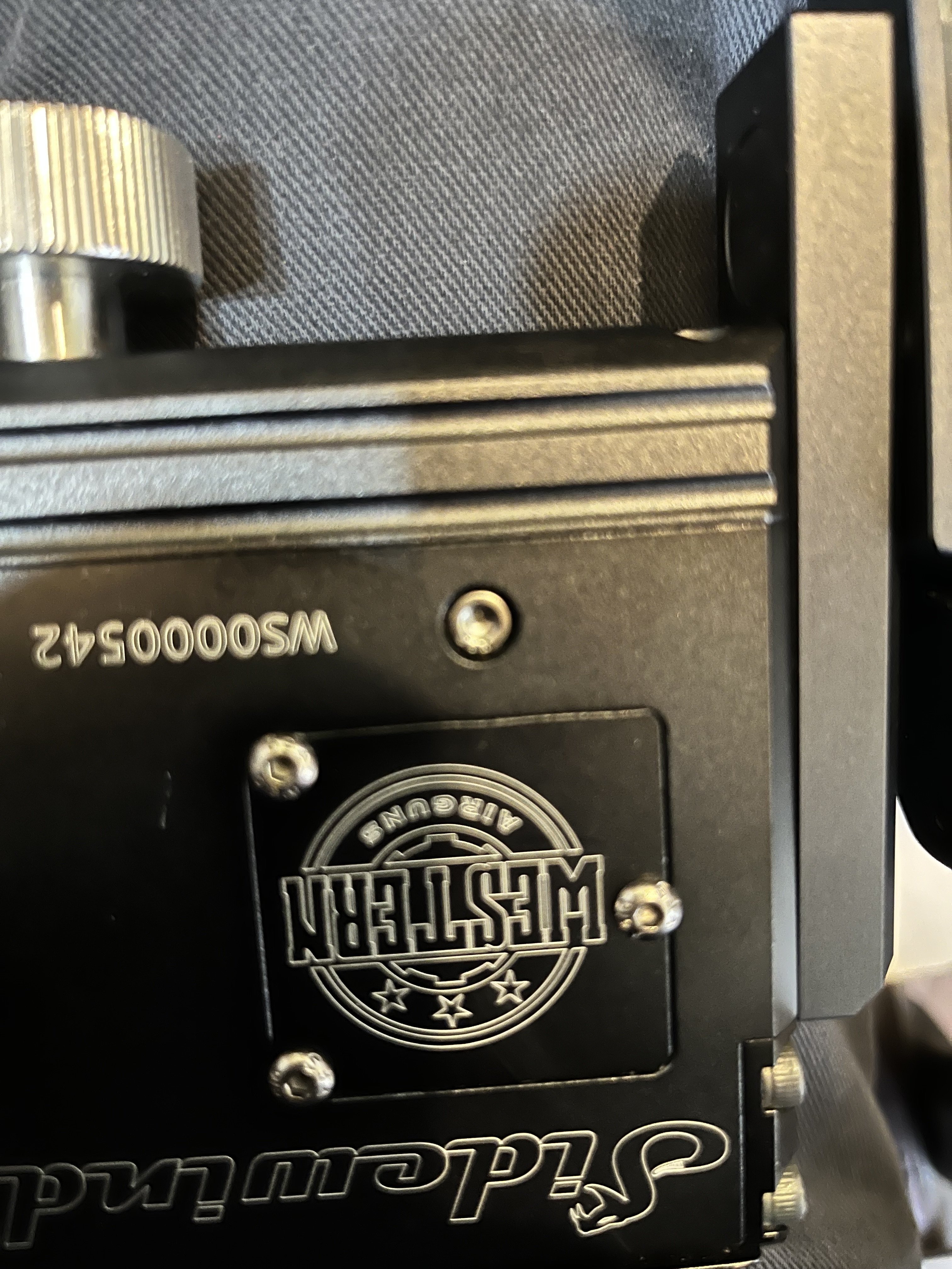

Just wondering if there’s a simple fix for the Western sidewinder trigger that doesn’t seem to be resetting. Gun won’t fire, but it’s not a feed issue.
My buddy just got the rifle, and after few shot strings the triggers stopped working. Gun is just dead.
Are we missing something?
He did go over the gun and tightened all the loose screws the night before this occurred. Not sure this means anything… but figured we would add this one fact. We also cleaned the barrel. Those two things are the only two things that changed before ..
Thank all

He might have tighten to much the bolt of the safety or without knowing he moved the adjuster of the trigger that should not be touched.
First try I would loose a little the bolt of the safety.
If it does work, then it should be convenient to know if he tighten any of this two screws and then try to leave them as to hey arrived:
View attachment 420814View attachment 420815
Thank you, I will look into this and get back to you.
