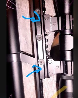

Well you can angle em you just have to kinda mount the scope rings to scope before you mount the rings to the rail so one ring can sit a tiny bit lower/higher on the rail its self an that cant damage scope tube. In the pic you can actually see one ring sits just a tiny bit higher than the other on the rail its self.
