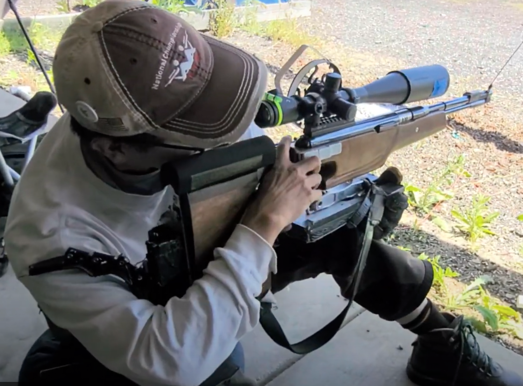

I was just reading WFTF Rules and I hope that more experienced WFTF shooters can provide clarifications/insights on butt hooks and shooting position.
Just wondering if my position is legal?
Here is my current shooting position. The rules seems to state that If there is a knee support and an additional shoulder support, my position is illegal. However if I adjust the top butt hook shoulder support up (providing no shoulder support), would my position then be legal?

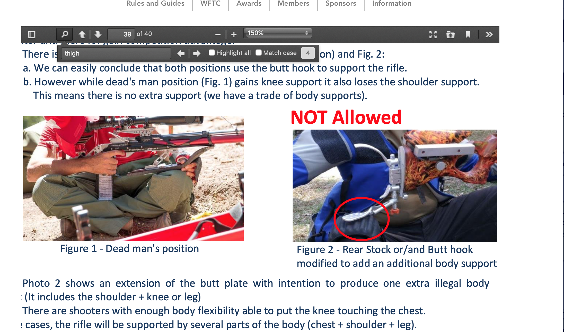

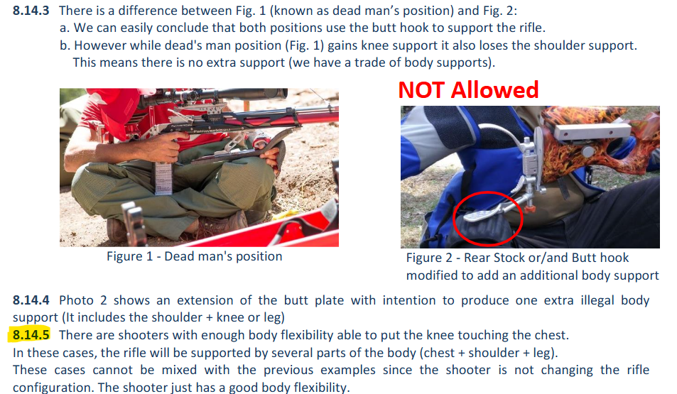

My interpretation is, as long as your hook isn't oriented in an obtuse way to make it sit on top of your knee, your position is fine. Also, your pictured position is not the deadman position as specifically noted in the rules. Seems rule 8.14.5 helps to clarify your pictured position to be good to go, and 8.14.7 to further clarify what is not allowed.

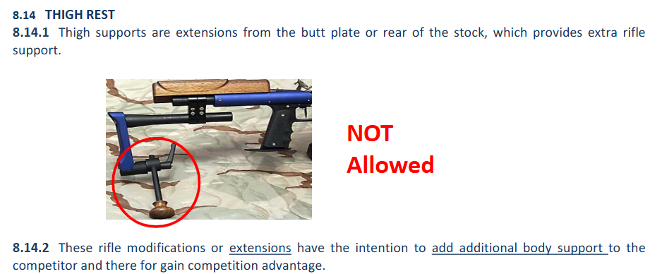

The rule section is specifically calling out thigh rests.
The " Bottom Butthook" is meant to be used in the standing position. It catches inside your armpit aiding in keeping the gun's muzzle up and as close to the point of aim as possible. Your supporting arm imparts the fulcrum, and subtle changes on the butthook or support arm can help in adjusting the point of aim.
The use of "thigh rests" has been banned and at the risk of making enemies, I'll say I agree with the decision. If what we seek is to add as much mechanical advantage in order to provide us with bench-like stability, we not only defeat the purpose of the " Field" portion of our discipline but we remove the basic tenants of marksmanship. Adding a butthook that is large enough that you can support it on your thigh and using it in that manner, turns it into a Thigh Rest.

I looked into this before going to the Worlds. As mentioned above the rest is only legal for the deadman position. If you have your right knee tucked into your armpit and your butt happens to rest on your knee it's kind of a gray area. And I believe they say it's due to being flexible so it's not to be penalized. If the butt extension sits anywhere except on your the top of the knee I think it may be deemed illegal, it may be illegal to rest it on top of the knee as well.
This was the one rule in the Worlds rule set that was difficult to understand with certainty.
To be sure I demonstrated my position and how things rested naturally to the RO to be sure it was 100% above board. Last thing I wanted to do was get DQ'd.

Thank you all for your responses.
Thank you Mike for pointing out that for a definitive answer, it's best to ask the people in charge of the rules.
and Seven Seven for reminding me the original tradition of "spirit of sportsmanship" within Field Target.
My intent wasn't to scrutinize the dead man's position.
The reason I brought this up was that other competitors have looked at my shooting position and the location of my lower butt hook and tried to argue that I was using my lower butt hook as a "thigh rest".
My interpretation of the current rules are that if the lower butt hook is on my right knee, I'm in a legal shooting position. I found a better picture of my current shooting position.
and maybe in the future adjust the upper butt hook straight up so that it offers no shoulder support? I agree about the advantages offered by multiple points of support.

I think the interpretation will come down to what the gun looks like when not in position. If you have the hook positioned much lower or out of alignment than what is normally expected, then I could see it being called a thigh rest. In your recent pic, the hook looks like it is placed in the shoulder as one would expect. The gun doesn't appear to be in contact with the leg, but there is nothing in the pic showing it is or isn't. As long as there aren't any odd gun configurations or accessories that help the gun get in contact with your knee, I'd claim you are OK. I am not a WFTF official.
As mentioned before, you should request a WFTF official to review your position and keep that documentation and pictures with you to handle any disputes. They may want to see a picture of the standalone gun in its configuration, and additional angles of the position to. What they will be assessing is "intent", and I think that will be determined by what the gun looks like.
