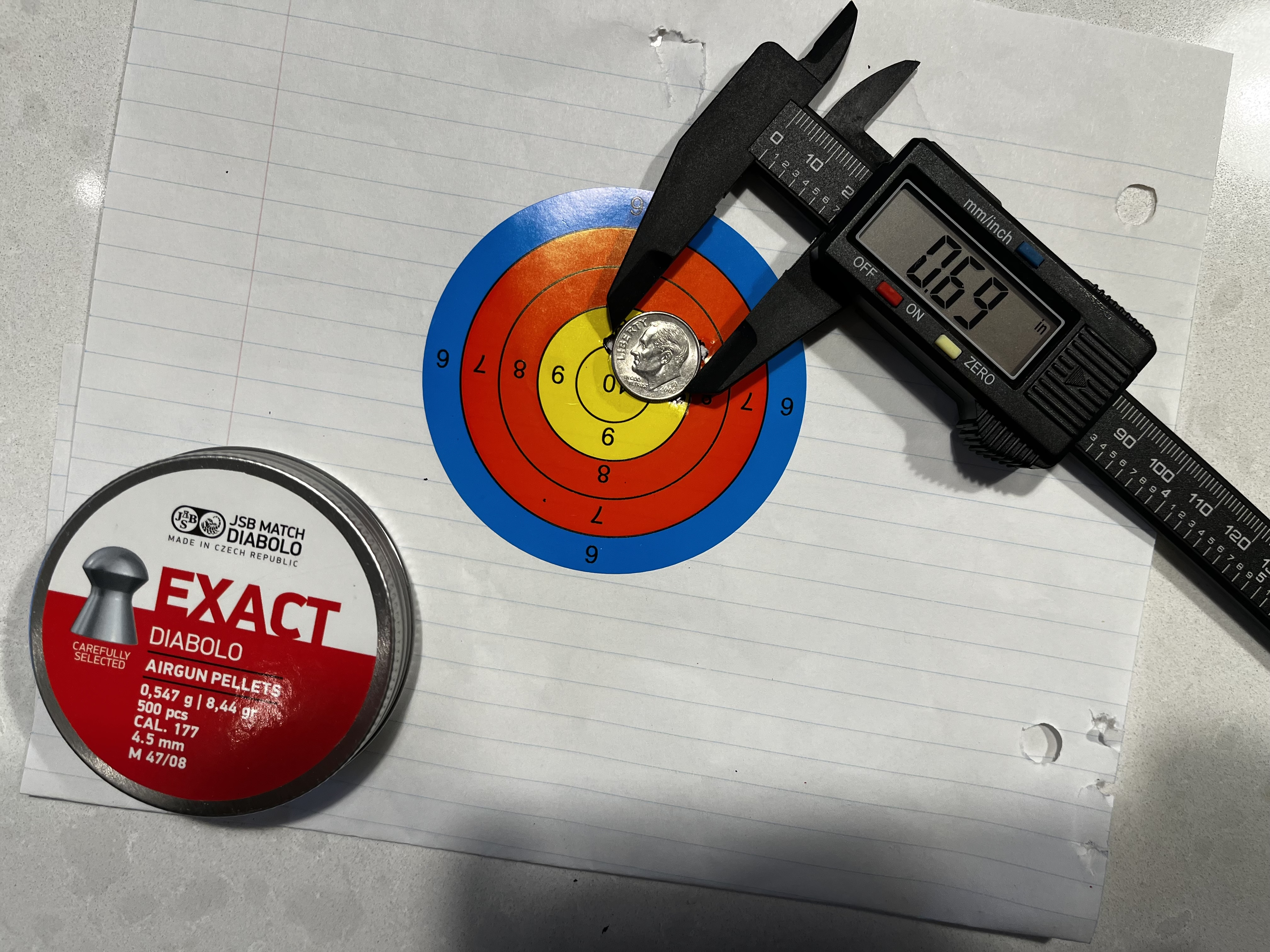

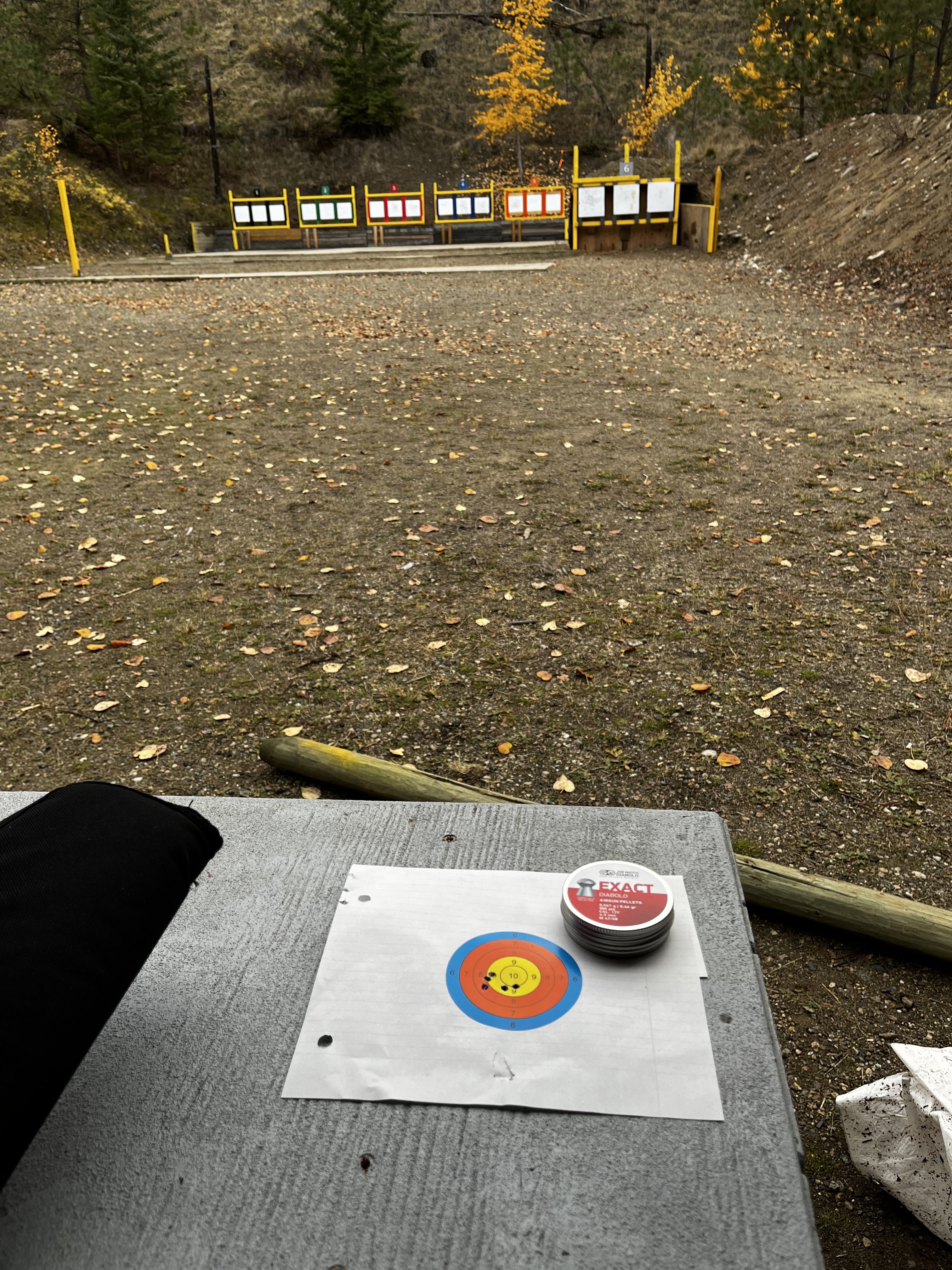

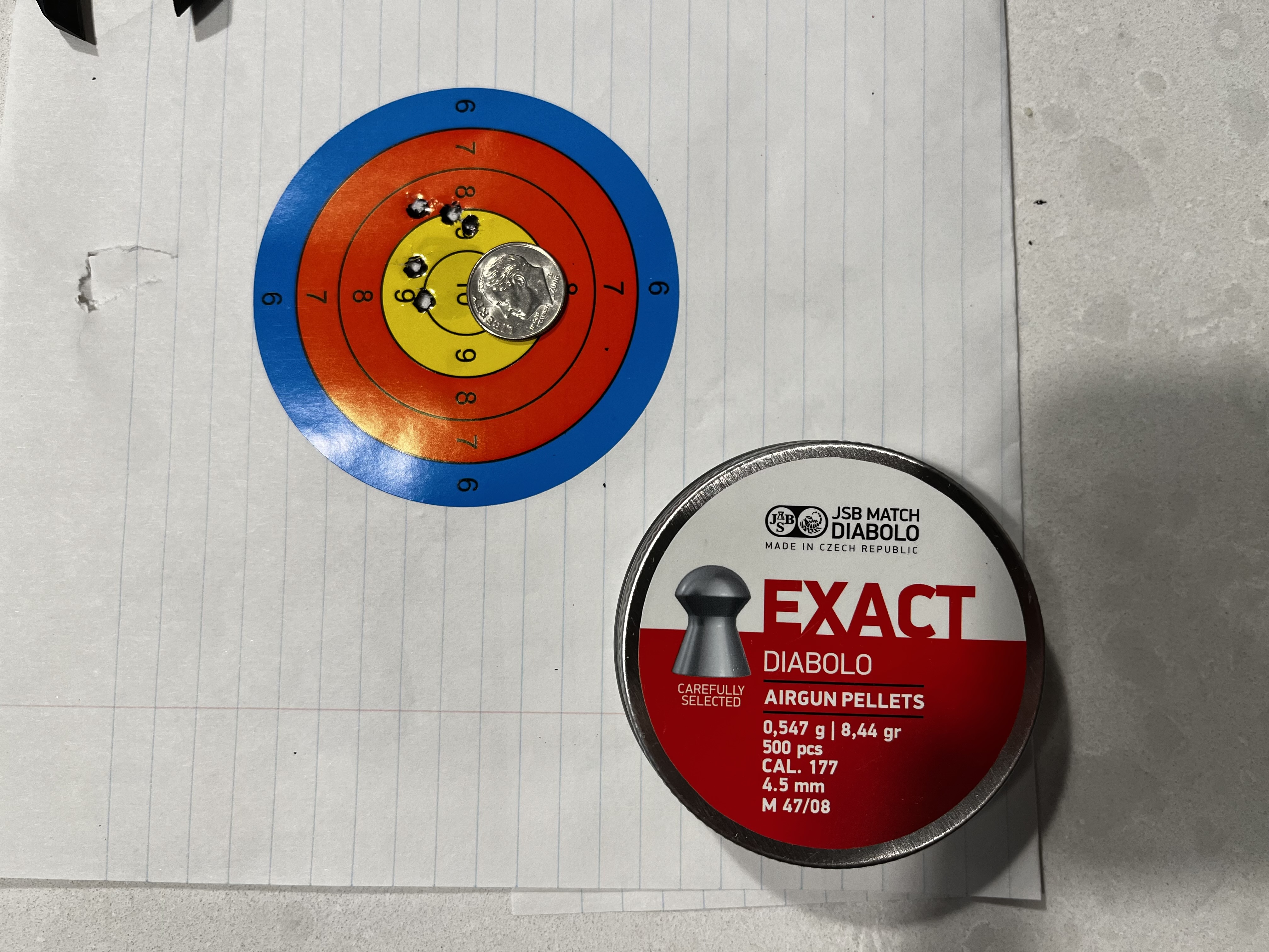

This is regular results at 50 yards with my HW30S .177.
What a range! There's nothing even close to that anywhere near where I live. I have only had my WH30 about a week but I too was trying to find out how accurate it is at distance and the consensus is on a calm day somewhere between 50 yards and 70 yards. 50 yards is good for me!
