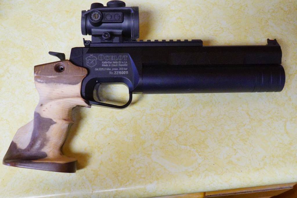

Here's my project if anyone is interested.
The bare wood is obviously where I've been removing material. A lot in some areas, a little in some areas. Took three tries to get it comfortable. The wing on the left side is almost gone now, it used to go all the way to the top of the grip. The slot for my trigger finger has been lowered and redirected so my finger has a much better shot at the trigger. The groove for my middle finger has been enlarged and lowered for room. The "odd" corners in the grip are gone. The grip was mostly square in the front. Now it's more round like a normal grip. The lower shelf has been lowered a bit to take the "squeeze" out of my fingers.
The grip is now painted in black truck bed paint. A little of a rough surface. Still drying, so I can't show it yet.
Interesting that the "wood" as shown on the grip, is NOT the wood grain of the grip. It's a very thick (about .01" thk), and hard. The actual grain of the wood goes in a different direction than the "wood" color !

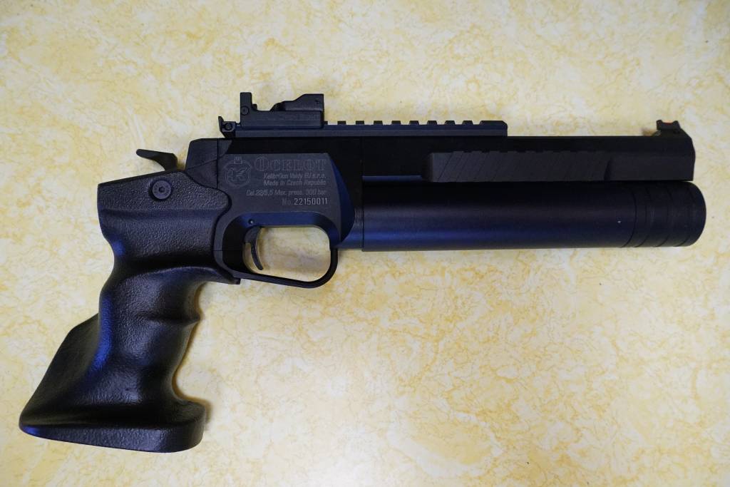

Current configuration.
Truck bed paint on the modified grip, a Mk3, SeeAll sight on top. It's taken a little practice, but I'm beginning to really like the SeeAll sights. The Tritium loaded versions are easily "seeable" in low (no) light, no batteries required. Just a coupla minutes under light, and it's ready to use for however long you want to shoot. I have three now, all of the "delta" (solid triangle) version. Just put the sight up so the point of the triangle is just below where you want to hit, there it is.
It'll stay this way for the foreseeable future.
