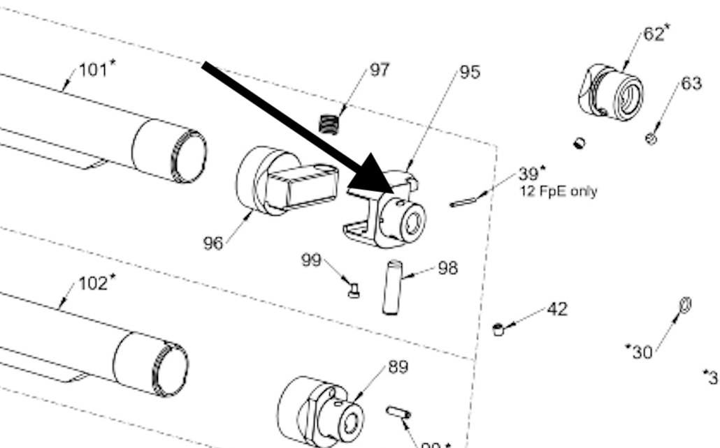

@Sky King I'm assuming you tried to turn the HS and it did not turn for you. It's because the white plastic screw holding in place was evidently too tight on yours. My Atomic has the exact same feature. All that's needed is to take apart the buttstock from the main body and back off the plastic screw holding it in place. I can tighten the plastic screw on mine enough to where it's very difficult to turn the HS. Below is a diagram showing where the screw resides. Wouldn't trade my Brocock for all your FX's.
