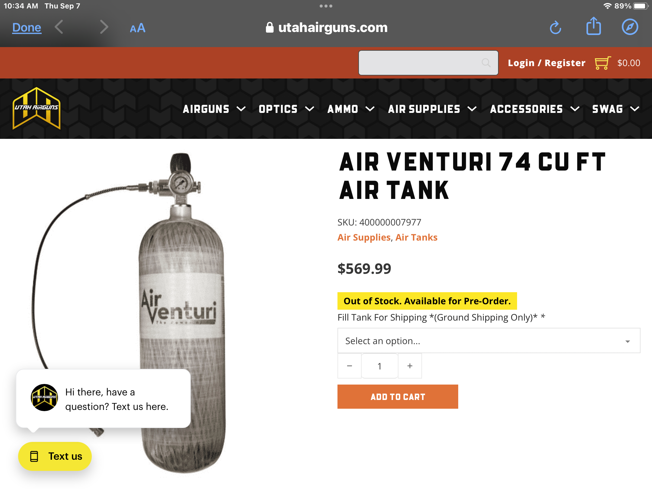

What adaptor if any would be needed to fill a 74cu ft tank from my local firehouse compressor? Is there a universal adaptor since all Scott tanks are used and filled at the firehouse? This would be tank and fitting I have.
Our Stainless Steel Firehouse to Stainless Steel Male DIN300 Adapter will allow you to fill ours, or any other Carbon Fiber or SCUBA tank that has a DIN300 valve.
STAINLESS STEEL Fire House Adapter (SCBA / CGA347 ) to Wrench-tight Male DIN300. Use this to fill my (and other) DIN300 Carbon Fiber and DIN300 SCUBA tanks at a fire house. MADE IN USA!
