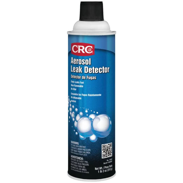

Great point! Coated rods, nylon brushes imho. A can of crc aerosol leak detector. You can use soap or windex and it's fine, this is just easier and cleaner for finding leaks for most. Fresh allen keys and screw drivers that fit right go a long way as well as a gun punch set of you need those like on an aea.
