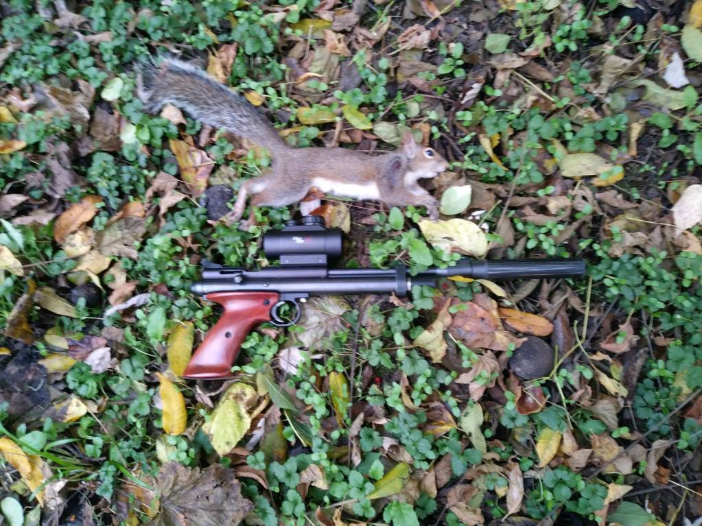

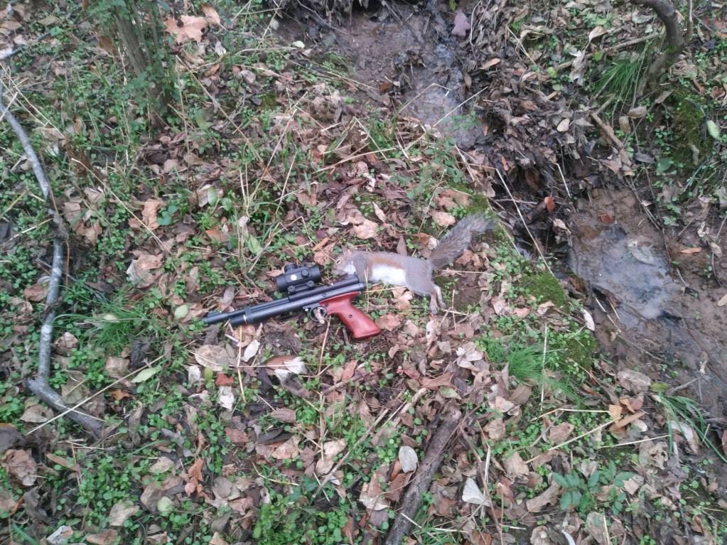

Have taken a few tree rats with a Crosman 2400 converted to hpa -
Depending on hammer spring adjustment, no problem getting enough power.
Rarely even try a shot further than 20 or so yards, and use any rest provided by nature when possible -

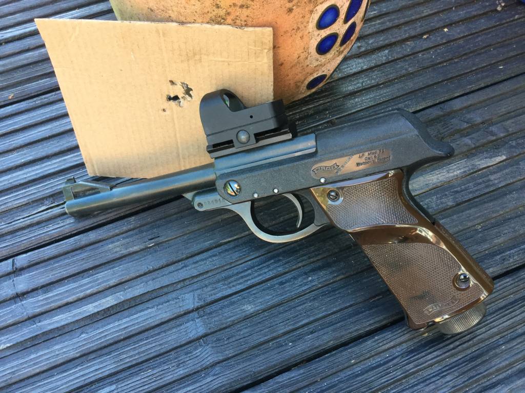

I use this. A fully modified LP53 which puts 10 shots into an Inch at 15 yds.
The muzzle velocity is 525 fps with AA or Falcon 8 grain domes which retain at least 450 fps at this absolute max (for me) range.
At 10 yds it delivers a good 485 fps at the point of impact and easily shooting into a sub 3/4 inch group, making it a realistic proposition for hunting pests at short range.....I personally would not attempt such shots with anything less, having modified this pistol to fit the purpose and practised with it until a high level of marksmanship was attained.
As regard slack jawed PC types that might disapprove...I could care less, but try penetration through both sides of a rats skull the last time it was used on one at 8 paces.
SteveV, I don't see a gauge setup on that pistol, how are you estimating in the charging of that?
Believe it or not up until around 25 years ago mostly all PCP guns didn't have manometers so you use the gauge on the tank or pump to fill and count your shots to know when it's time to refill. I have lots of old PCPs still without manometers.
