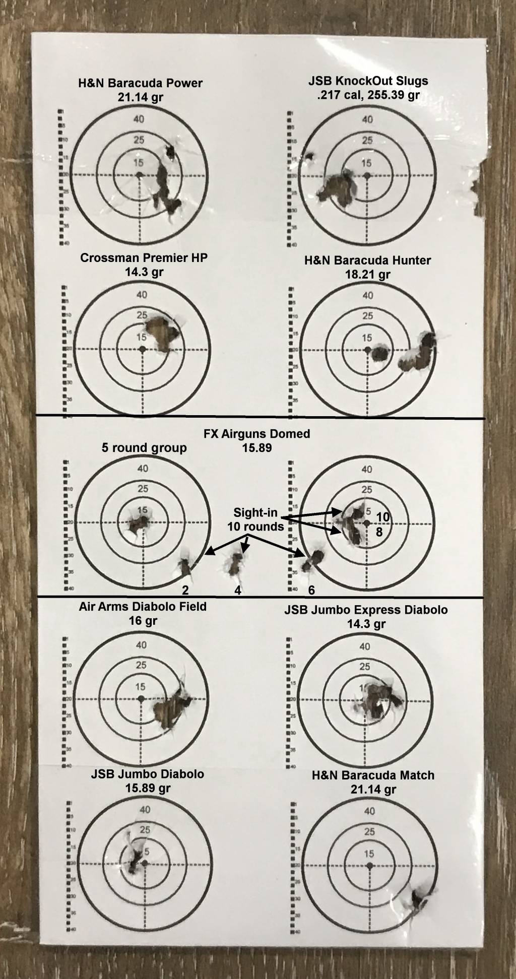

The gun is a great shooter, but every time I take it out back for some shooting fun, I have to start the shooting session with re-zeroing the scope. A couple days ago, I posted pics of some sub-1/2" groups shot at 25 yards. Today, I went back out, set up and loaded with the pellets this gun likes best, and it was hitting 1/2" low and 2" left. Once dialed back in, it sent everything I fed it into nice tight groups.
In my last thread, someone had mentioned removing the barrel band. I don't fully understand the concept, but I need to try something. I bought this gun for varmint control (chipmunks and squirrels) and most of that activity will be shot from the second floor of the house into the back yard. My fear however, it that by the time I take the gun back to the house and stand it next to the window, it will have already lost zero.
Here's a pic of today's fun, but it began with sighting-in the FX 15.89s shown in the center of the target sheet.

1.) I refill to around 200 bar every fill and get 30 good shots. The first 5 shots on a fill often shoot a slightly looser group. This isn't a loose group. This is POI shift. Note the center row in my photo where I zeroed the scope. Each 2 shot group was pellet on pellet. I was aiming at the target on the right (marked FX Airguns Domed).
Also, these were not the first shots of the session. I had shot one full air cylinder, 30 pellets at another target set at 50 yards. All grouped well, just not on the bullseye.

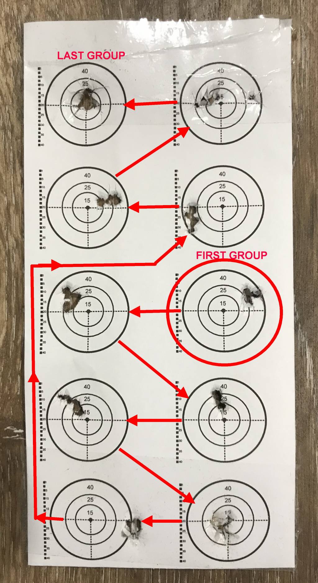

Scope mounts are/were tight and secure.
I pushed, pulled and twisted the barrel as directed and I did not detect any movement where the barrel mounts to the action.
BUT... the following 10 groups were shot and POI adjusted by pushing the barrel in one direction or another. I very purposely moved the POI back to zero 2 times during this exercise, and never took the covers off the scope turrets. All adjustments were made by moving the barrel!
Can this be fixed? How can I affix the barrel to the action so it doesn't move so easily???

You can try to wedge a thin piece of material such as a feeler gauge Or make your own out of sheet metal door stop wedge in between the barrel and barrel band in 2 or more points to force it to stay in the proper position.
From my experience, your not going to stop the barrel from moving when bumped. What my goal was, is, to get the barrel to return to its natural position when pressure is released. The band restricts this on the Urban and Coyote. On my rifle, the band held the barrel below its natural position.
to remove the band on my rifle, I had to remove the breach / action from the air tube due to the barrel mounting set screws being on the bottom side of the breach.
The action is not as rigid as you might think. It flexes enough to throw off your groups. By moving the forward scope mount as far forward as you can, your using the scope as a stressed member of the assembly, reducing flex of the structure. This mainly helps once the barrel band is removed.
