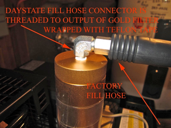

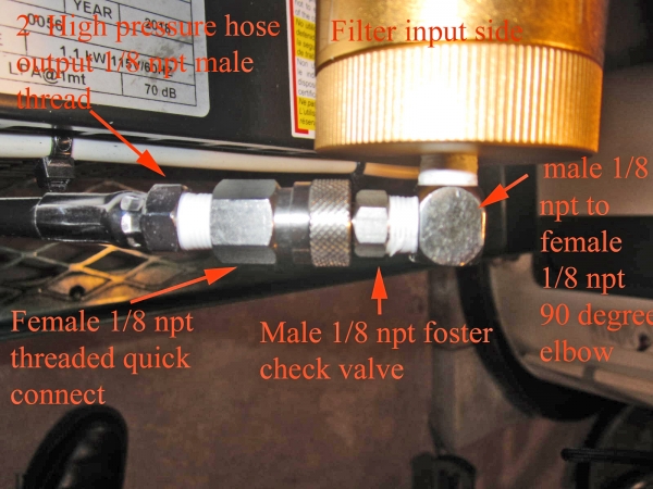

Both ends of all brands of gold filte end caps are M10x1 metric female threaded. I am as cautious as anyone else about mixing thread types, Centercut and I have had no issues whatsoever using male 1/8NPT male fittings to connect to the gold filter M10x1 female endcaps using teflon tape and threading them on tight. I use a gold filter standing upright on a Daystate LC-110 compressor. I use 1/8NPT male right angle fittings connecting to the top and bottom female M10x1 end cap threads.

Here are photos of my gold filter using 1/8NPT male 90 degree fittings.
Concur with @humdinger - I've been operating just as he describes above for well over a year and a half, and many hours (15 hours) run time on my "gold" filter. On the Tuxing and the other brand, they have the M10*1 threads. Say what you will, but its been proven out my both @humdinger and myself.
