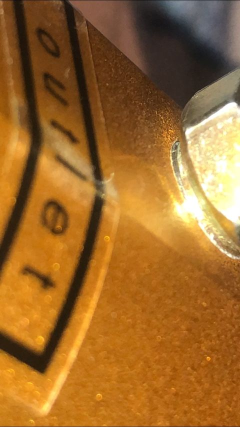

Hey can you show me a close up under the light of your threads of your bleed valve, and your air outlet like photos here I want to see if you have teflon tape on your thread or is it just me, I dont know if the seller did me dirty an gave me a bad one or someone returned a unit an he sent it to me or whatever but I dont give a poop as long as it works an wont leak im boutta leak test it make sure it aint a leaker il hand pump it to like 4000 an wait like 10 minutes or so.

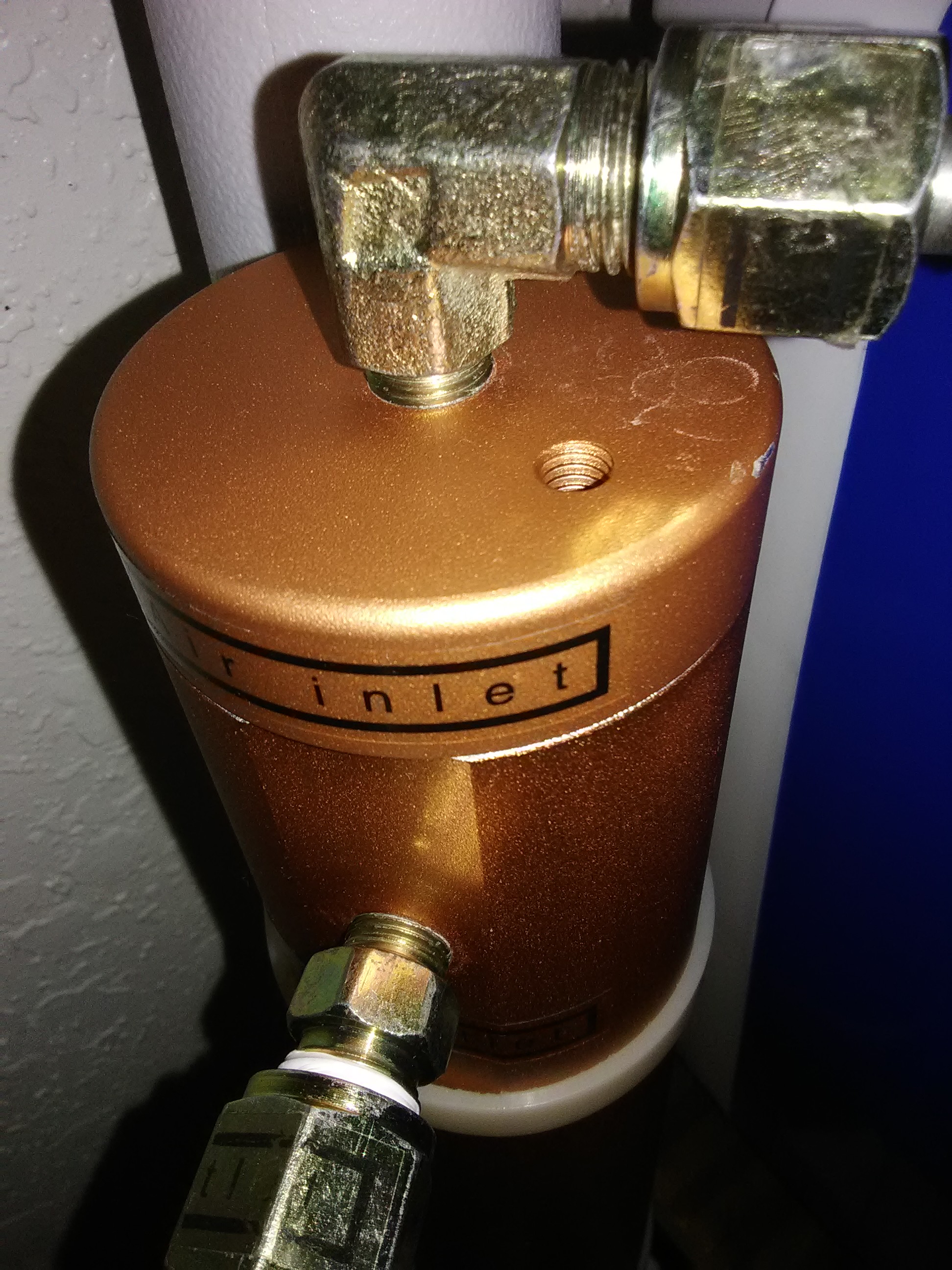

Sure, only tape on mine is on outer threads. Recently did a dead-head pressure test and found leaks here, surprised since sealing should be from round head of pressure hose to inside filter's cone-shaped fitting. Thread condition was fine and tightened as far as possible, took two inches of 1/2 inch thread tape, folded once, lengthwise, which sealed top fitting, exit fitting took an additional 2 inches of tape to seal. WM
Sure, only tape on mine is on outer threads. Recently did a dead-head pressure test and found leaks here, surprised since sealing should be from round head of pressure hose to inside filter's cone-shaped fitting. Thread condition was fine and tightened as far as possible, took two inches of 1/2 inch thread tape, folded once, lengthwise, which sealed top fitting, exit fitting took an additional 2 inches of tape to seal. WMView attachment 355394

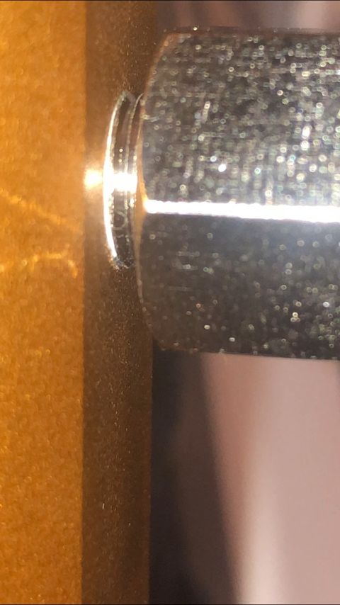

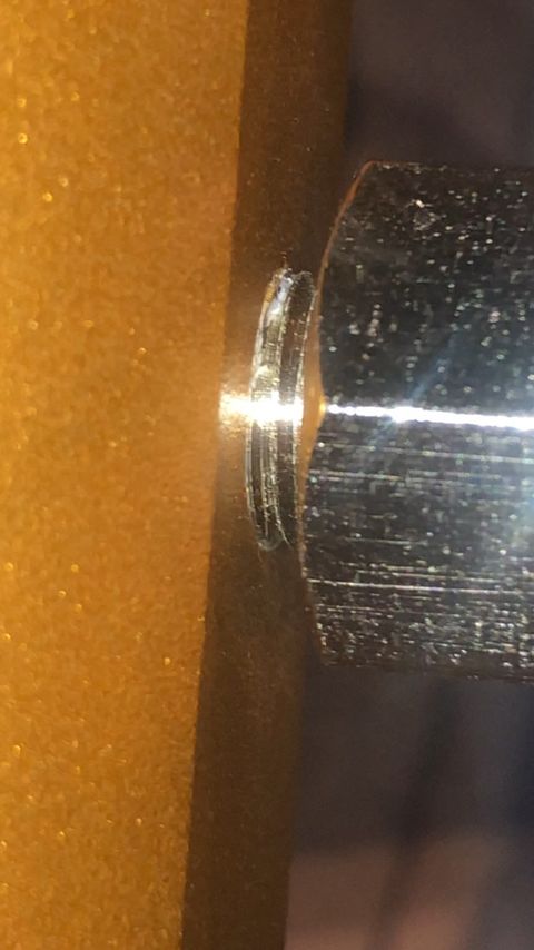

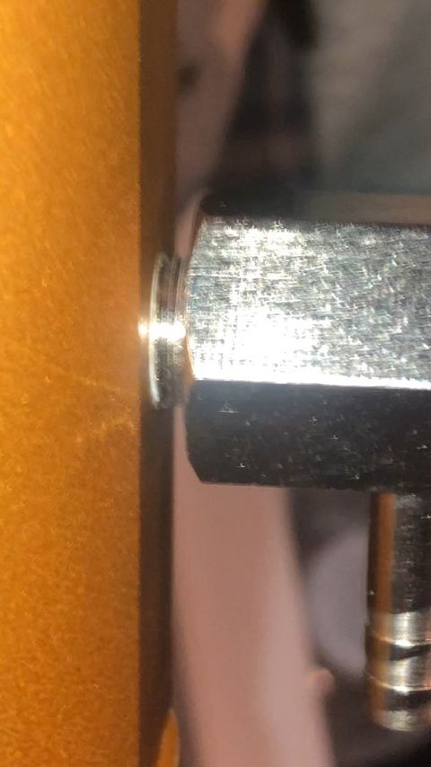

Looks like you have a bit of teflon in there too I guess im all good, But the pic you posted, I pumped this thing to 4100, Its like pumping up a gun maybe around 120 cc or so from zero to 4050 ish, But the first time I pumped it I found that it would leak air from these threads in the picture as you can see where the fill whip threads into the inlet nut, So After the first time pumping it up I was like hmm okay Il tighten that down an try again an I felt like I did it tight but not like no where near as tight as I can but tight, Imma tighten it down one last time not crazy dumb but the hardest I will, but If that dont do it I guess il teflon tape that spot I see you teflon taped the one on the side, funny for me that one for me I just snugged up and it didnt leak at all, But the top fill whip leaked even when put like 30% more tork in the top one than the lower one an still leak. One last test though before teflon Im done pumping this thing up, really shows how strong compressors are comparred to air pumps its like WOW, Here is that pic where im getting the leak, The first time when it gets around 4000 you can hear it an actually even feel a tiny small breeze despite tightening it down the same tork as like the one you got tefloned up. Such a hot day today may 10th around 80 in washington, What am I in california? its suppose to be around 90 may 15th I dont wanna even see july Im so glad I got a compressor handpumping with no ac busting into fat sweat everytime to shoot aint no fun.
Stripped threads on those fittings isn't rare, mostly, I think, owners find leaks and try to torque their way out of it. I can finger tighten mine till seated, then, after a nudge with wrench, if it still leaks, Teflon thread. Both mine have Teflon tape, top took only small amount to seal, exit fitting took more. I've never removed fittings that actually thread into filter housing. WM

Hmm, Yeah Im not gonna bother taking eather whatever its no big deal if fibers go free its all good I got a blue filter so nothing would get past an get in the gun it says to please not disassemble the filter by yourself this can affect the air sealing so im not trying to do that unless I must an this aint a must so, I bet you could seal it back up just as it was new if you where to take it apart as long as you got some teflon tap and some silicone grease if anything leaks. I just also did the leak test after tightening it down real snug and 18 minutes in 4350 psi its not leaking so im glad its all good cant wait to get my yong heng now.
