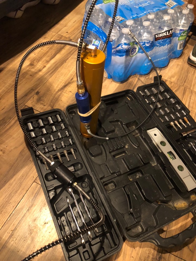

What are those strands in my brand new copper filter an I see these white strands inside both air holes
Weird anyone else have this? Brand new filter some kind of white strands inside. https://www.ebay.com/itm/192985783901
Stripped threads on those fittings isn't rare, mostly, I think, owners find leaks and try to torque their way out of it. I can finger tighten mine till seated, then, after a nudge with wrench, if it still leaks, Teflon thread. Both mine have Teflon tape, top took only small amount to seal, exit fitting took more. I've never removed fittings that actually thread into filter housing. WM
So I should watch out when tightening down hard you said stripped threads aint rare?.
Yes, better, in my opinion, to use Teflon rather than risk stripped threads. Owners often ruin threads trying to stop leaks, don't fall into that trap. WM
Thanks for the tip il be careful, So for future if I ever take it off should I just teflon tape it an not snug it like I did today, I dont want to overcrank it , I aint tryna strip the threads on mine, But it seems to have solved it 18 minutes at 4350 psi no movement thats pretty good 4350 is high pressure I dont even think il run my yong heng for 18 minutes ever at a time max around like 10 or so bottle has to cool off and the yong heng does so aint no reason to run it crazy. But my yong is out for delivery fedex right now Bottle coming friday I gotta still go to home depot an buy a lid an that full husky synthetic, also my secolube is out for delivery ups right now, acecare bottle is moving is the slowest ups says friday, Im thinking saturday imma shoot. I bought a water pump thats way better as well around 600 gph or so should keep it cool in this dumb heat

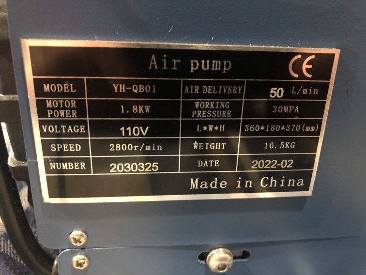

Is mine legit what are your thoughs? I got it from walmart added on 3 year allstate insurance So even if its fake bring it on compressor allstate gon cover it I guess but I think its real.

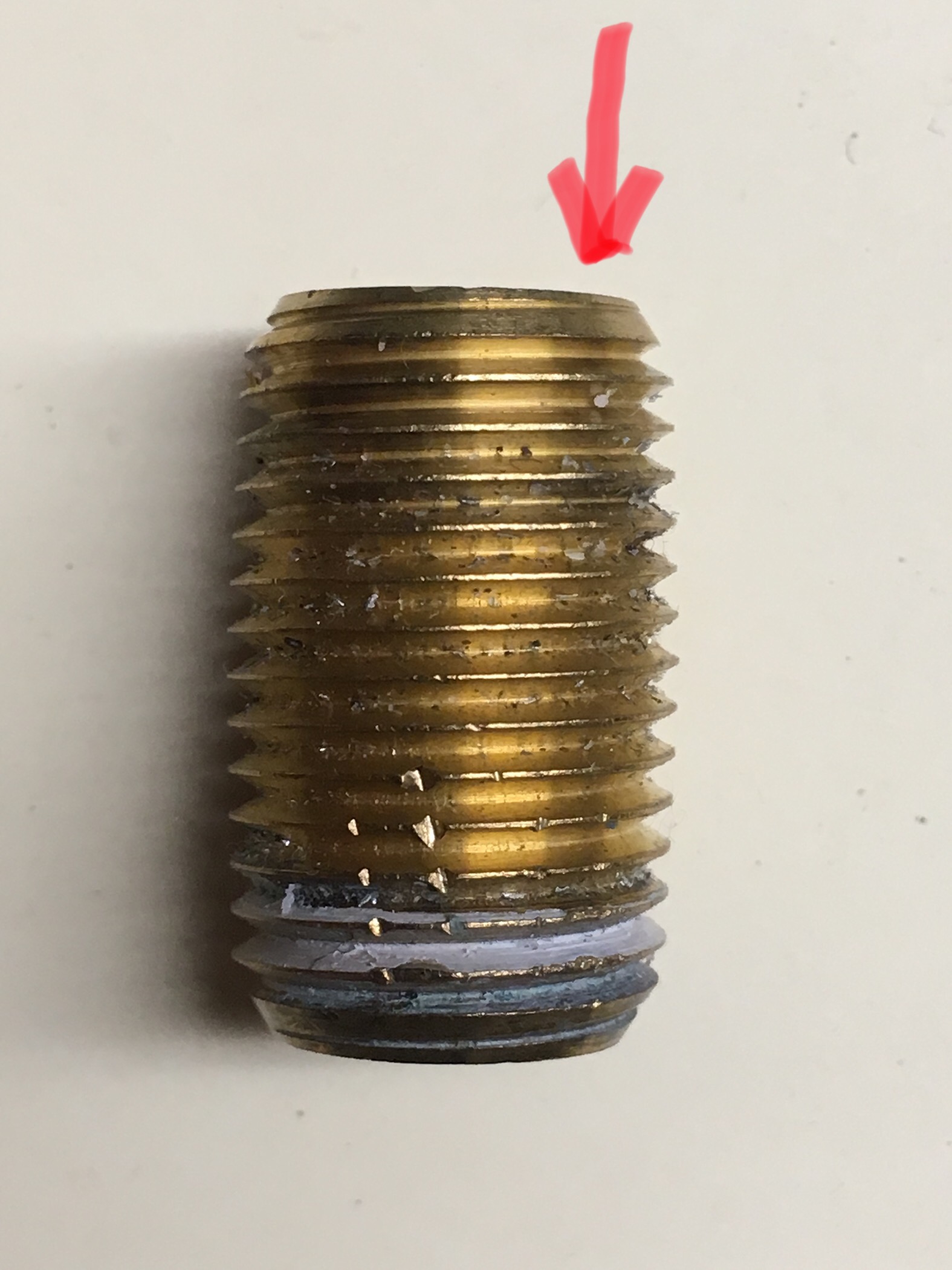

Teflon tape should NEVER overhang the end of the male threaded fitting. The tape should be approximately one turn back from the very start of the thread. Any teflon tape that might be hanging over the end of the thread could end up traveling through your system. If a tiny piece ever gets between a sealing surface like in a check valve it will never seal. The photo below shows the very start of the tapered thread. Your taping should start one revolution back from that point so no tape over hangs the end of the fitting. You should have a little tension on the tape as you wrap so that it sort of conforms to the thread form. Swagelok recommends two to three wraps.
Teflon tape is never ever used on straight threads.

Two years back, when I bought, was told authentic had, "Yongiheng Pneumatic Company" listed on label with white YONG HENG printed on side. Did Walmart list who built it? I'd use it, got a three-year warranty so no worries for at least that long. WMView attachment 355553
MarksmanPete
Similar to what WorriedMan said my research turned up that the legit Yong Heng compressors supposedly have the YONGIHENG PNEUMATIC COMPANY on the placard. The one I purchase had it on the identification plate.
-PJ

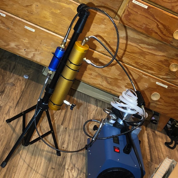

I dont even got a check valve the on my bottle automatically opens when the pressure gets over the bottles pressure an it doesent let air back out, Here is kinda what my setup will look like, I got a tuxing filter coming Il replace blue on with. here is my valve https://airgunarcheryfun.ca/m18x1-5...-station-with-400bar-6000psi-gauge-50cm-hose/
Reactions: WorriedMan
Im excited to run the compressor im just checking making sure im not forgeting anything, I drained out the little bit of old oil that was left an added like half an oz of husky full synthetic an picked up the compressor an swished it around like a wine glass a bit to get any of whatever garbage oil thats in there out, then I drained the bit of husky I put in no more than .75 of an oz an filled it perfect halfway in between the dot So not all left to do is run it water cooled 5 minutes ups had my bottle its only couple miles away they should have delivered it today based on all the packaged I track when they have it just in the next suburb/town over 5 miles away that morning you usually get it that day but I didnt so tomorrow, I want to let the yong run for 5 mins an then hook it to my acecare with zero psi in it dont wanna fatigue the motor first use. here is my setup, Im glad I got a tripod makes it so I can take the air rig in any room if one room is hot il go over next room or whatever if I need to or lower humidity room thats why I got a tripod Il run the tuxing on that once that comes tomorrow I mean Ive got is all down.
My mentioning of a check valve was to illustrate where a stray piece of teflon tape can lodge and prevent designed operation. I don’t know where in your pneumatic circuit where you’re seeing contamination. If it’s after the compressor valves it most likely doesn’t matter, especially since you have a couple filters post compression. Happy shooting.
