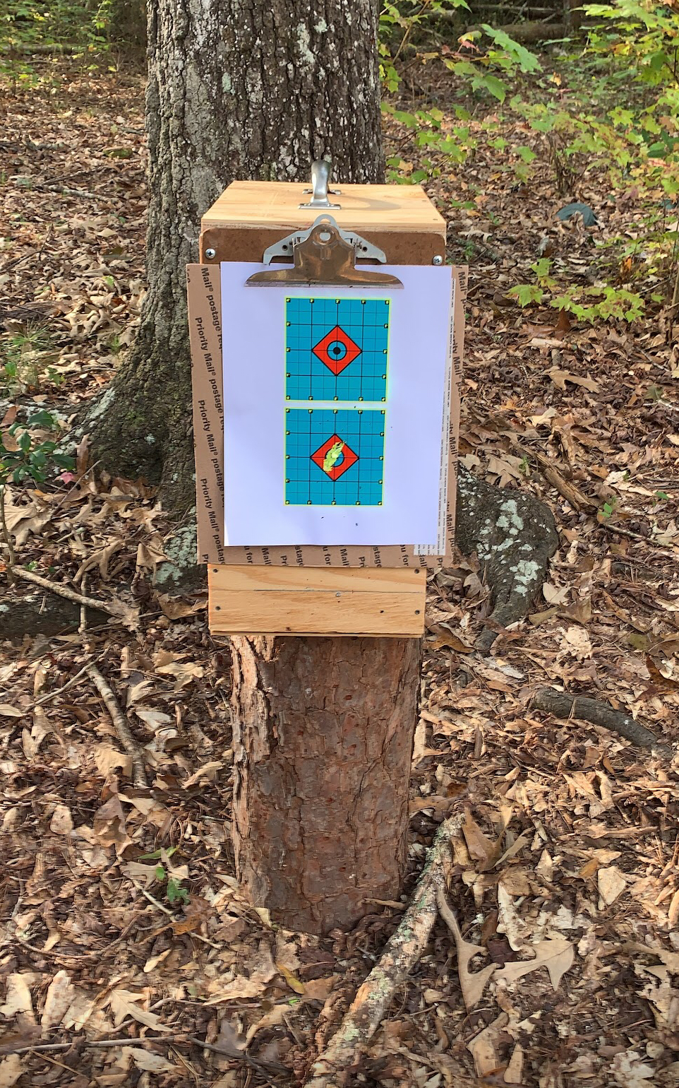

I used a clipboard to clamp printer paper with peel and stick targets with center cutout so pellets pass through and stop in duct seal that is on the back inside. Quiet and not expensive. I used 4 of the duct seals installed a handle on top.

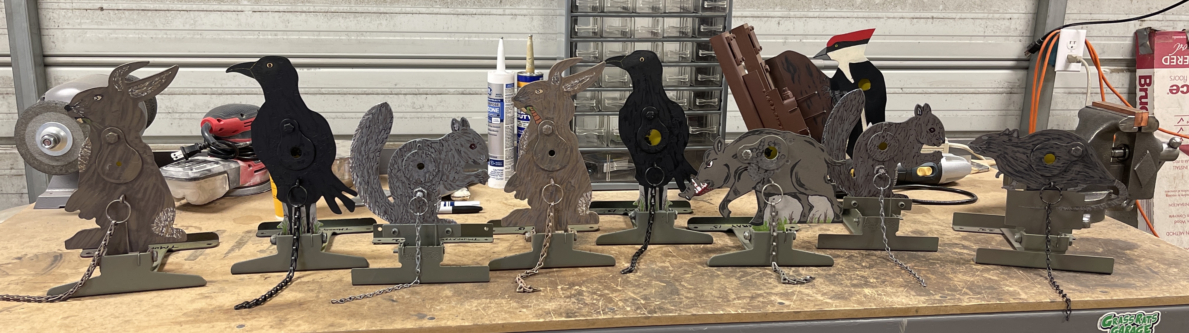

My current collection, hope to get more. Would like to get some Dick Otten targets.
MDT - Mikes Dandy Targets and S&S Targets - Phoenix AZ.

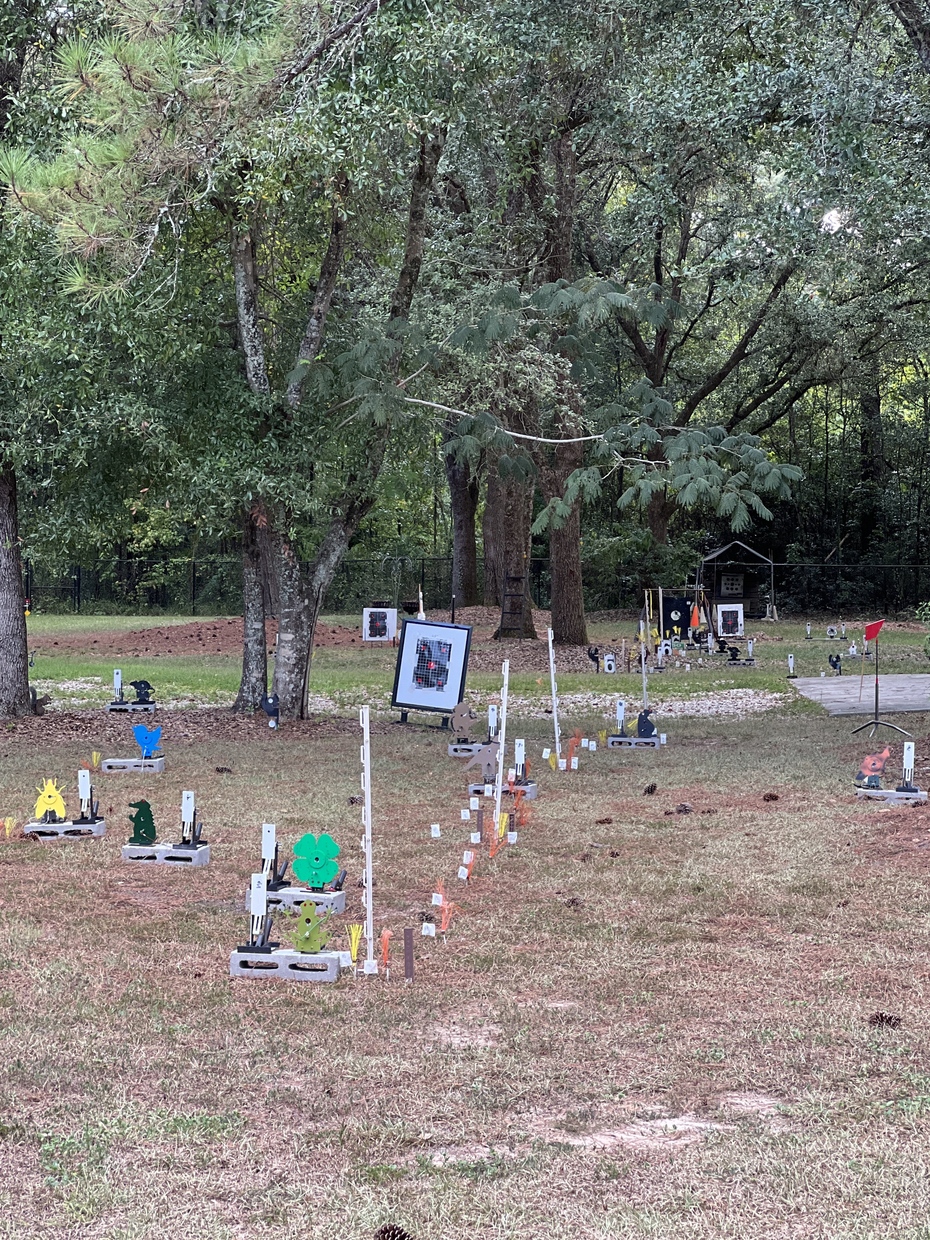

my back yard looks like i live in a remote country trailer park of some sort.
Notice the REAL squirrel sitting at the base of the tree... brave soul he is.

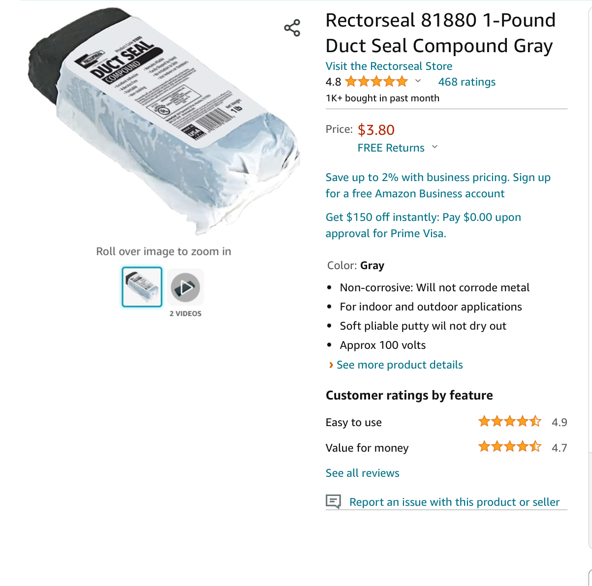

Hey, thanks very much for including the Amazon.com ad for the clay! Compared to what gets called 'ballistic' clay these days, the duct sealant is practically free (well... <grin>). Anyway, it should be a very practical and affordable substance with which to fill just about any sort of pellet trap. Seriously, thank you very much for the help!
