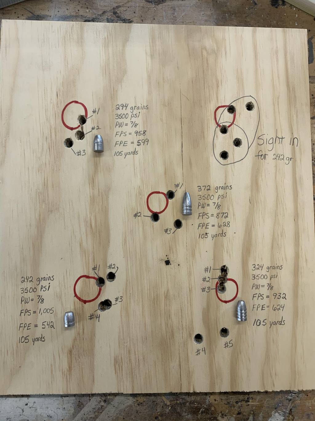

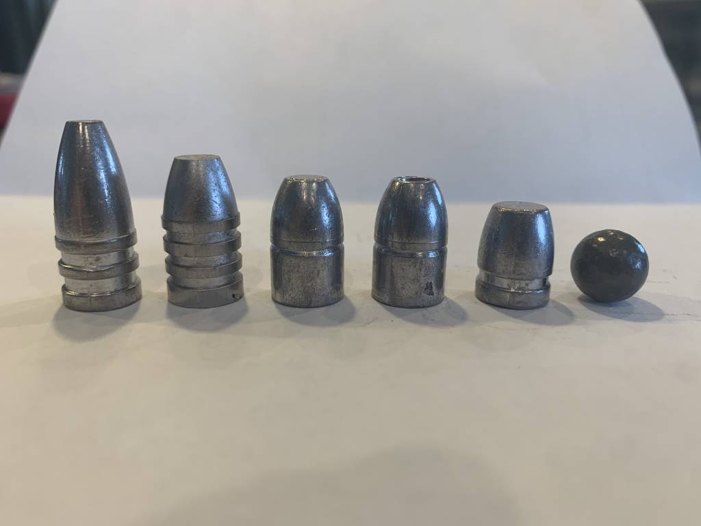

My own cast bullets. 242, 294 hp, 308, 324, 372, and 145 gr ball.
