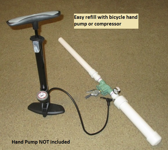

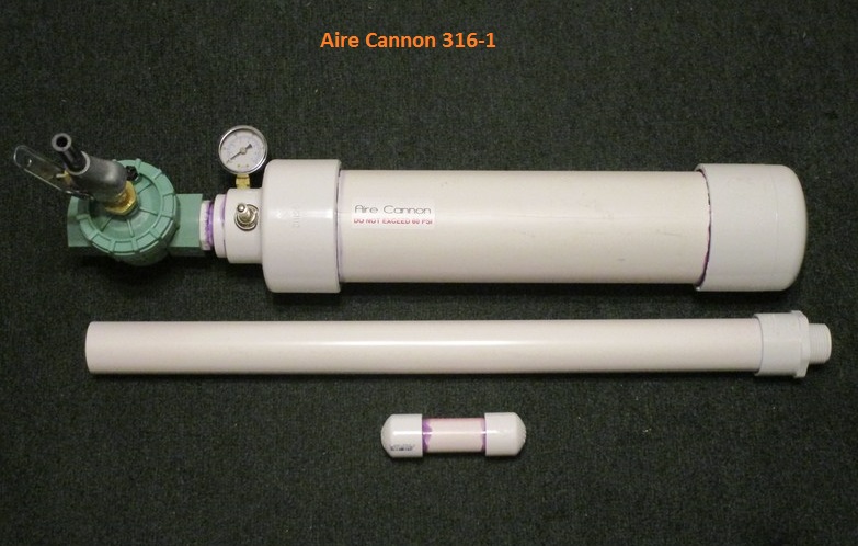

I use an Air Cannon with the "Plug" weighted with BB's. See attached photos. The Plug weighted comes in at 1-pound and depends how much air you pump into the cylinder, but it can be shot out of sight vertically. I glue on one end of the plug, fill the body with BB's, add epoxy and seal the other end with a cap. This thing is scary how powerful it can be :oops:. I have another plug that I weighted and installed an eyebolt in one end and attach a long para-cord to shoot up into a tree and then pull a rope when I am cutting the tree down.

I really LOVE that!🤗
Would be funner tham untangling my grappling hook rope when I miss a limb to tie to for felling trees😅

On a really tall tree, 75 to 100 ft, I shoot over a limb, then pull the para-cord so that I can shoot again in the opposite direction, around the tree. Use a shackle to allow the rope to be pulled tight way up in the tree. No fear of the tree falling in the wrong direction.

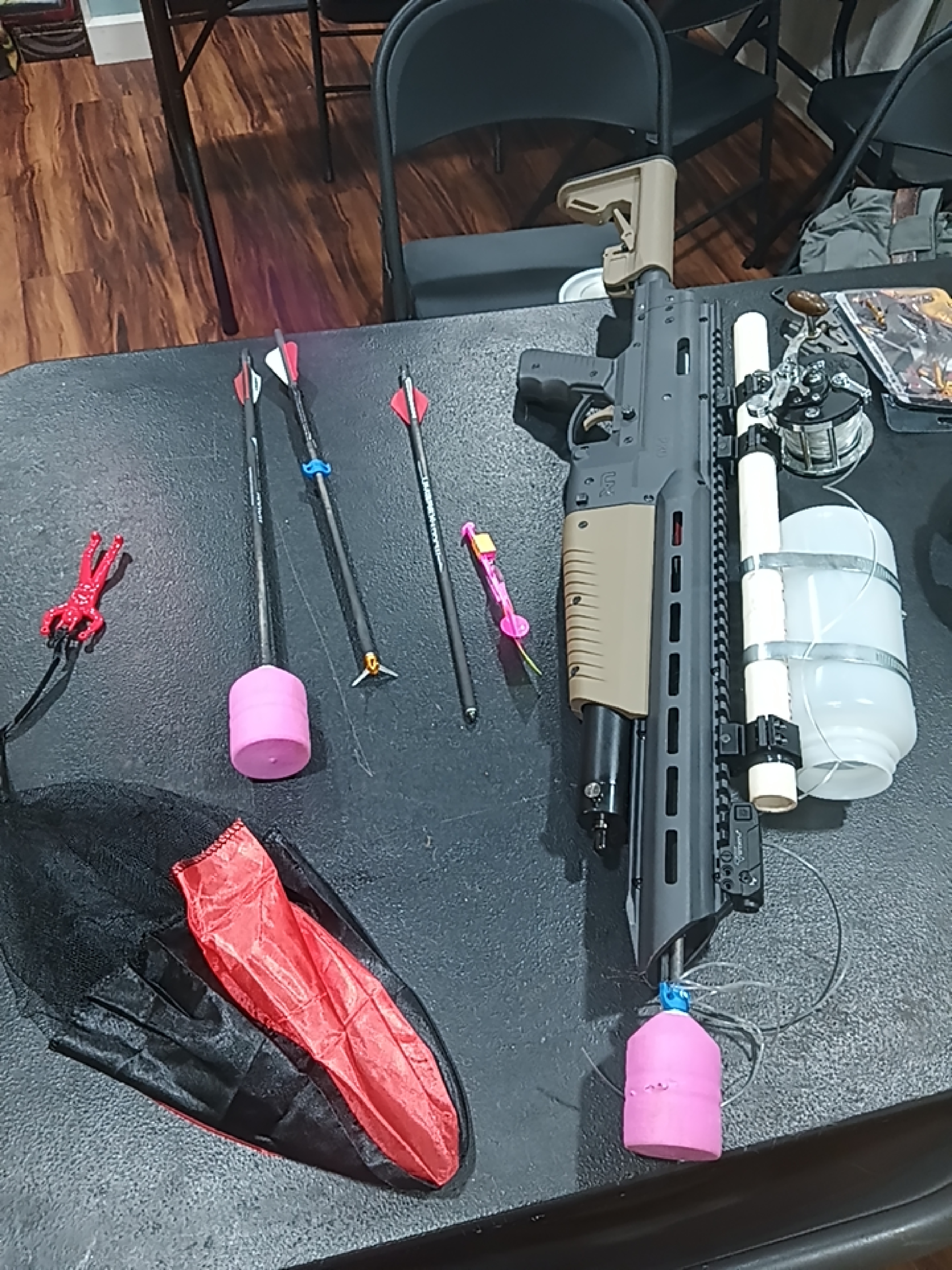

I've ended up with a PCP Air Javelin, cheap Chinese marshmallow "archery tag" tips off Amazon, AMS bowfishing slides with a wrapping of tape around the shaft to keep them from sliding into the fletchings, and a super high quality homemade arrow retrieval setup.
It can shoot tethered or untethered arrows with field points, broadheads or padded tips... Launch lines, hunt, I guess it could fish too. With a little bit of rigging it also launches little parachute dudes, great fun. I would like some kind of LED parachute flare, haven't found a good way to do that yet though.
The most versatile "gun" I own. It works great but is too loud, so I'm building a crossbow-based version when I want to be more discrete.
Reactions: JohnTaylor
If it ever gets tangled when shot I wouldnt want to be the person behind it. Or if you forget to disengage spool on reel, be a good way to get hurt really bad.
That's a danger with bowfishing in general, no?
It's always concerned me too, I have visions of the line getting wrapped around something and the arrow making a U-turn, but the safety slides seem to do their job pretty well when they pull backwards into a band of duct tape.
