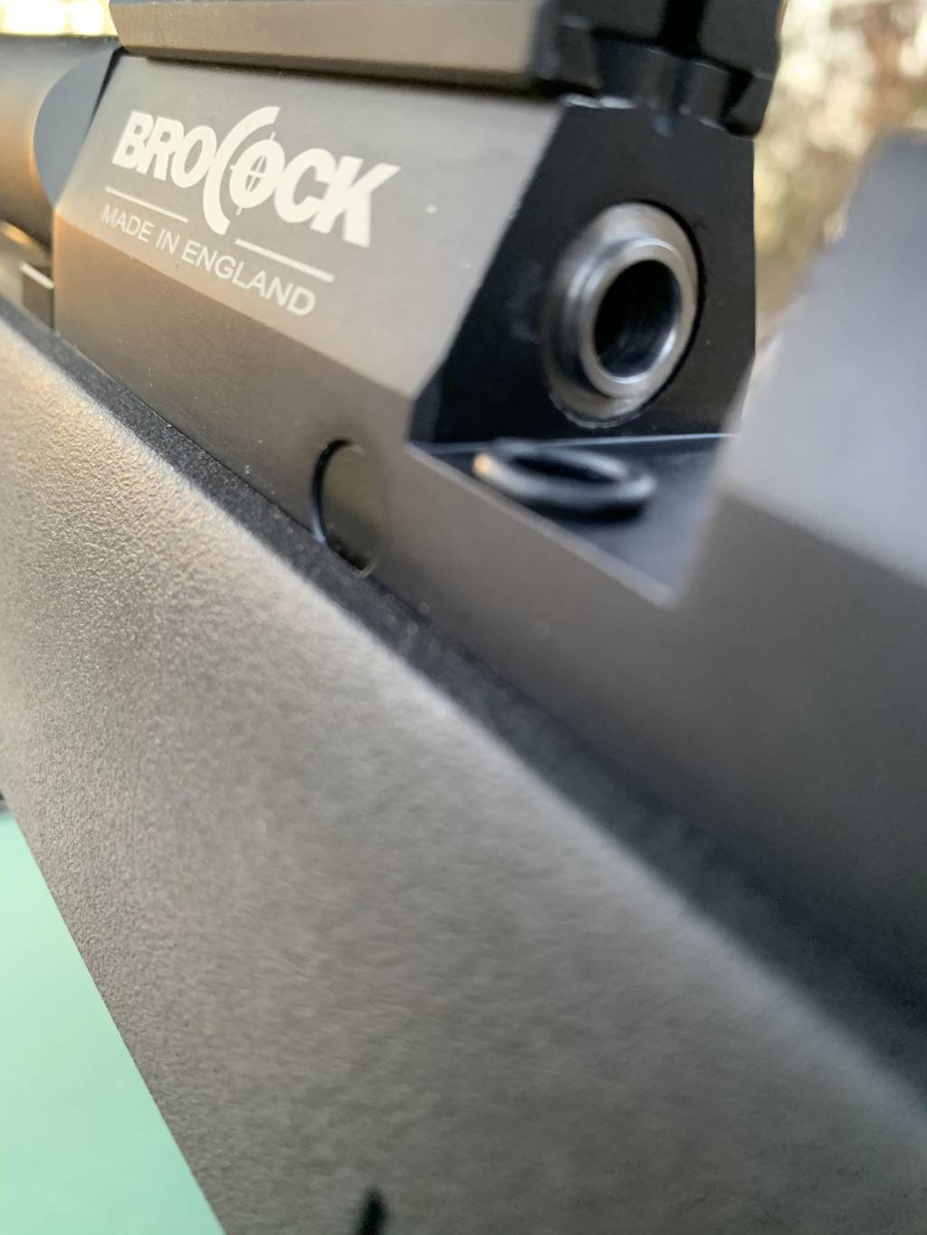

Put 120 pellets through my Bantam Sniper on a single fill. I was trying to push the bottle to see how many shots I could get on a fill and it wasn’t completely full to begin with. On my last shot I heard a moderate “pop” from the breech and the bolt was pushed half-way out.
First I thought I’d double loaded pellets. Then i realized that I pushed the rifle to the point where the pressure was too low for the regulator setting. However I wasn’t expecting the o-ring to come out. It still looks good. I may re-install it and test it to see if it will work properly. If not I have more. Is this what happens under these circumstances? If you’re familiar with regulated rifles I’d appreciate your input. Thanks y’all.

@Beezer I’m not familiar with set triggers. I’ll have to look that term up. Thankfully the tank pressure was just about as low or lower than the reg when my incident occurred. The ring landed where it is in the photo. The pellet went down range and hardly deformed as the others usually do. I think I recovered it protruding out of the cardboard behind the target when I removed them. Having a projectile blowback out towards your face is alarming. The closest I’ve seen to that is stacking so many pellets in group tight enough for lead to bounce off of lead causing some to ricochet out 10-15 yards towards me seated at 25 yards. That’s occurred several times shooting 10 shot groups.

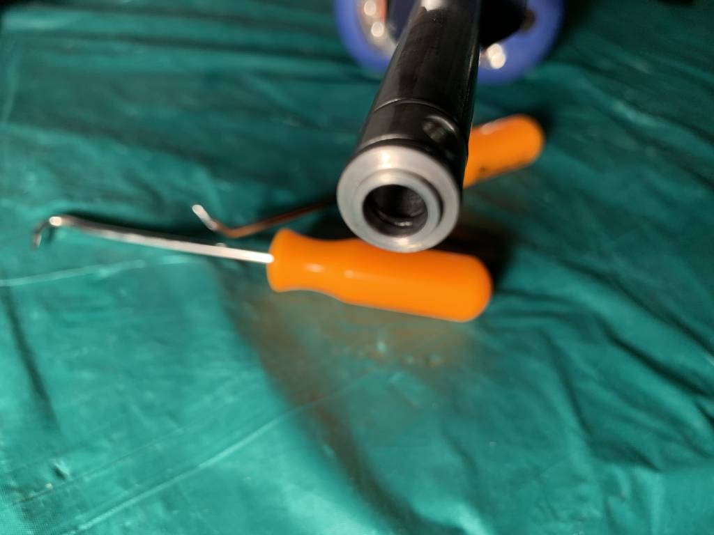

Thanks for pinpointing the issue guys. Watched this video,
https://m.youtube.com/watch?v=3AO1NZuWM_s&t=3s grabbed
then grabbed a pick set, hex wrenches, silicone oil, and gloves and reseated the o-ring. If it pops out again I have others and now that I know what to do. Took about 30 mins trying to situate the o-ring. First I pinched the ring and inserted it, next I used the tip of a pick to gently guide the o-ring into the groove.

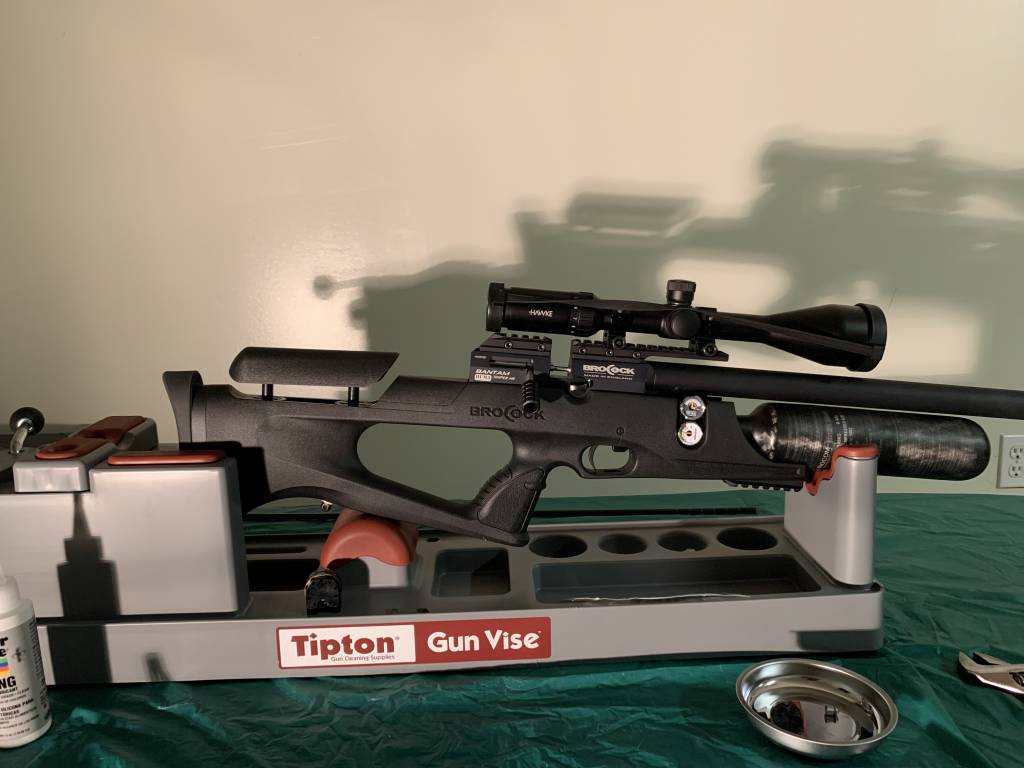

Rail and barrel put back together and it looks like I’m back in business!
I’m beginning to feel like I can confidently tackle minor fixes and maintenance on my airguns. The AGN community has been a great help. Many thanks.
