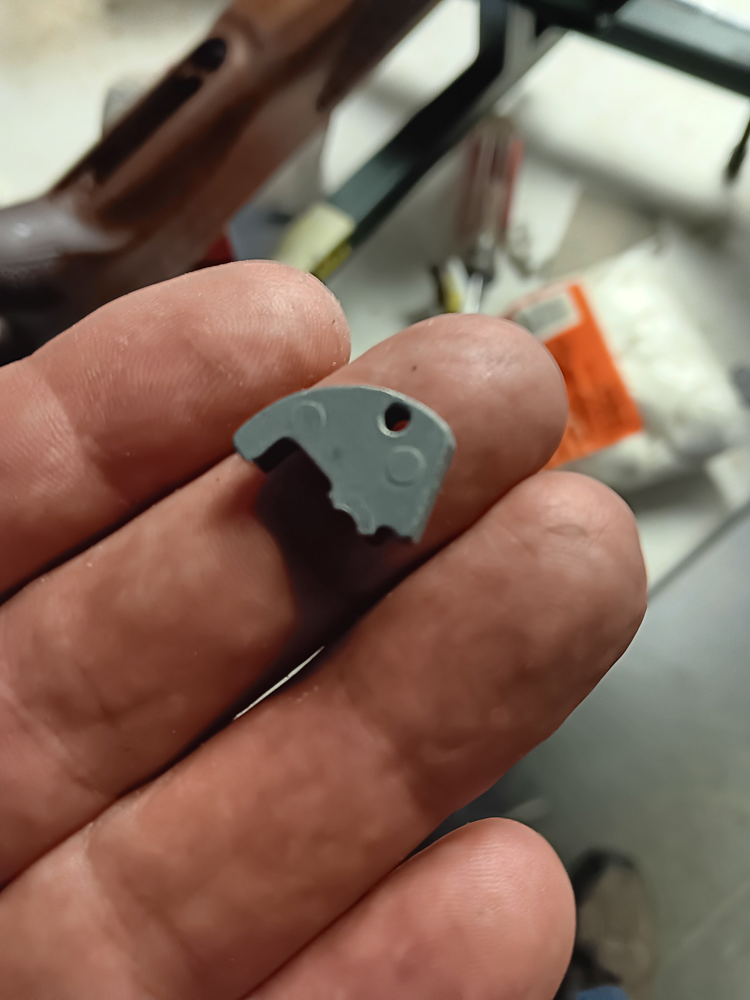

He says it is NOT THE BLADE, BUT THE “middle sear ,pat#109, I’m amazed as it looks like hardened steel.. maybe bad tempering.. my Tommy might be like yours early batch with different run. Latter maybe sketchy.. either way ,they make a good garage gun or don’t care if it gets a few dings gun.. mine is much better at 12 to 13 ft lbs in .177 than anything higher. Has a distinct metal pi sound like no other gun but has no buzz or felt vibration. I do have a longer steel guide and cup seal I made
In my experience a pre-owned Air Arms S510 Carbine and a Daystate Air Wolf and Huntsman Regal, at half price or less of new, are some of the best values I have encountered. As for "Brand New," my BSA R10 for under $900 competes with new walnut and steel rifles costing double that. I have also had great success with a pre-owned BSA Scorpion T10 and a BSA Defiant
Reactions: maxtrouble

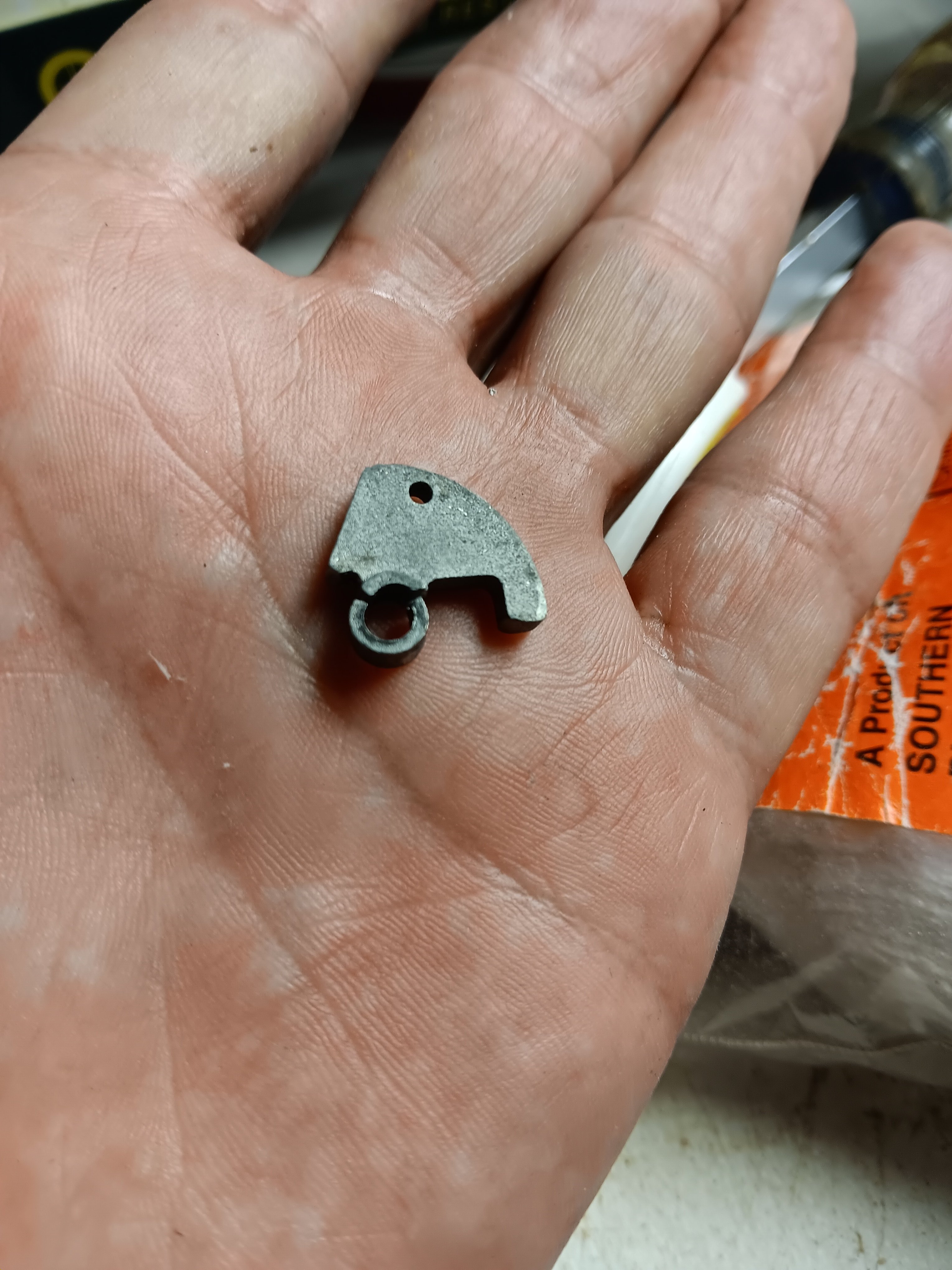

All of the parts in the trigger are die cast. Part #109 has a thin cast loop. That's what breaks off.
Here is a picture of a broken one.
It's not magnetic.

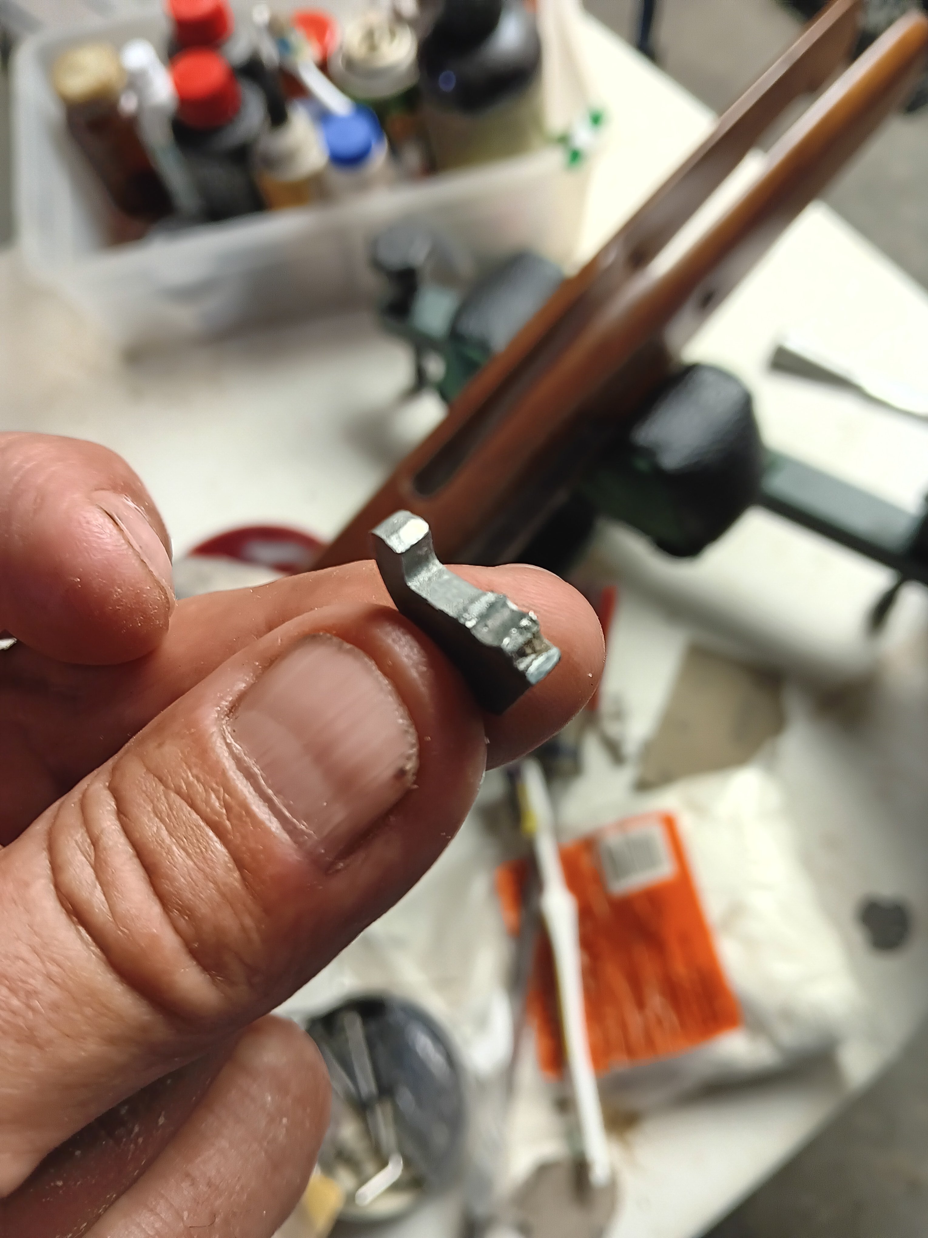

Here is a photo of the broken loop and sear surface. As you can see it's thin as hell around the pin and soft on the sear surface. All the internals are non magnetic die cast metal.
I found the broken loop in my junk box and put it back together. The complete part looks like this...

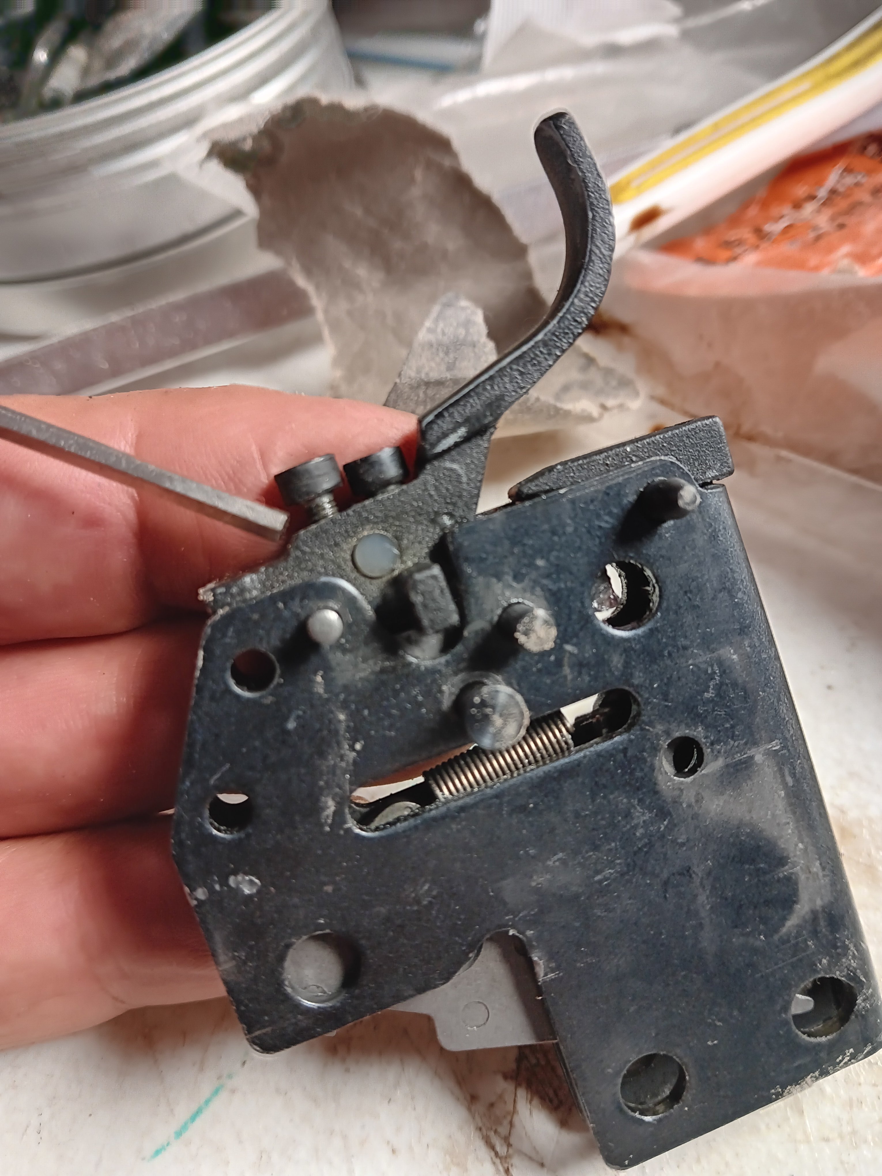

You don't need longer screws to get the Quattro to adjust. Just file down this surface so the factory screw goes down .005 further. On most of my guns only the first stage screw needs to go down. A dozen good strokes with a file and the factory screw works fine. Some of those screws have a chamfered neck. I just use a 1/4" drill bit to chamfer the threaded bore in the trigger. The original screw will be plenty long when it seats in the chamfer. No need to get longer screws and shorten them.
The Allen wrench points to the surface you need to file. The feel of the trigger is great when you take a little more first stage out. The second stage screw is meaningless unless you want to shorten travel. As long as the first stage sets the sears on the edge the second stage screw will follow nicely. I just run the second stage screw down tight and file under the first stage until the trigger is perfect. That way you can wrench them both down tight and they never move.
