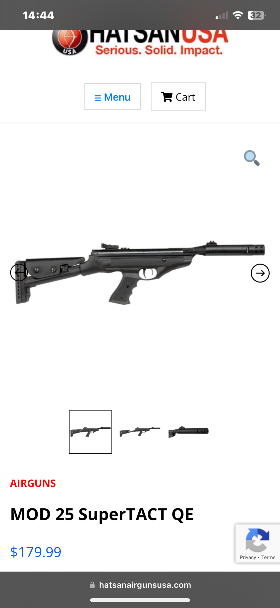

The Mod25 "Supercharger" has the same rails. The owners manual shows cocking it with one hand on the barrel and one on the grip. But I don't grab the grip, I grab out at the end of the spring tube/receiver, back behind the sights. It is rougher on the hand but that keeps it from separating at the rails.
I currently have the Mod25 and the Tact version, and have swapped springs and barrels back and forth. In all cases the Tact without the recoil rails shoots just as accurately as the Mod 25 with rails. Go figure.

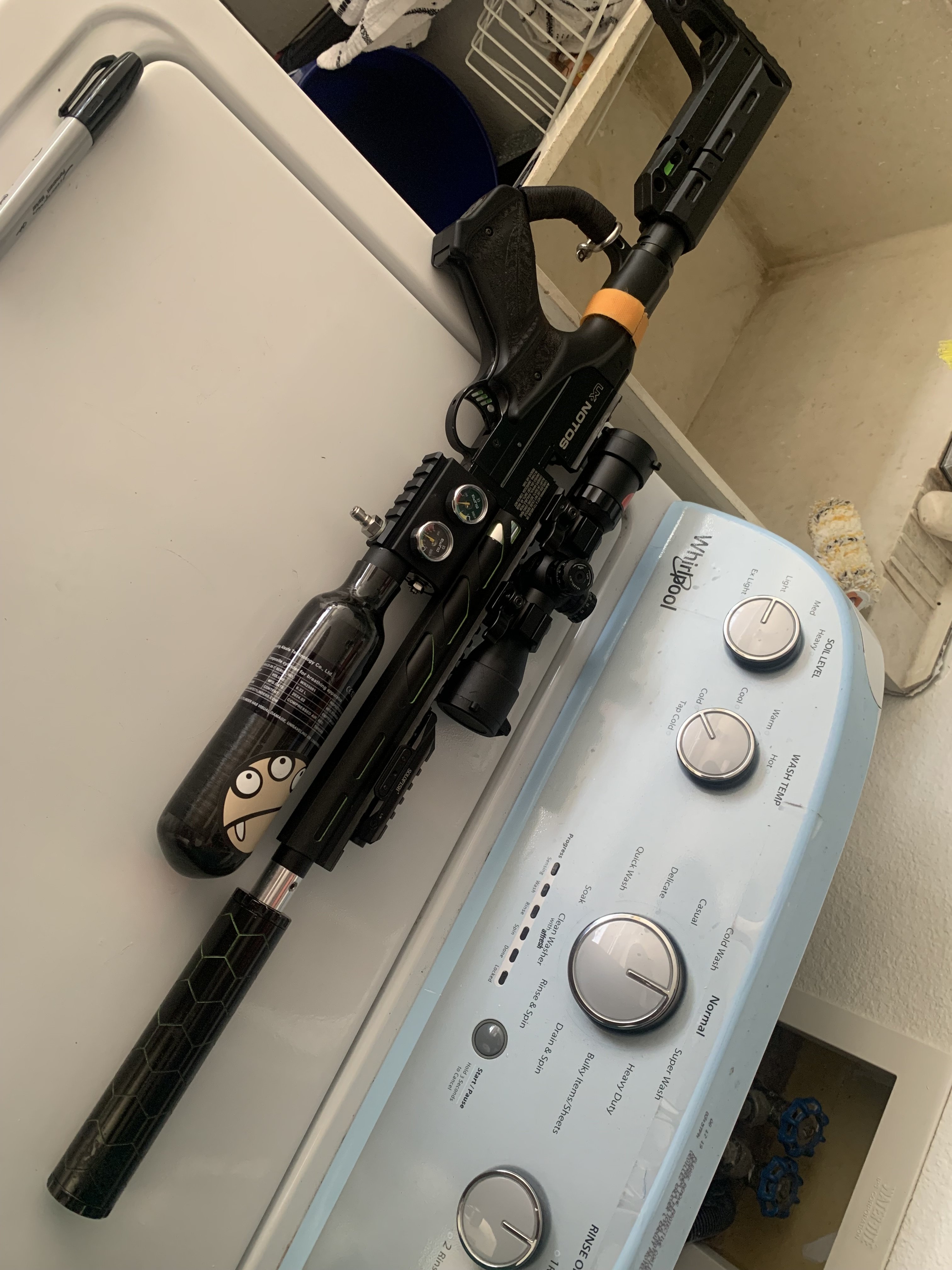

i really think a notos is unbeatable in it’s price range.
pros:
-a working moderator as advertised
-manual pump friendly
-decent shot count to power ratio
-accurate
-aftermarket mods availability
- solid internals
-adjustable stock
-easily maintainable/repairable by owner
cons:
-possible magazine problems(mostly human error)
-stiff oem hammer spring (i think done on purpose to allow for breaking in after some use)
-adjustable trigger is gritty from factory but easily fixed
-moderator must be destroyed to remove.
Reactions: nobody1
here’s my notos trying out her bottle dress. it’s nice but i personally prefer the tube.
