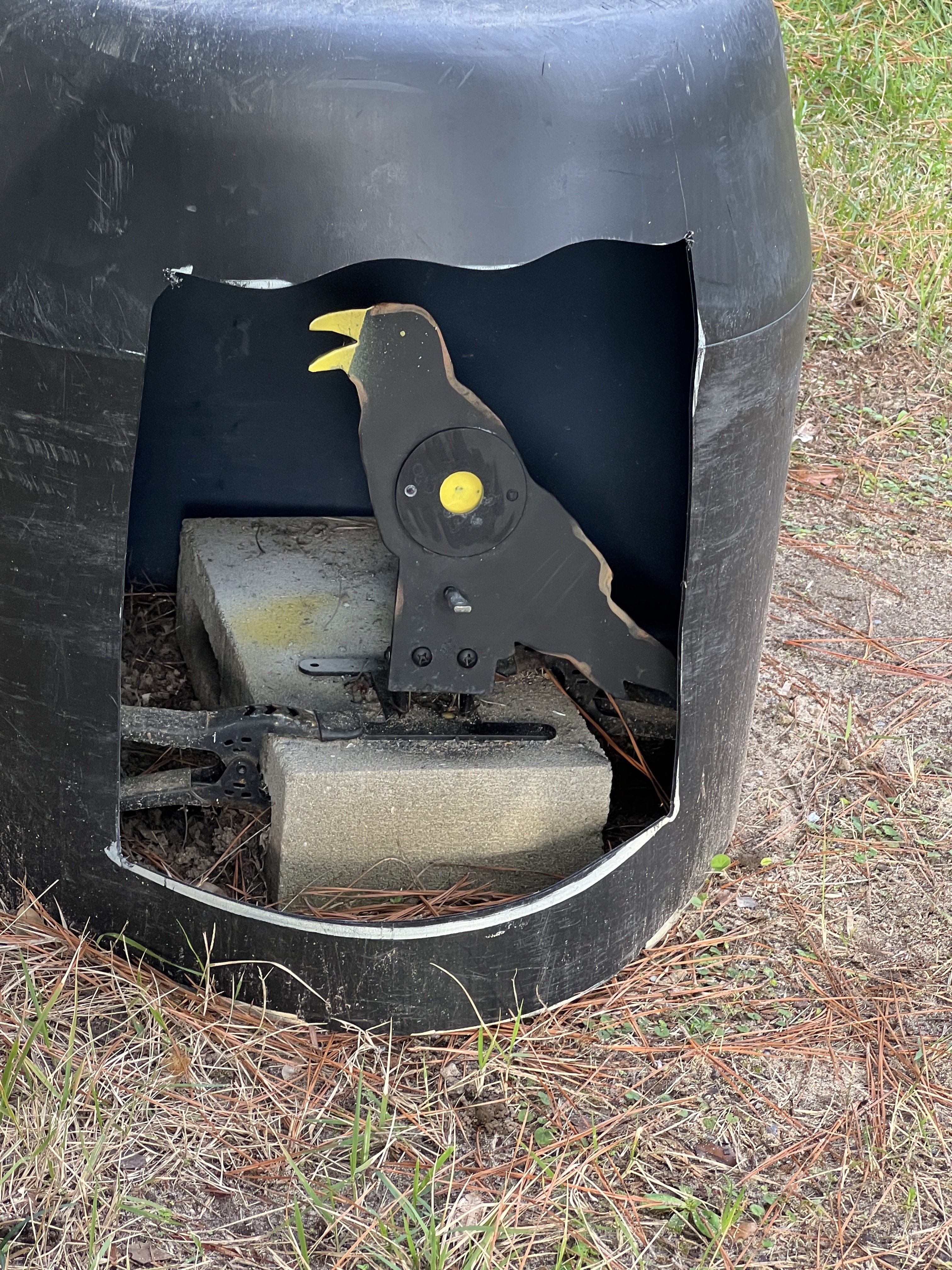

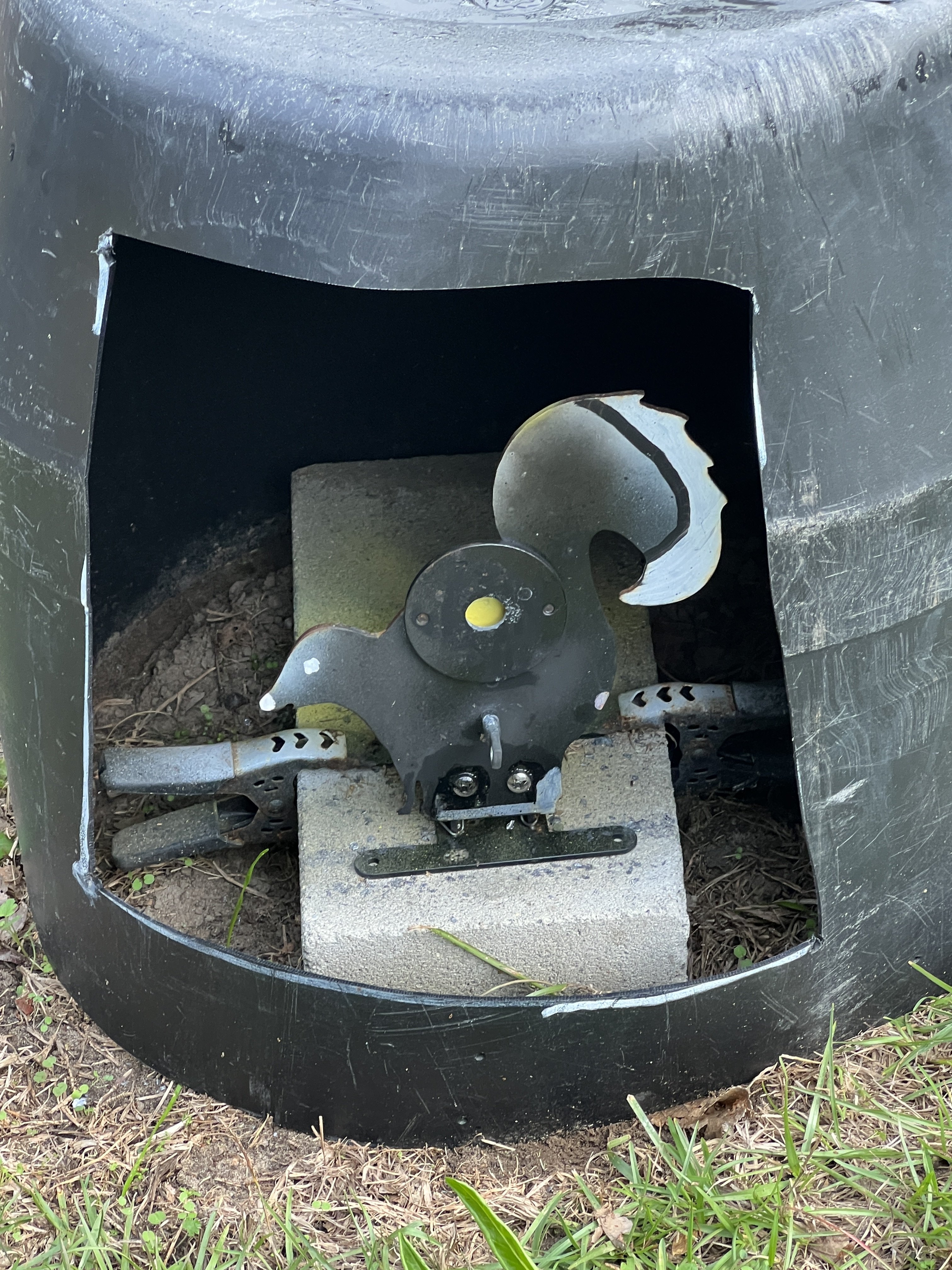

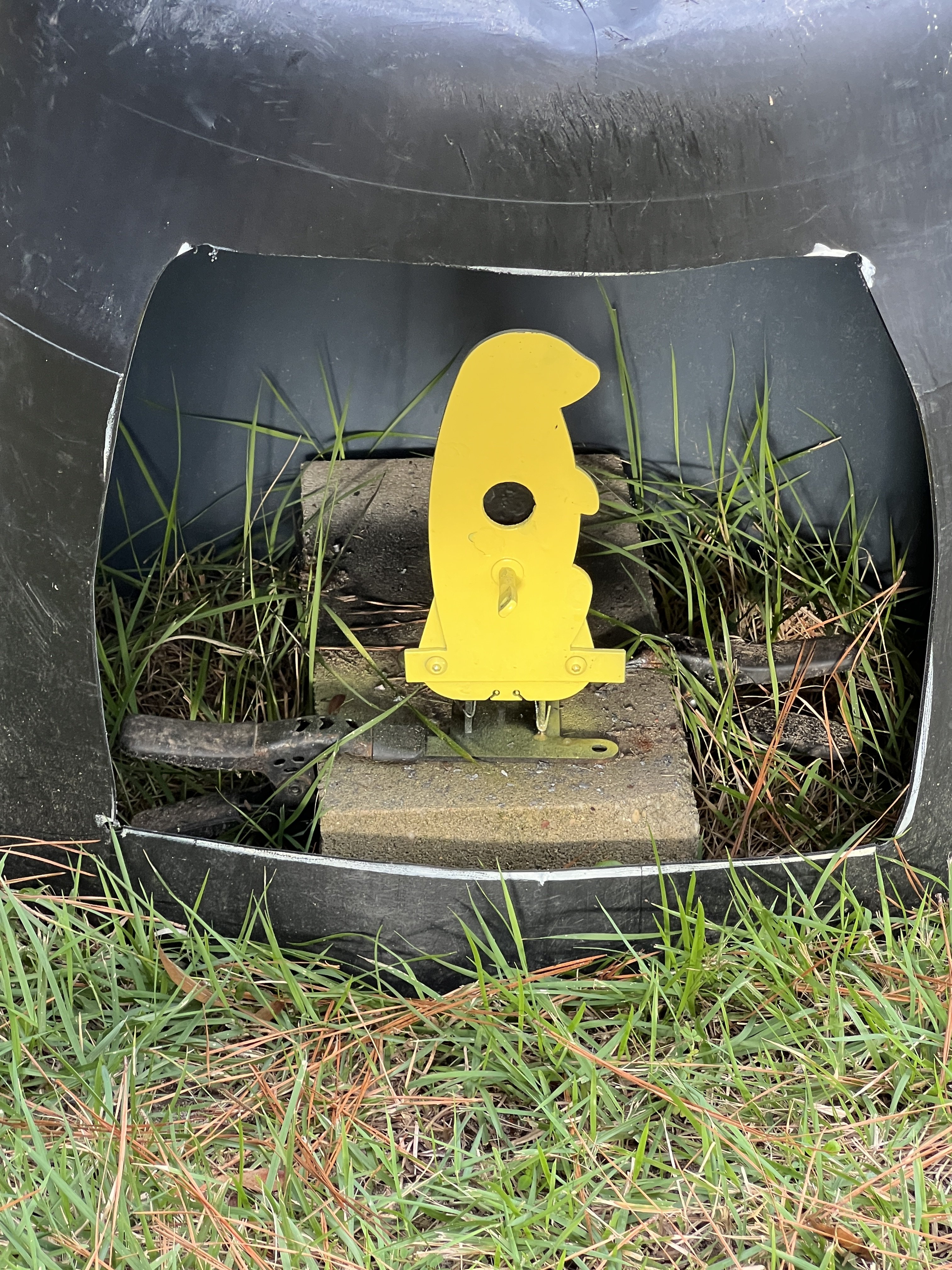

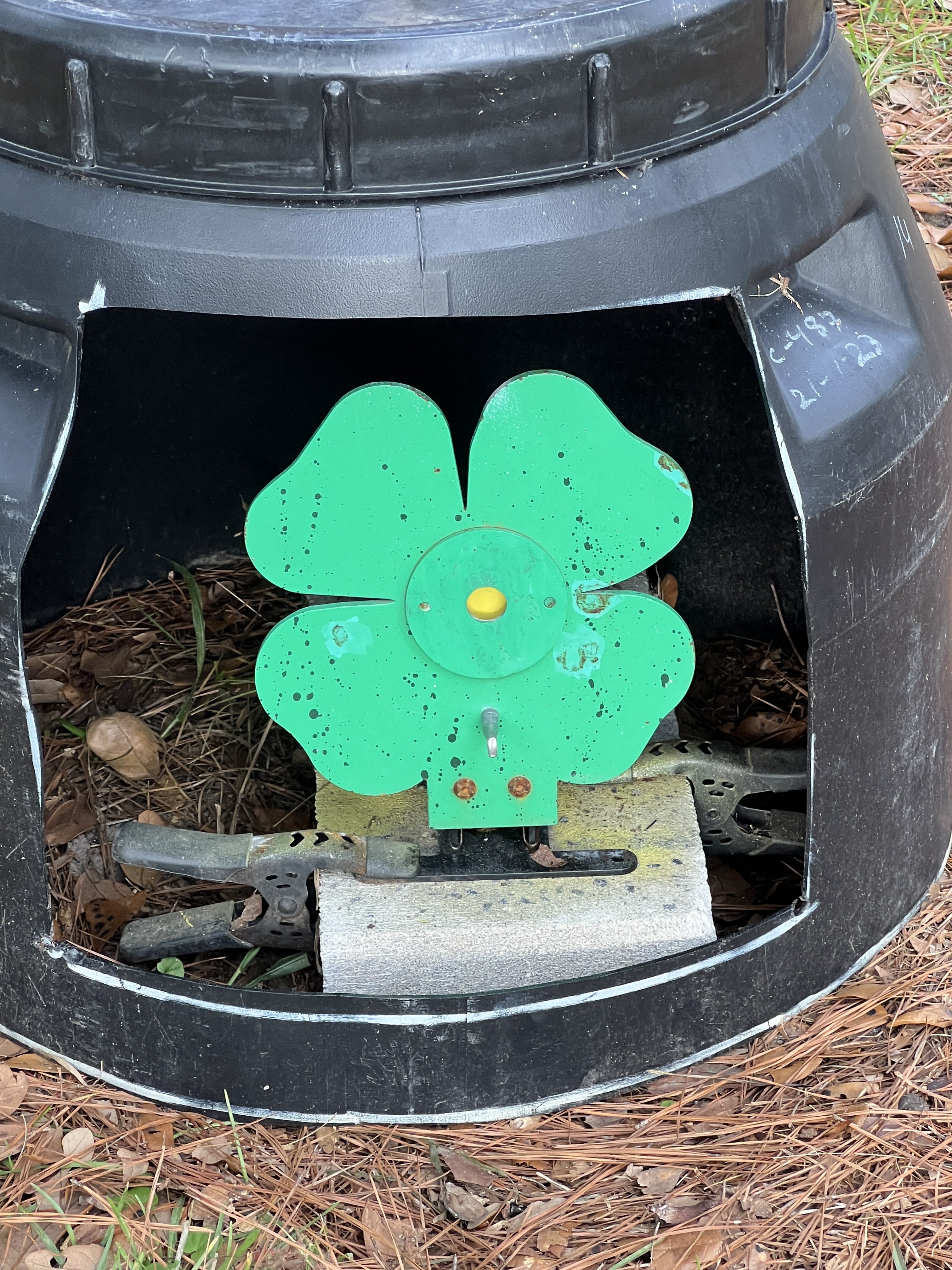

It has been 2 years since I started knocking over metal targets with tiny pellets. It never gets boring. But it can get frustrating. Frustration usually comes in two forms:
A) my inability to read the wind
B) dark colors on faceplates which obscure my ability to see a black reticle. Yes yes illuminated reticles do help.
A) is something I can’t control BUT I can learn from and improve my wind reading abilities and subsequent guesstimates.
But
B) is something WE (clubs)can all control. That said, what’s the point of painting field target faceplates with dark colors? It does nothing to improve our technical shooting skills but it definitely leads to frustration.
I’m thinking that faceplates, as a rule, should be painted white, yellow, light grey, light blue, light green, orange etc.. and the KZ’s a contrasting color.
I suspect these color combinations would speed up field target because it would be much quicker to locate and range a target. Secondly, when a target gets shot up, down line shooters will still have a reasonable chance to see and find the KZ’s.
Looking at the targets pictures below you’ll get the idea.
Also shouldn’t dark colors add to an overall Troyer rating?
What say ye?

View attachment 516545View attachment 516546View attachment 516547
I’ve been experimenting with different colors combinations and very small KZ’s. Light gray with a splatter really helps ranging.

I’m not saying that realistic paint and color schemes aren’t cool, they are. But dark brown, dark green, black colors in dark woodland lanes, slow down acquisition ? and after several shots hit a small KZ, it is indeed difficult to apply holdovers. Now if the 16X would be lifted…:: meh.

I have both FFP and SFP $$$ scopes, and a black reticle on a dark brown or dark green or black target with a leaded up KZ does nothing to improve steadiness in a marksman. IMO.

My point, Light colors on face-plates with highly contrasting KZ's, definitely helps level the playing field in HFT where the use of additional magnification isn't allowed.
