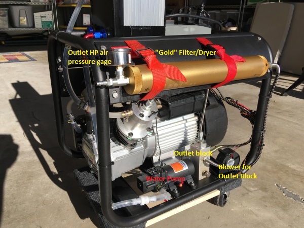

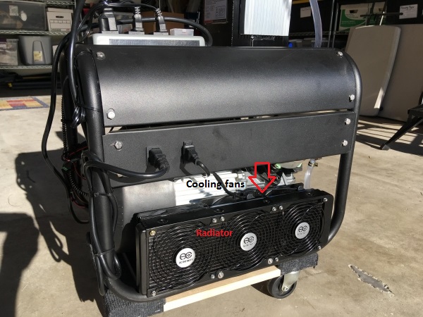

I have the two cylinder Tuxing, which I modified by adding a cooling system so its equivalent of the AV and new Hatsan. I have about 5 hours run time on it, and it tops off an 88 cubic foot tank from 3200 to 4500 psi in less than 15 minutes. Haven't had any issues with it at all, runs on 115vac, and it has the "gold" filter/dryer with Zeolite 13X molecular sieve. I changed the oil after the first hour but not since then. The Royal Purple synthetic oil is still purple in color and doesn't seem at all discolored or burnt. Overall I'm happy with the $800 I spent on this rig and its performance. Its been over six months now, lets see how it goes over the next year...
Tuxing double cylinder pcp air compressor – taking the plunge.[/QUOTE]https://www.airgunnation.com/topic/...r-taking-the-plunge/embed/#?secret=XI7z32230T
