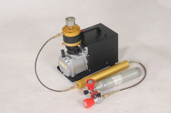

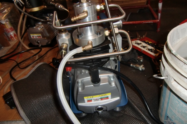

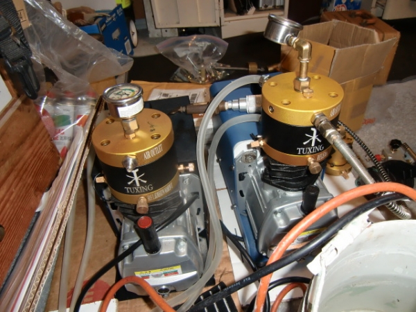

I dont no if this is aloud? every time i try to explane what im up to on the new Yellow the mods pull it down? i kinda make up my own.Their call Half Breeds.Tuxing,Yong heng,and some other knock off stuff from China.They pump their little guts out.If ya have one blown up give me a call

Have an actual pictures using that filter? As displayed in your illustration I do not think it would work at all.

It is fairly obvious from the way the gold filter is attached and the choice of words used that JoSoo is associated with a vendor in China and most likely is from there.
The Xin Yong Shi filter shown is an excellent filter. Look at the number of threads in the end caps compared to Tuxing brand gold filters. This one has holes in the end caps which make the end caps much easier to remove if a rod is used for leverage. Cut the included round tampon filters into end spacers and use another 1/2" piece as an interior spacer. Zeolite 13X desiccant and activated charcoal from any pet supply store are used to filter out moisture, odors, and impurities from the air. It is easy to roll up a clear plasitc transparency sheet to line the filter wall to protect it from the dreaded acid leeching gremlins. I posted a thread a couple of months back on how to make the liner. It is easier, cheaper, and faster to make than PVC with o-rings. It creates a tighter air and moisture seal. My experience has been that no liner is actually necessary. It is strictly a peace of mind accessory for extremely cautious users.

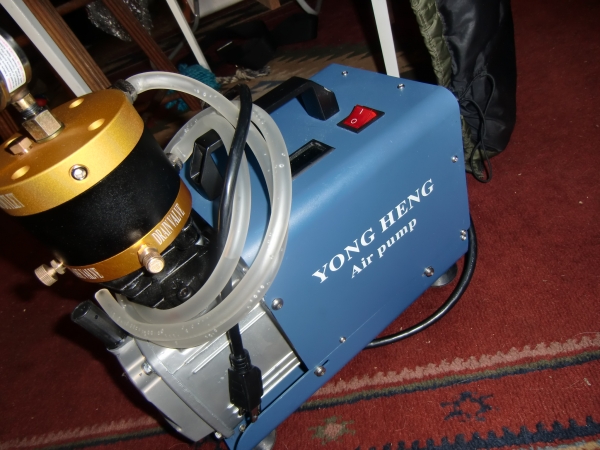

I got the Freedom 10 first and it works great, not the fastest, but had no problems filling my tank. Then the price of the Yong Heng made it too irresistible for me so I bought the 110V model with auto shut off, it fills faster than the F10, so it is the one in use now for filling my tanks. Still might get me another one that is self contained, up in the air which direction I might go for that one.

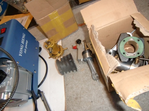

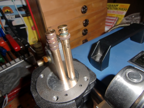

I too have the omega super charger yong heng and the Mrodair ac/dc 110/220v portable compressor. Had a problem with the Mrodair compressor while using it in the Philippines. The snap ring that keeps the piston rod on the motor shaft came off and destroyed the shaft on the end of the motor. Sent pictures to Julie at spa and she sent out a new motor rod piston. I paid for the shipping. The compressor has work fine with the replacement parts. Also had to rebuild my young heng compressor. My fault forgot to turn on the water pump and the compressor overheated. Rebuilding the young heng was easy and the parts are cheap. I don’t use my omega much unless my large scuba tank is empty then I use it for that. For the money I would buy another yong heng and the portable ac/dc compressor again over the omega
"kzz1kaw"I too have the omega super charger yong heng and the Mrodair ac/dc 110/220v portable compressor. Had a problem with the Mrodair compressor while using it in the Philippines. The snap ring that keeps the piston rod on the motor shaft came off and destroyed the shaft on the end of the motor. Sent pictures to Julie at spa and she sent out a new motor rod piston. I paid for the shipping. The compressor has work fine with the replacement parts. Also had to rebuild my young heng compressor. My fault forgot to turn on the water pump and the compressor overheated. Rebuilding the young heng was easy and the parts are cheap. I don’t use my omega much unless my large scuba tank is empty then I use it for that. For the money I would buy another yong heng and the portable ac/dc compressor again over the omega
