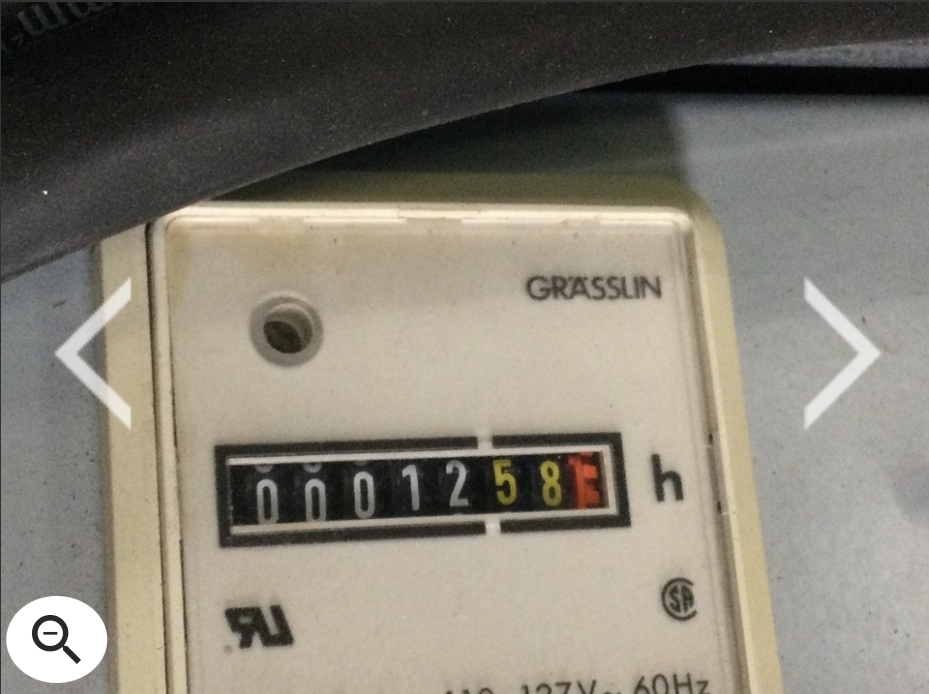

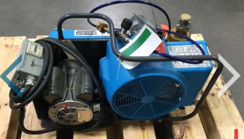

My bauer jr2 I think it was built back in 2008 or even earlier and it had less than 13 total hours when I bought it in 22.
Basically a single test hour every year. All I did was change the oil, air canister, and belt. I will have to take a look at the hours now but it think I have like 45 hours total on it now.
I probably should not have bought it if I had known about the added auction fees, taxes, or cost of transportation when I bought it but I was very lucky my unit was basically unused. When I got it home I realized it was very well kept and even had minimal dust on it. Overall it cost me the equivalent of one very expensive air gun.

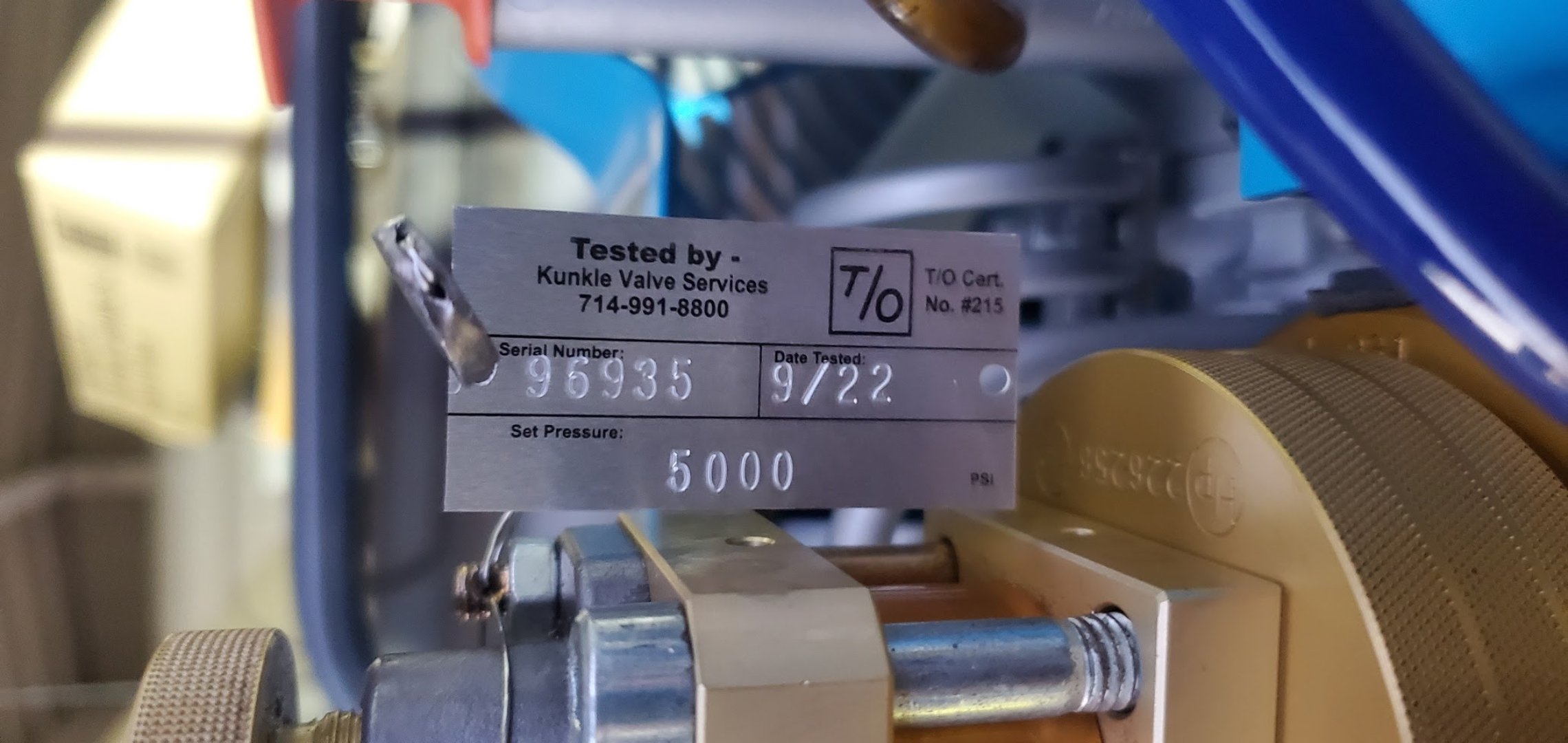

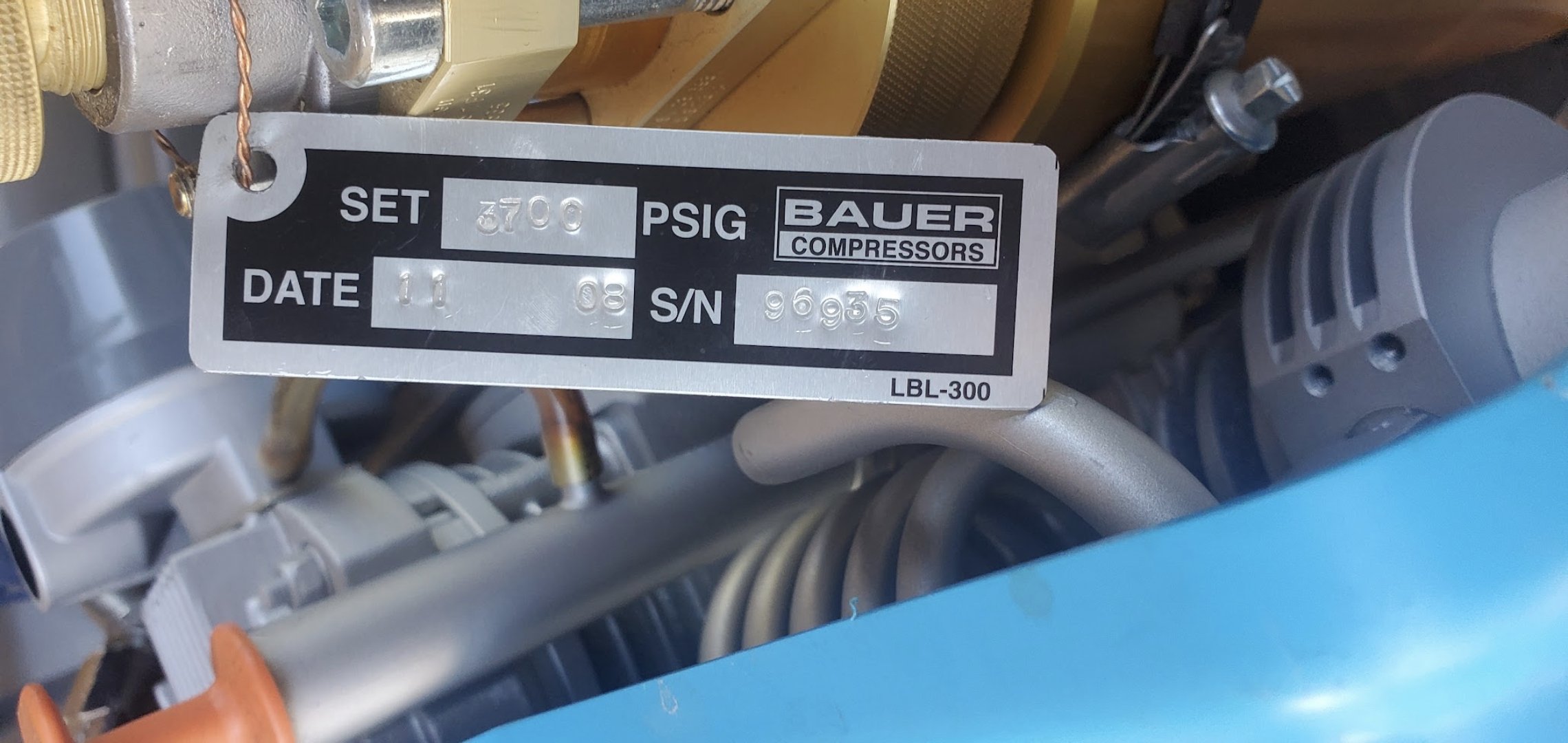

I found a couple pictures when I got it a couple years ago. The compressor was never set to a very high pressure. 255bar for it's entire life before me. It actually scared me but the Bauer repair center told me it can take 5k without any issues.
Took my original blow off, inspected it then reset the blow off at 5k for me! 😊
